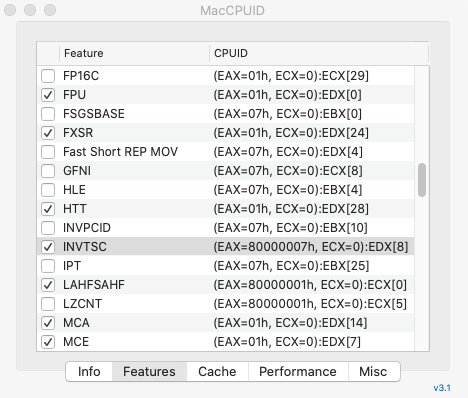

Update INVTSC is not showing up detected by the OS even tho its in my XML.... this is perhaps the problem or one of them
Same here.
EDIT: To enable it, add to qemu arg migratable=no
<qemu:arg value='host,migratable=no,+invtsc,
From qemu wiki:
New "invtsc" (Invariant TSC) CPU feature. When enabled, this will block migration and savevm, so it is not enabled by default on any CPU model. To enable invtsc, the migratable=no flag (supported only by -cpu host, by now) is required. So, invtsc is available only if using: -cpu host,migratable=no,+invtsc.
Edited by ghost82

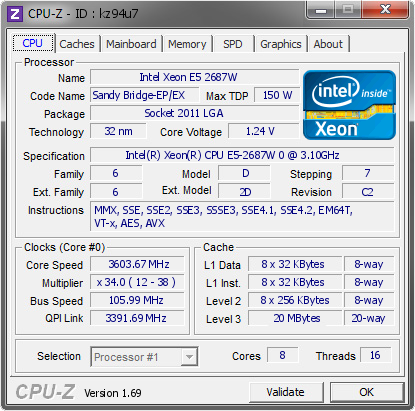

7 hours ago, tpruszin said:
Does yours show the correct Frequency for your CPU?
Yes, mine is showing correctly.
My xml config is similar to yours, with host-passthrough, exept that I'm also passing explicitly features:
<qemu:arg value='host,+hypervisor,migratable=no,-erms,+invtsc,kvm=on,+topoext,+invtsc,+avx,+aes,+xsave,+xsaveopt,+ssse3,+sse4_2,+popcnt,+arat,+pclmuldq,+pdpe1gb,+rdtscp,+vme,+umip,check'/>
You can try the following:
- if you're using clover, input the cpu data: as an example, I'm reporting the data related to E5-2687W (see also cpu-z screenshot example):
Frequency MHz: 3100
Bus Speed kHz: 105990 (mine was 100333)
QPI: 3391 (mine was 4014)
TDP: 150
These data reflect that appearing in cpu-z screenshot: in my case, when I was using clover, they were sligtly different, so it should be better to run cpu-z on your hardware and input these values.
-if you're using opencore you can try to add custom-arg busratio, in my case for E5-2687W it's busratio=31.
Also, you can add data into PlatformInfo->DataHub->ARTFrequency, FSBFrequency
Edited by ghost82

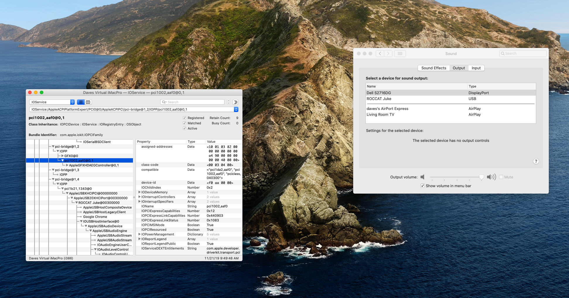

When putting my audio on the same bus as the gpu i get no volume controls from my display port and no sound, it is displayed in the sound options. Do i need AppleALC kext to get that to work, working sound from the GPU? Im using a rx 570 and i use a usb audio device for sound and it works without any issues but this would free up a usb port.

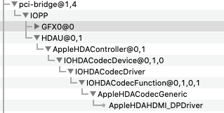

Do you have HDAU in ioreg beside the GPU?
AppleALC correctly handles the audio (including that integrated in the gpu), so I think you need it.
How do you currently manage the audio?
I use a usb audio device right now that works out the box without any kext needed. Just looking to free up a usb port. The device has worked in every Mac version i have used without issue. Audio controls work and everything.
This is what the sound out for my GPU looks like. My monitor has no speaker but has a audio out port i will try.
2064786352_ScreenShot2019-11-21at9_50_33AM.thumb.png.449c8042daf744217661805e523aa97b.png

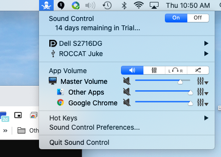

AppleALC kext fixed up the device but i get no actual sound controls so i cant change the Volume so a win and a lost.

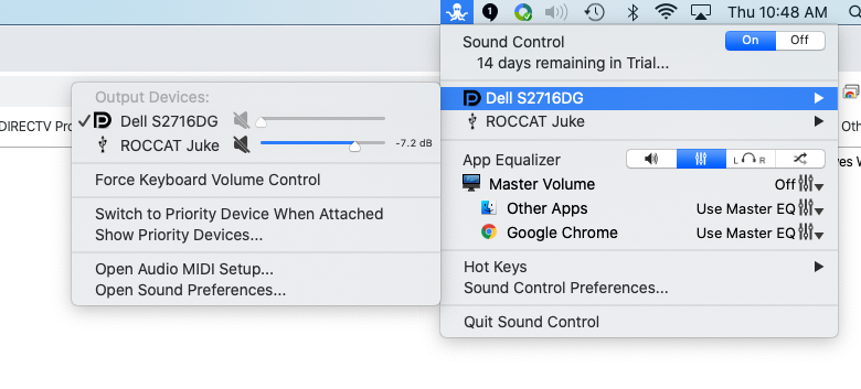

Ok downloaded a app called sound control to control the master volume of my GPU
Are you sure you can control volume for hdmi from osx?I never used it as I'm using the built in audio, but from what I can see here:
it is not possible directly...am I right?
Can I ask you if you disconnect the hdmi cable from the gpu, if you see the hdmi audio in sound preference panel?
Edited by ghost82
If i unplug the cable i lose the DP audio in the sound prefs. The app im using sound control allows me to control the volume from the DP port or the USB device. Its actually a decent app. I can still use the volume wheel on my keyboard and it looks just like the volume display like a built in device. 1854012713_ScreenShot2019-11-21at10_48_55AM.png.3d6c9330b07f9cf1727f738f07134838.png
Edited by david279
Thanks I cannot test the hdmi audio, I have not cables, and I couldn't see any hdmi audio port in the sound preference panel, so I asked.
But in ioreg everything seems ok:
HDAU is in place, and the driver is attached, so I think it's working.
I suggest to take in place the AppleALC+WEG+Lilu kexts.
