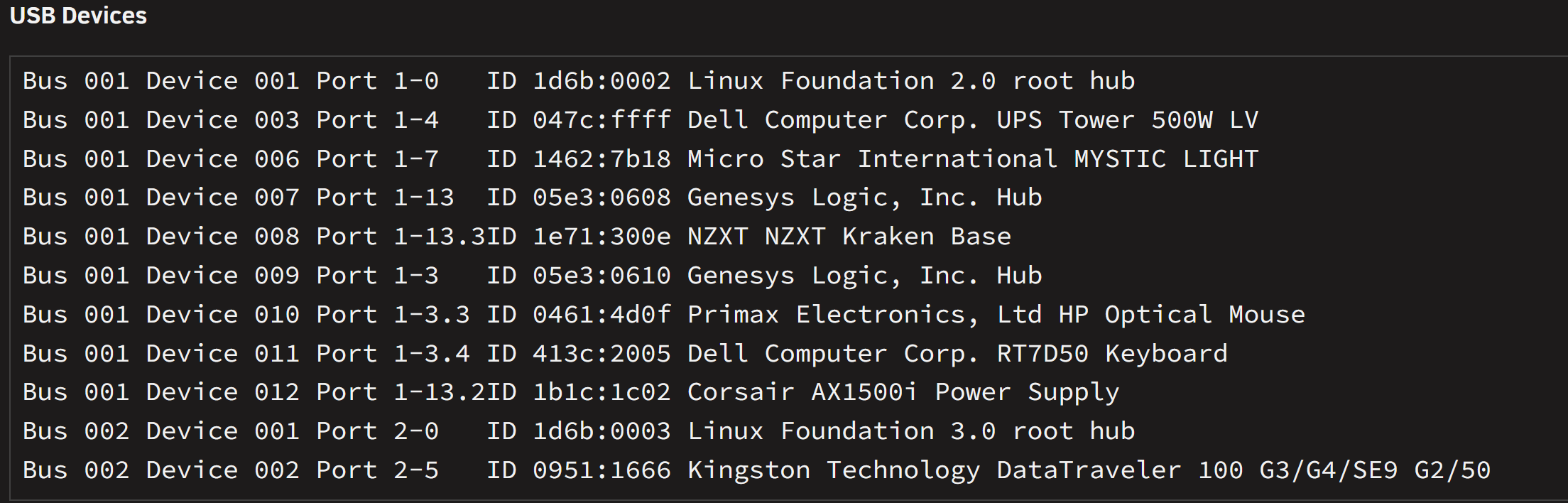

Currently having an issue getting the AX1500i to work.
I am new to this, so I am probably doing something obviously wrong or just too noob at Linux.
Looks like a new version of the HX1500i. Give me one day or so. Should work with the next release.
Negative, it is not a USB-C style connection. The power supply is fairly old by a few years. It is a AXi variant, not a HXi. Again, I am probably just doing something wrong. This is the one I have installed: https://www.corsair.com/us/en/p/psu/cp-9020057-na/ax1500i-digital-atx-power-supply-1500-watt-fully-modular-psu-cp-9020057-na?srsltid=AfmBOorbCIdJea5yegHPrYlivqc-DWxtoiI7JtFdf4fG_FCduJKC0CZe
Edited by nakutra
oh s**t.... I was not reading carefully... thats an AXi version..
Have to revert the changes on corsairmi then..
AX1500i should be working according to code. Can someone verify?

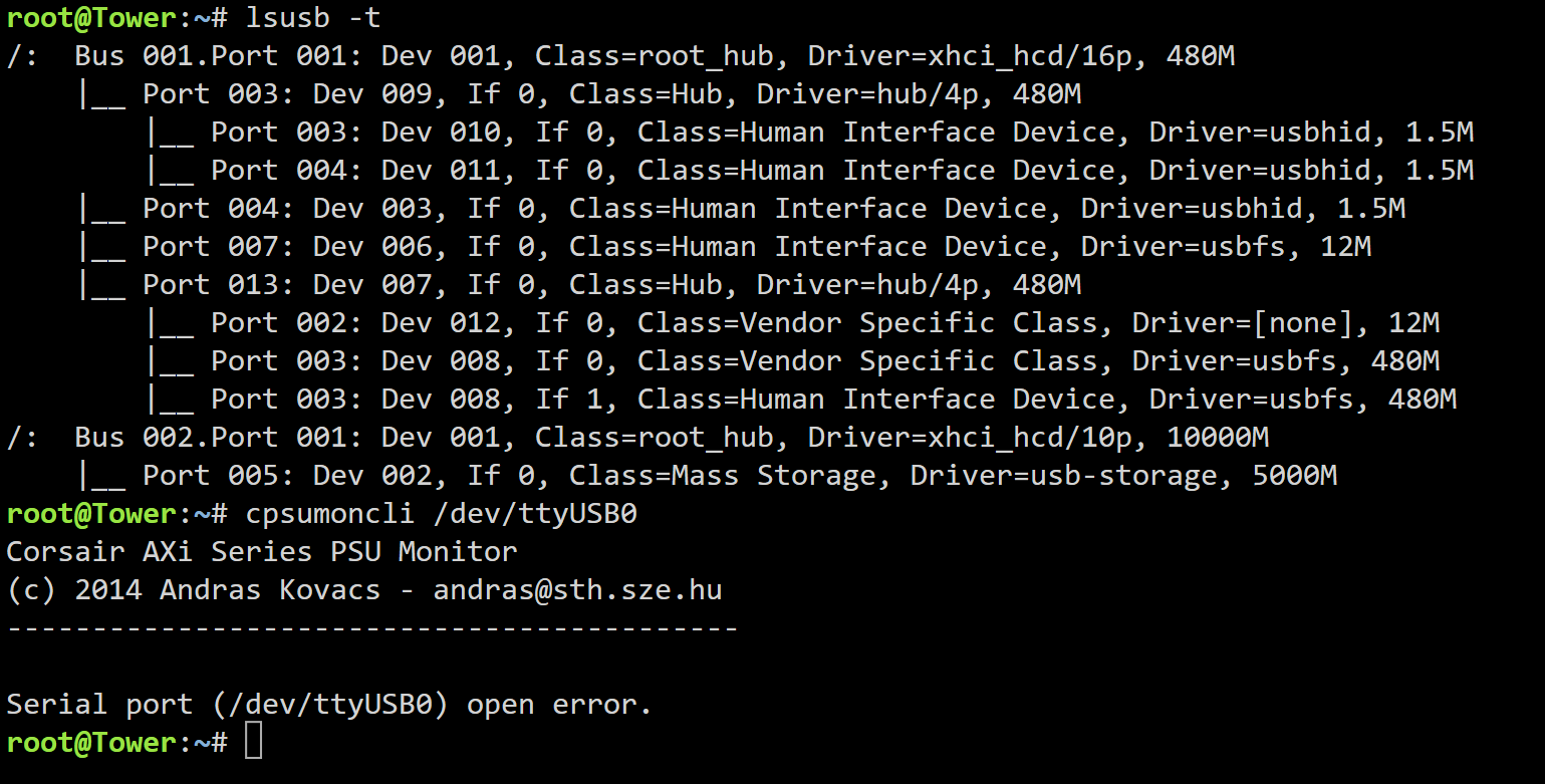

Any progress on this? I have an AX1600i and would love this for it. Thanks for all your work!
I will have to get the binary from @Bngoold . I would also like to take a look into his changes for the dashboard.
Hello everyone!
Apologies for the delay. Since my post I have been learning how to actually make a patch. I am not a coder however I have extensive AI prompt engineering experience so I essentially vibe coded to get it working at first, however, I now understand, I was making updates that were not persistent. So before releasing something into the wild not truly understanding what I've done, I've learnt and made a simple patch with backup and uninstall features built in.
Note: This will need to be reinstalled if there are any updates as I have not built an update detection mechanism and thought trying to do so would way overcomplicate things.
@giganode - If you want to please feel free to cut this up and use as you see fit for a future update. I've enjoyed this project hopefully it helps someone else.
Note: I posted this 7 hours ago and then in testing noted a persistence issue so to avoid confusion I deleted that post. I made some corrections and have tested. Appears to be working well. Feedback welcomed. I've tried to document everything, my reasoning behind each decision too. Does this work for you? What could I improve? Is my documentation ok? I was as thorough as I could be to the limits of my understanding. I love learning so please if I could have done anything better let me know. Thank you!!
