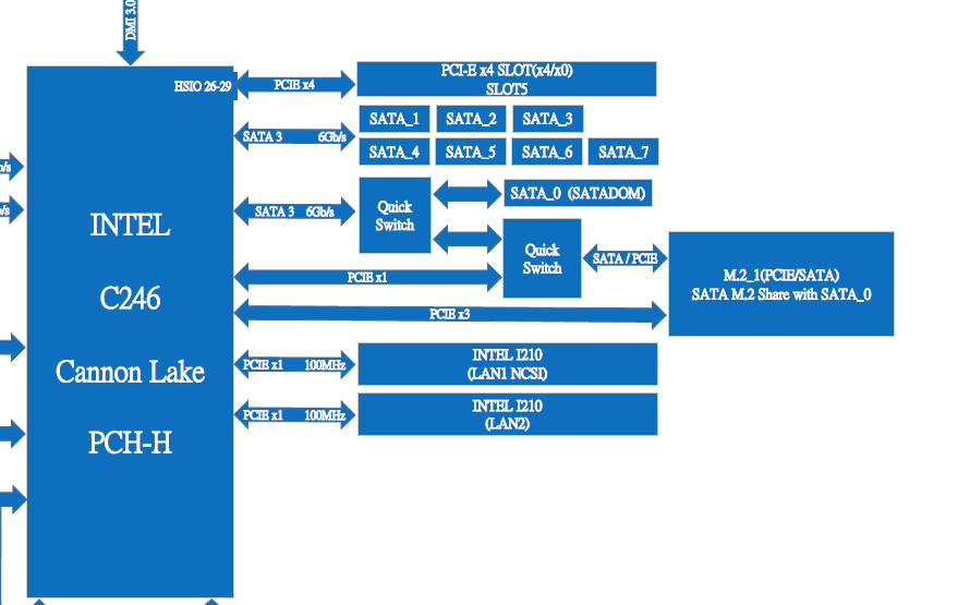

On 7/9/2020 at 2:29 PM, Burizado said:
From what I was reading in the manual it sounded like using the NVMe you would not be able to use SATA_0
This diagram in the manual seems to contradict that in the case of a PCIe NVME SSD.
Notice that the PCIe x4 slot, all SATA connectors and the M.2 slot are all controlled by the PCH.  x16 and x8 PCIe slots are directly interfaced to the CPU.
All SATA slots except SATA_0 are directly controlled by the PCH and there is no other 'switch' logic associated with them.
With the M.2 slot it says a SATA M.2 device shares SATA_0.  This diagram does not indicate that the use of a PCIe M.2 device will disable SATA_0.  In fact, it says 3 PCIe lanes go direct to the PCH and it gets another one through the Quick switch.
On the other hand, if it is a SATA M.2 device it goes through two quick switches and it appears either SATA_0 or the M.2 SATA device are supported, but not both.
That seems to contradict what it says elsewhere in the manual about SATA_0 and PCIe M.2 devices.
Unfortunately, someone is going to have to try 8 drives connected to all SATA ports (or maybe just one connected to SATA_0?) and a PCIe M.2 device to see what happens.  I think it is clear that a SATA M.2 device will disable the SATA_0 port but it is not so clear with PCIe M.2 devices.
Edited by Hoopster
