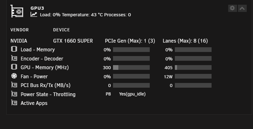

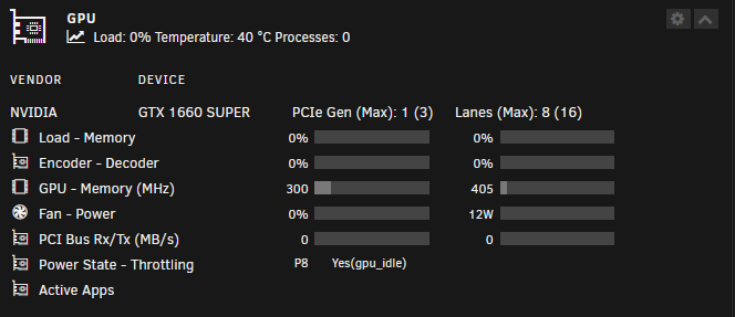

hi. after checking some videos and how to guides, i was wondering why this looks abit different than others.
is there no way to show the name of the gpu?
GPU name is taken form nvidia-smi -L can you provide your output?
Can you provide lspci also?

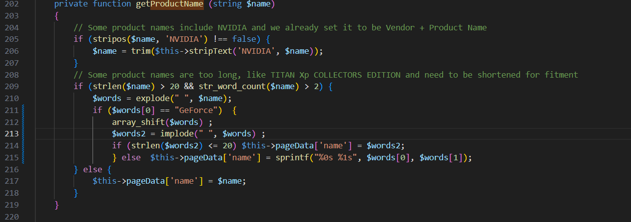

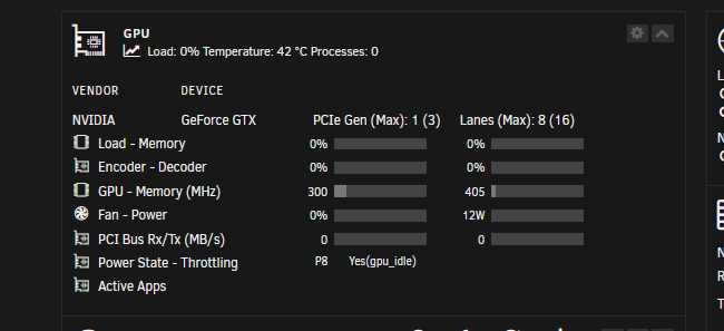

In general, no, Nvidia breaks the temperature readings with each new generation of graphics cards for older cards (even new ones aren't correctly working some times).
Depending on what card you are using (no Diagnostics, no further information provided) it is most likely the case that the temperature isn't reported from nvidia-smi

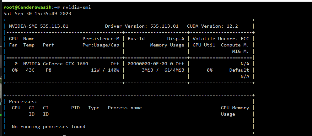

sorry about that. i'll list the diagnostics report below
root@Cenderawasih:~# nvidia-smi -L
GPU 0: NVIDIA GeForce GTX 1660 SUPER (UUID: GPU-56fa6fa4-3a8e-f2f6-d29c-18b559e4af20)
root@Cenderawasih:~# nvidia-smi -q -x -i 0

What happens when you issue:
nvidia-smi
from a Unraid terminal, do you see the temps?
nvidia-smi
i get this. yeah. i do see 43 °C there for temps.
Edited by i1mran92

2 minutes ago, i1mran92 said:
sorry forgot to add lspci earlier
root@Cenderawasih:~# lspci
00:00.0 Host bridge: Advanced Micro Devices, Inc. [AMD] Starship/Matisse Root Complex
00:00.2 IOMMU: Advanced Micro Devices, Inc. [AMD] Starship/Matisse IOMMU
00:01.0 Host bridge: Advanced Micro Devices, Inc. [AMD] Starship/Matisse PCIe Dummy Host Bridge
00:01.1 PCI bridge: Advanced Micro Devices, Inc. [AMD] Starship/Matisse GPP Bridge
00:01.2 PCI bridge: Advanced Micro Devices, Inc. [AMD] Starship/Matisse GPP Bridge
00:02.0 Host bridge: Advanced Micro Devices, Inc. [AMD] Starship/Matisse PCIe Dummy Host Bridge
00:03.0 Host bridge: Advanced Micro Devices, Inc. [AMD] Starship/Matisse PCIe Dummy Host Bridge
00:03.1 PCI bridge: Advanced Micro Devices, Inc. [AMD] Starship/Matisse GPP Bridge
00:03.2 PCI bridge: Advanced Micro Devices, Inc. [AMD] Starship/Matisse GPP Bridge
00:04.0 Host bridge: Advanced Micro Devices, Inc. [AMD] Starship/Matisse PCIe Dummy Host Bridge
00:05.0 Host bridge: Advanced Micro Devices, Inc. [AMD] Starship/Matisse PCIe Dummy Host Bridge
00:07.0 Host bridge: Advanced Micro Devices, Inc. [AMD] Starship/Matisse PCIe Dummy Host Bridge
00:07.1 PCI bridge: Advanced Micro Devices, Inc. [AMD] Starship/Matisse Internal PCIe GPP Bridge 0 to bus[E:B]
00:08.0 Host bridge: Advanced Micro Devices, Inc. [AMD] Starship/Matisse PCIe Dummy Host Bridge
00:08.1 PCI bridge: Advanced Micro Devices, Inc. [AMD] Starship/Matisse Internal PCIe GPP Bridge 0 to bus[E:B]
00:14.0 SMBus: Advanced Micro Devices, Inc. [AMD] FCH SMBus Controller (rev 61)
00:14.3 ISA bridge: Advanced Micro Devices, Inc. [AMD] FCH LPC Bridge (rev 51)
00:18.0 Host bridge: Advanced Micro Devices, Inc. [AMD] Matisse/Vermeer Data Fabric: Device 18h; Function 0
00:18.1 Host bridge: Advanced Micro Devices, Inc. [AMD] Matisse/Vermeer Data Fabric: Device 18h; Function 1
00:18.2 Host bridge: Advanced Micro Devices, Inc. [AMD] Matisse/Vermeer Data Fabric: Device 18h; Function 2
00:18.3 Host bridge: Advanced Micro Devices, Inc. [AMD] Matisse/Vermeer Data Fabric: Device 18h; Function 3
00:18.4 Host bridge: Advanced Micro Devices, Inc. [AMD] Matisse/Vermeer Data Fabric: Device 18h; Function 4
00:18.5 Host bridge: Advanced Micro Devices, Inc. [AMD] Matisse/Vermeer Data Fabric: Device 18h; Function 5
00:18.6 Host bridge: Advanced Micro Devices, Inc. [AMD] Matisse/Vermeer Data Fabric: Device 18h; Function 6
00:18.7 Host bridge: Advanced Micro Devices, Inc. [AMD] Matisse/Vermeer Data Fabric: Device 18h; Function 7
01:00.0 Non-Volatile memory controller: Samsung Electronics Co Ltd NVMe SSD Controller SM981/PM981/PM983
02:00.0 PCI bridge: Advanced Micro Devices, Inc. [AMD] Matisse Switch Upstream
03:00.0 PCI bridge: Advanced Micro Devices, Inc. [AMD] Matisse PCIe GPP Bridge
03:01.0 PCI bridge: Advanced Micro Devices, Inc. [AMD] Matisse PCIe GPP Bridge
03:02.0 PCI bridge: Advanced Micro Devices, Inc. [AMD] Matisse PCIe GPP Bridge
03:03.0 PCI bridge: Advanced Micro Devices, Inc. [AMD] Matisse PCIe GPP Bridge
03:04.0 PCI bridge: Advanced Micro Devices, Inc. [AMD] Matisse PCIe GPP Bridge
03:05.0 PCI bridge: Advanced Micro Devices, Inc. [AMD] Matisse PCIe GPP Bridge
03:08.0 PCI bridge: Advanced Micro Devices, Inc. [AMD] Matisse PCIe GPP Bridge
03:09.0 PCI bridge: Advanced Micro Devices, Inc. [AMD] Matisse PCIe GPP Bridge
03:0a.0 PCI bridge: Advanced Micro Devices, Inc. [AMD] Matisse PCIe GPP Bridge
04:00.0 Non-Volatile memory controller: Samsung Electronics Co Ltd NVMe SSD Controller SM981/PM981/PM983
05:00.0 Non-Volatile memory controller: Samsung Electronics Co Ltd NVMe SSD Controller SM981/PM981/PM983
06:00.0 Serial Attached SCSI controller: Broadcom / LSI SAS2308 PCI-Express Fusion-MPT SAS-2 (rev 05)
07:00.0 Network controller: Intel Corporation Wi-Fi 6 AX200 (rev 1a)
08:00.0 Ethernet controller: Intel Corporation I211 Gigabit Network Connection (rev 03)
09:00.0 Ethernet controller: Realtek Semiconductor Co., Ltd. RTL8125 2.5GbE Controller (rev 01)
0a:00.0 Non-Essential Instrumentation [1300]: Advanced Micro Devices, Inc. [AMD] Starship/Matisse Reserved SPP
0a:00.1 USB controller: Advanced Micro Devices, Inc. [AMD] Matisse USB 3.0 Host Controller
0a:00.3 USB controller: Advanced Micro Devices, Inc. [AMD] Matisse USB 3.0 Host Controller
0b:00.0 SATA controller: Advanced Micro Devices, Inc. [AMD] FCH SATA Controller [AHCI mode] (rev 51)
0c:00.0 SATA controller: Advanced Micro Devices, Inc. [AMD] FCH SATA Controller [AHCI mode] (rev 51)
0d:00.0 VGA compatible controller: Advanced Micro Devices, Inc. [AMD/ATI] Ellesmere [Radeon RX 470/480/570/570X/580/580X/590] (rev e1)
0d:00.1 Audio device: Advanced Micro Devices, Inc. [AMD/ATI] Ellesmere HDMI Audio [Radeon RX 470/480 / 570/580/590]
0e:00.0 VGA compatible controller: NVIDIA Corporation TU116 [GeForce GTX 1660 SUPER] (rev a1)
0e:00.1 Audio device: NVIDIA Corporation TU116 High Definition Audio Controller (rev a1)
0e:00.2 USB controller: NVIDIA Corporation TU116 USB 3.1 Host Controller (rev a1)
0e:00.3 Serial bus controller: NVIDIA Corporation TU116 USB Type-C UCSI Controller (rev a1)
0f:00.0 Non-Essential Instrumentation [1300]: Advanced Micro Devices, Inc. [AMD] Starship/Matisse PCIe Dummy Function
10:00.0 Non-Essential Instrumentation [1300]: Advanced Micro Devices, Inc. [AMD] Starship/Matisse Reserved SPP
10:00.1 Encryption controller: Advanced Micro Devices, Inc. [AMD] Starship/Matisse Cryptographic Coprocessor PSPCPP
10:00.3 USB controller: Advanced Micro Devices, Inc. [AMD] Matisse USB 3.0 Host Controller
10:00.4 Audio device: Advanced Micro Devices, Inc. [AMD] Starship/Matisse HD Audio Controller
Thanks, sorry should have asked, there is a gpujson file in /tmp could you send that also.
like this?
Code logic is as follows if string is > 20 chars which yours is. I have added a line to remove GeForce if that is the first word.
This would result in the following:
you could test on your system by editting /usr/local/emhttp/plugins/gpustat/lib/Nvidia.php as below for the name function.
i tried followed the code.
still getting same output. should i reboot?
this is correct?
   private function getProductName (string $name)
        // Some product names include NVIDIA and we already set it to be Vendor + Product Name
        if (stripos($name, 'NVIDIA') !== false) {
            $name = trim($this->stripText('NVIDIA', $name));
        // Some product names are too long, like TITAN Xp COLLECTORS EDITION and need to be shortened for fitment
        if (strlen($name) > 20 && str_word_count($name) > 2) {
            $words = explode(" ", $name);
            if ($words[0] == "Geforce") {
            	array_shift($words) ;
            	$words2 = implode(" ", $words) ;
            	if (strlen($words2) <= 20) $this->pageData['name'] = $words2;
           } else $this->pageData['name'] = sprintf("%0s %1s", $words[0], $words[1]);
        } else {
            $this->pageData['name'] = $name;
Edited by i1mran92

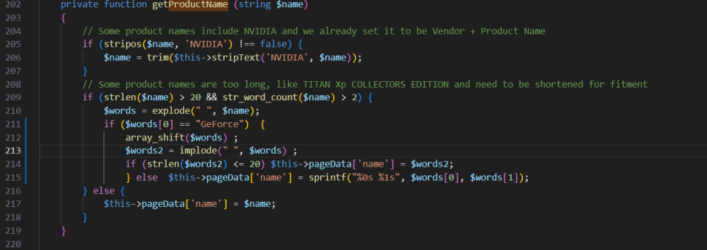

nevermind. i got it working haha. the geforce string was wrong. mine was "Geforce" instead of "GeForce"
dumb mistake.
though if i reboot the code will reset correct?
dumb mistake.
 Yes reboot will reset, but should release version update next week.
