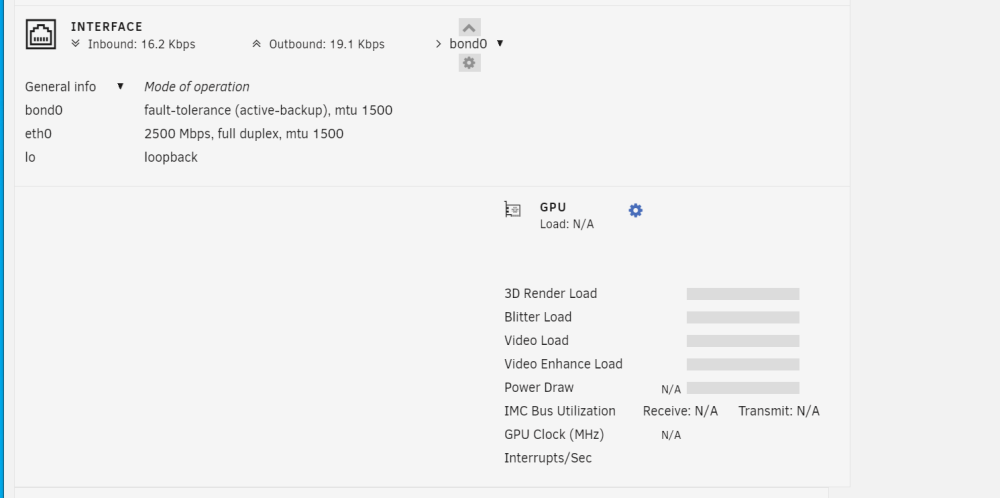

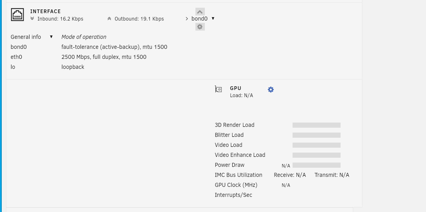

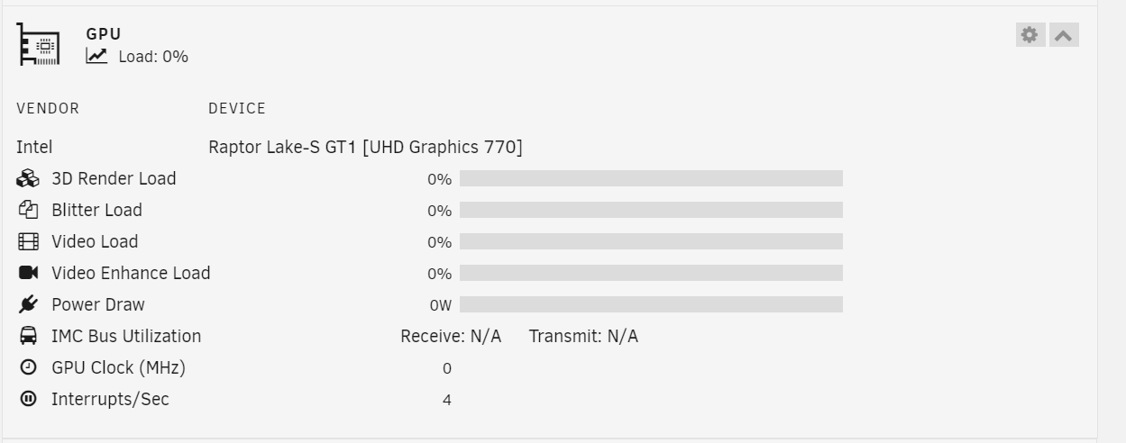

2 hours ago, A05csta said:
is there supposed to be any power draw?  I swear this used to some something other than 0w.
Your iGPU is barely used in this screenshot and you won‘t see any power draw unless it is used more.
