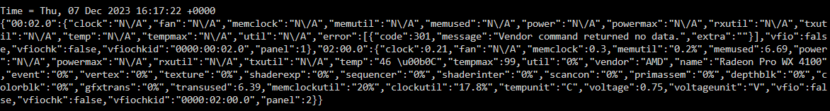

cat /tmp/gpujson
Time = Wed, 06 Dec 2023 19:16:50 +0000
{"00:02.0":{"clock":"N\/A","fan":"N\/A","memclock":"N\/A","memutil":"N\/A","memused":"N\/A","power":"N\/A","powermax":"N\/A","rxutil":"N\/A","txutil":"N\/A","temp":"N\/A","tempmax":"N\/A","util":"N\/A","error":[{"code":301,"message":"Vendor command returned no data.","extra":""}],"vfio":false,"vfiochk":false,"vfiochkid":"0000:00:02.0","panel":1},"02:00.0":{"clock":0.21,"fan":"N\/A","memclock":0.3,"memutil":"0.1%","memused":5.69,"power":"N\/A","powermax":"N\/A","rxutil":"N\/A","txutil":"N\/A","temp":"32 \u00b0C","tempmax":99,"util":"0%","vendor":"AMD","name":"Radeon Pro WX 4100","event":"0%","vertex":"0%","texture":"0%","shaderexp":"0%","sequencer":"0%","shaderinter":"0%","scancon":"0%","primassem":"0%","depthblk":"0%","colorblk":"0%","gfxtrans":"0%","transused":6.39,"memclockutil":"20%","clockutil":"17.8%","tempunit":"C","voltage":0.72,"voltageunit":"V","vfio":false,"vfiochk":false,"vfiochkid":"0000:02:00.0","panel":2}}

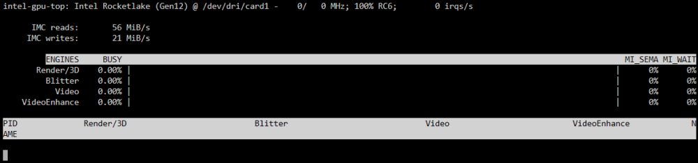

Here you go. This ASPEED, iGPU and dGPU enabled. I will try ASPEED disabled in a bit.
If intel_gpu_top lists the values properly then I'm assuming it's not different with the onboard GPU disabled.
OK, so do you think this is a plugin issue and do you need anything else from, logs etc?
Also, FWIF, plex transcoding still works so no issue with the igpu and aspeed, dgpu all running together...

4 minutes ago, mikeyosm said:
I do get an output -
Thanks, does GPU Statistsc show the Intel card correctly with it's values?

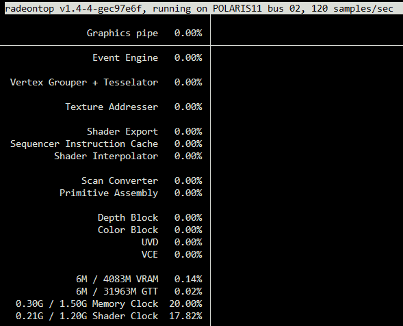

What is the output from:
radeontop
radeontop
GPU stats does not show the Intel correcty

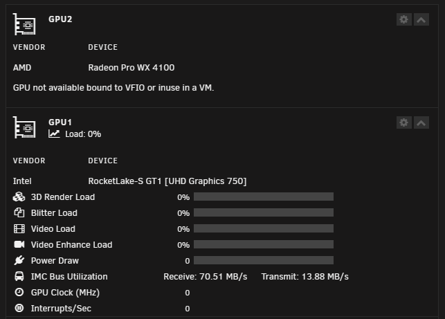

Not sure if this helps but when i bind the WX4100 to a VM, the Intel GPU stats springs to life.

so intel_gpu_top -J -s 250 -d pci:slot=0000:00:02.0 produces output, but timeout -k .500 .600  intel_gpu_top -J -s 250 -d pci:slot=0000:00:02.0 does not?
Correct

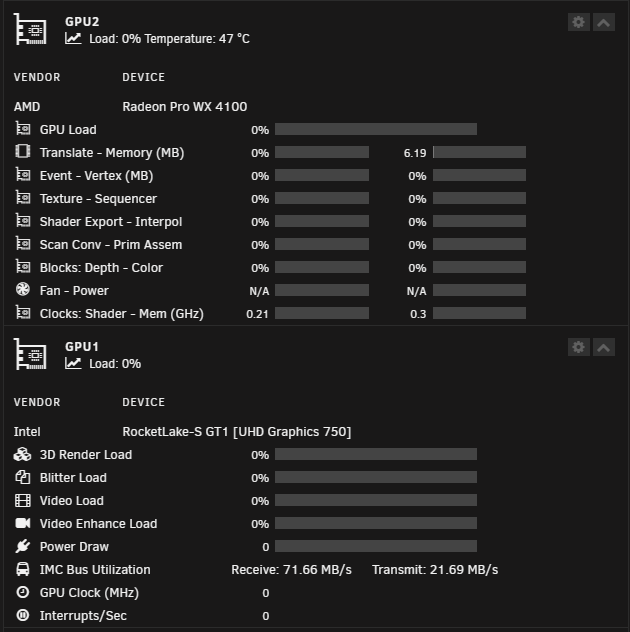

Can you try a longer values in timeout and run a different command?
like timeout -k 2 2  watch cat /tmp/gpujson
I ran that command, the terminal window showed information as per the screenshot but then clears itself.
Also00 running timout tihe longer values produces output.....
