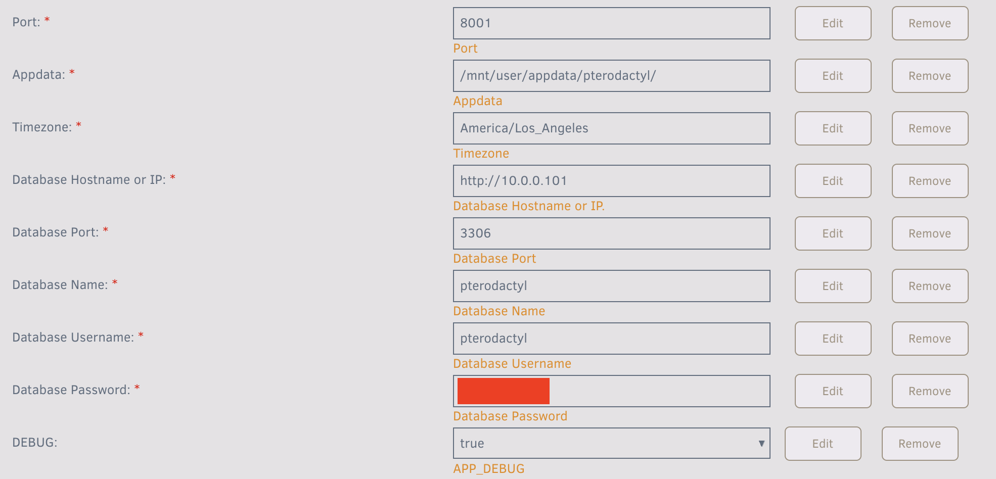

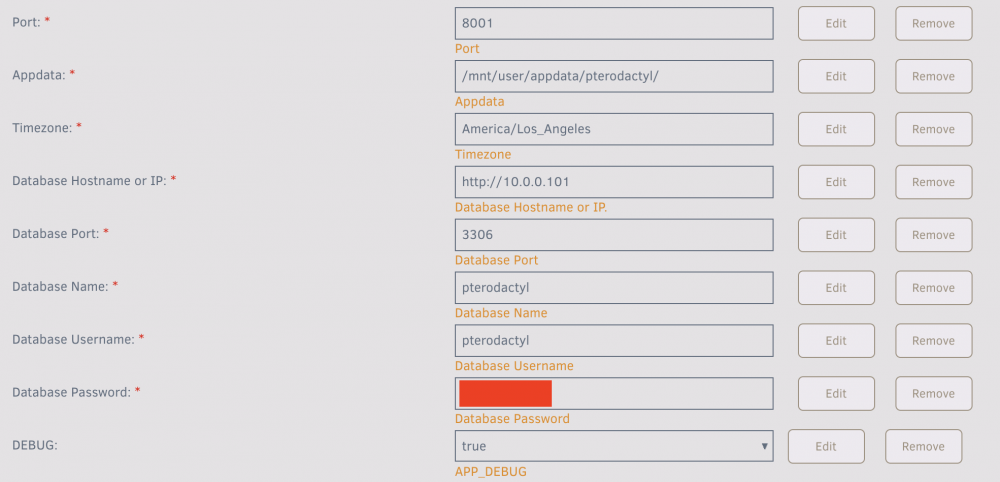

Ok - question about pterodactyl. I set it up, created the db and users in my MariaDB.
I got a 500 page. Then I went to create a user and went through the questionnaire and got:
  SQLSTATE[HY000] [2002] php_network_getaddresses: getaddrinfo failed: Name does not resolve
No idea what is going on there... Turned on debug and got a longer version of the same error.
1048161043_ScreenShot2020-05-20at15_11_07.thumb.png.2ca2eba78066a7f94c1cac5c72184b7d.png

database http://? you dont need that
just put the database ip which is likely is your unraid ip
Ok - removed that, moved it to a custom IP too just in case it was some macvlan nonsense. Still no love.
I rebuilt the entire thing internally and it worked. Probably just needed to execute a bunch of the migrate and other commands for the database.
