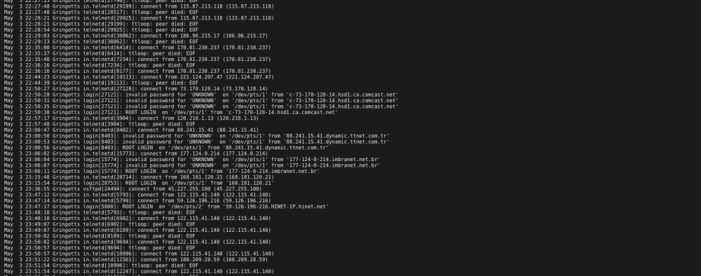

Probable Hack. How exposed am I?

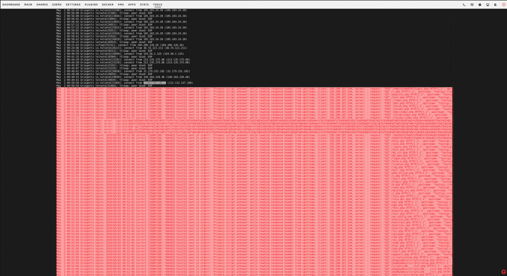

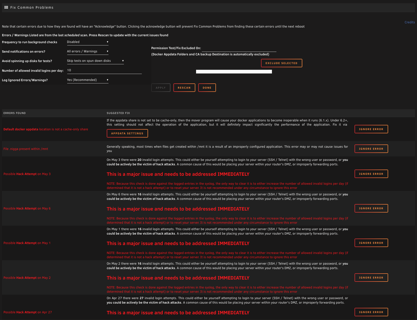

My unraid box is mainly a Plex media server. I thought it odd tonight that when I went to watch a movie and I couldn't find the movie.  All my individual movie folders are still accounted for but 75% of them are missing the movies inside their respective folders.  I ran "fix common problems' and this came up with the attached possible hack attempts.  FYI. My server was set as dmz on my router which was turned on as part of an Unraid tutorial I watched when setting up Unraid and Plex. I'm not unraid savy and I just discovered its a no-no. *sigh*.  I copied some screenshots from some of the logs and at least one of the IP's is a Chinese IP.
At the moment the array is off and I've turned off port forwarding and DMZ for the server on my router.  As it stands I'm pretty sure I have god knows what installed on the box and its going to need a wipe and reinstall.  I'm guessing I'm going to have to wipe all my media/drives just to be sure there isn't anything installed on there.

Considering just how few invalid login attempts there were, and that a login for ROOT did definitely get in, do you even have a password for the root user set?  That alone would have slowed the attack down (wouldn't have stopped it, but may have given you time to have noticed it - btw, if you ran Fix Common Problems on a schedule (its currently disabled), then it would have alerted you to this)
No one with a little bit of knowledge will advice you to put your server on the DMZ. Sry to hear what happened to you, but NEVER EVER put a server on a DMZ especially if you're not tech savy. DMZ on most routers has NO limits for access, no port rules, no malicious traffic detection, no firewall rules at all. You basically facing your server directly to the internet WITHOUT any extra security layers a router provides.
