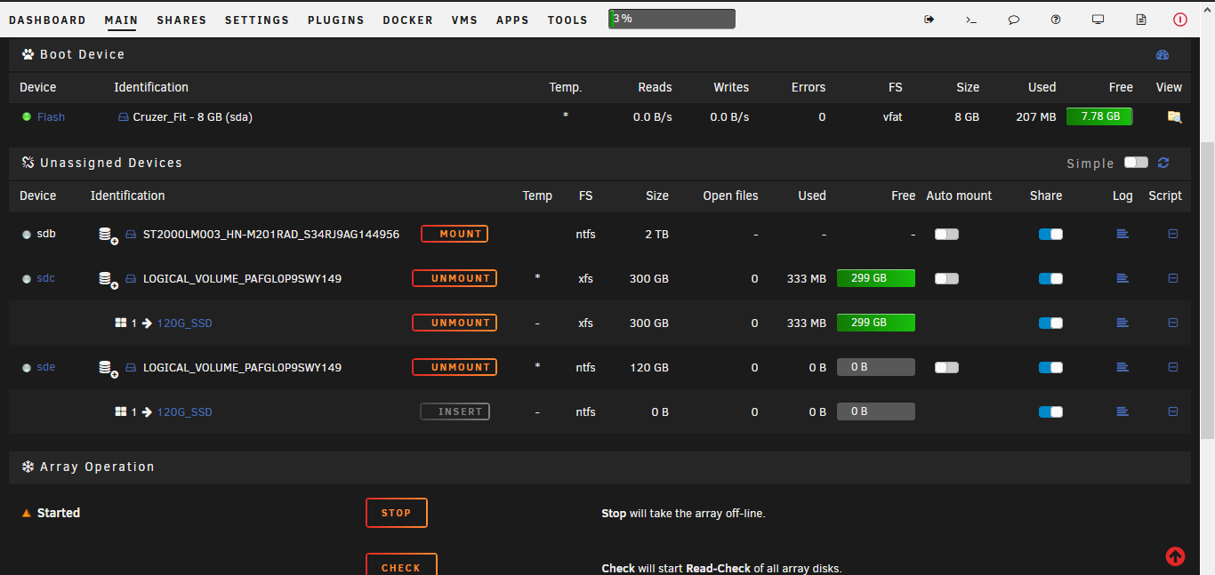

When I try to set/change the mount point name, it adjusts all mount points for every drive connected to the card. It doesn't let me only adjust the one drives mount point.
That doesn't make sense.  Show me a screen shot.

As you can see, once 1 is mounted, the second shows 0.
If I remove the first then the second drive works fine.
If accessing shares then it corresponds to whichever is first in the list.
They have the same id.  UD can't handle that.

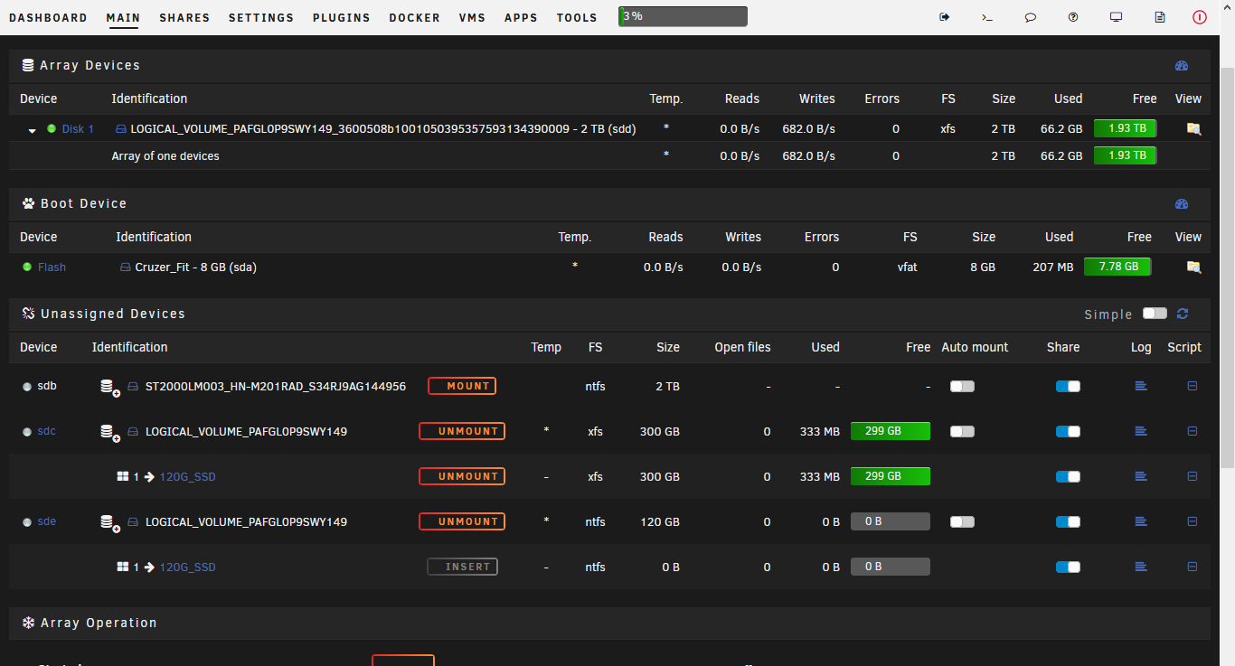

But the ID shown within UD is a shortened version. If I mount a drive into the array then it shows the full ID as shown on disk 1.
Is there a way to get UD to recognise the full ID?
That's not how UD works.  As @trurl said, your setup is not ideal and you need to find another way.
OK, so it's a limitation of UD.
That's not a problem, now that I know that I can try to work around it.
Thanks for clarifying it for me :)

I suspect it is a limitation of the disk controller and how it is handled under Linux
Well since it works as expected in Unraid I am inclined to think otherwise.
UD sees/manages the controller differently - so has the limitations I have encountered.
It is an easy enough workaround - I can only have 1 drive mounted with UD so I can manage it and then add to the array prior to mounting another.
Not ideal but it is managable.
