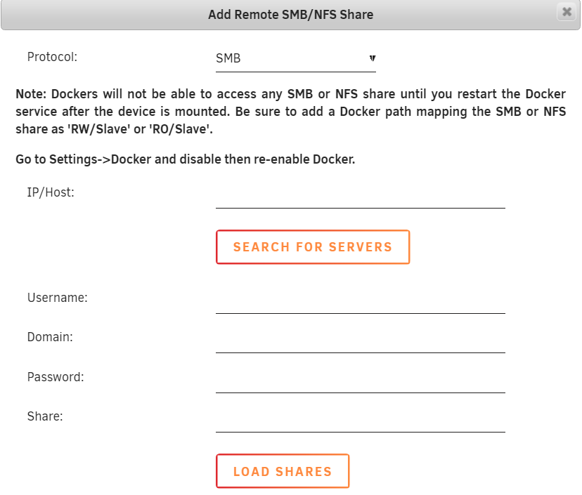

7 minutes ago, dlandon said:
What username are you entering?
Not quite sure i follow..  I don't have SMB security enabled in UD settings, and I've never configured a username or password for SMB shares in UD which is why this log entry looks so strange to me.   The exact same thing is happening on both of my servers.
Edited by cpthook
This is where the username and password are entered.  Obviously you aren't entering a username.
Wait for a bit and I'll issue an update to the plugin.
Bingo!!   Thanks a million for the support that you and so many others provide to me when I find myself in a jam.  FIVE STARS!  I notice that on some occasions you may feel unappreciated, but know that some like me wouldn't be able to maintain their rigs without support like yours.

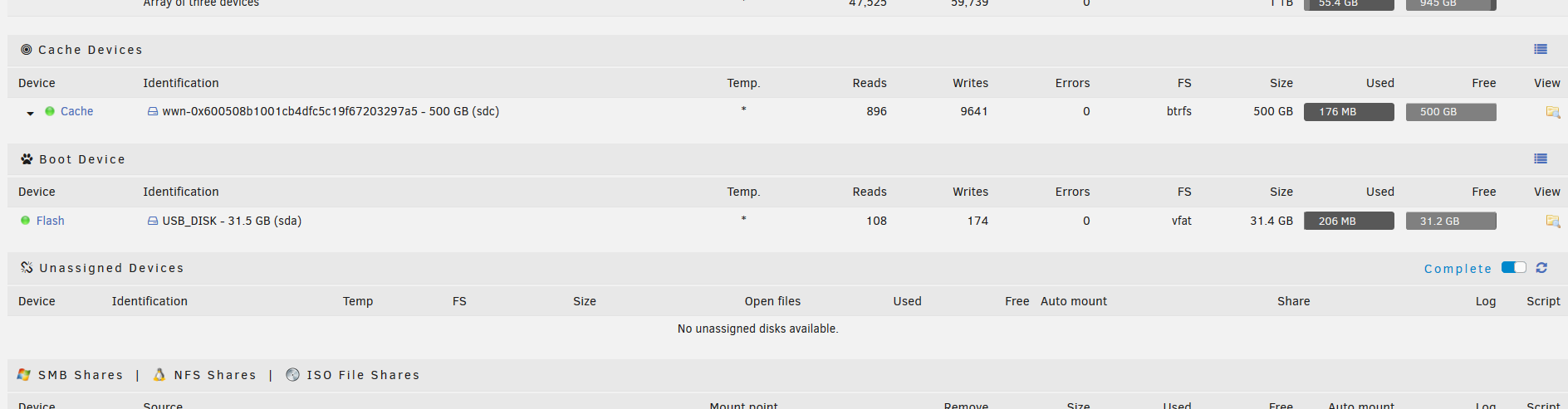

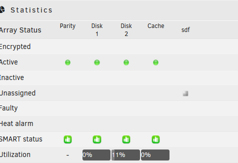

I have a question, I am a new user to the unraid environment and am just trying to get my toes wet and switching from a windows server environment.
so my question is that I have a single 4tb drive that has all of my movies and tv shows on it for plex, I do not want to wipe this drive at this time and would prefer a temporary solution to be able to mount it so that I can make the plex docker see the data. I do not have money for another 4tb drive at this time but am planning to get one later this month, I tried to use unassigned drives to be able to move over at least a majority of the movies and tv shows to the drives on the server at this time but it doesn't even show there is a drive to mount. The server does recognize the drives as I do have the option to format it as seen in the following pictures and it can be mounted as a parity drive but I'm trying to find a way to transfer the data at least to the drives I do have in the computer. Advice is appreciated.
You'll have to post diagnostics so someone can help you.  Whenever you post an issue, add your diagnostics so I don't have to waste time asking.
