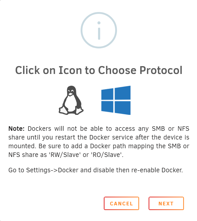

9 hours ago, dlandon said:
Update to the latest version.  It has more explanation.
I did, but nothing different. Set all the paths to RO/Slave and RW/Slave, still nothing. Can't press next. What should I do?
Do as it says.  Click on the Linux or Windows Icon to choose the protocol to use.  Once you click on the Icon, it will show color to indicate it is selected.

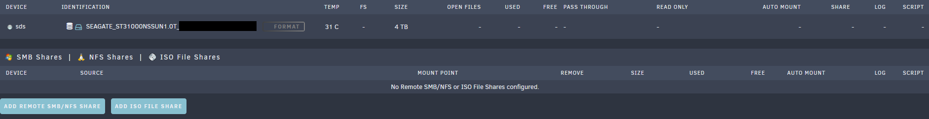

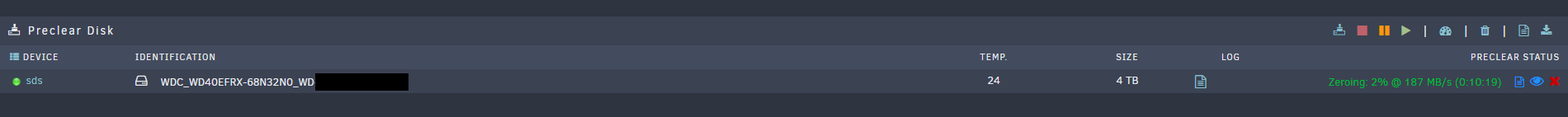

Having an issue where drives that I've swapped out from my eSATA dock aren't updating properly on the dashboard.
If I look at preclear tools it is showing the new disk correctly.  Disk location plugin also sees the new disk versus the old.  Seems to just be the unassigned devices widget that isn't updating.  If it helps, the disk above hasn't been plugged in for over a day when I was preclearing it before binning it.  Below is the correct disk as shown by preclear.
I already cleared my cache.  Running 6.8.3.  Not a big deal as it doesn't impact me functionally, just making a report so it can be looked at some time.
Thanks for all you do!
Click on the Rescan icon (double arrows) and see if UD will pick up the disk:
No dice I'm afraid.

1 hour ago, b3rs3rk said:
No dice I'm afraid.
Remove the preclear plugin.
Will do once this preclear is done in a couple of hours.  I will report back.  I was just reading an issue over there about the preclear log showing the wrong disk too.  Think its related?
It's possible.  Remember both plugins are working with the same unassigned devices.  Preclear gives UD the disk status from a background task running called rc.diskinfo when it is installed to keep UD from interfering with the preclear by probing the disk for information.  There can be issues from that interaction.
@dlandon I removed the preclear plugin and clicked the reload button in UD.  No change.  Went ahead and powered off the drive.  Waited a minute.  Reloaded UD again and verified it was gone.  Then powered on the drive again.  When it came back into UD it was still the wrong name.  I cleared cache and reloaded a few more times and it finally showed up correctly.
