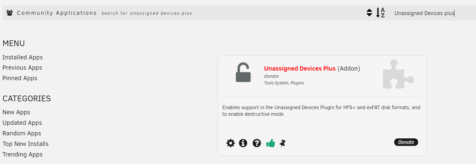

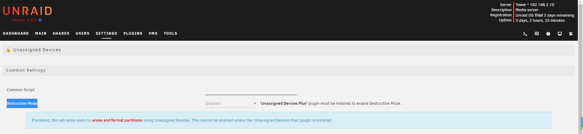

How do I install Unassigned Devices Plus, when I want to format the drive, when I turn on "Destructive Mode", I am prompted "Unassigned Devices Plus' plugin must be installed to enable Destructive Mode", but I do n’t know how to install or purchase Unassigned Devices Plus, I can't find a valid installation method, I hope to get your help, thank you.
On the Apps page. You do have Community Applications installed?

Thank you very much for your help, just now I installed Community Applications and successfully found Unassigned Devices Plus
Go to the Apps tab and search for it.
