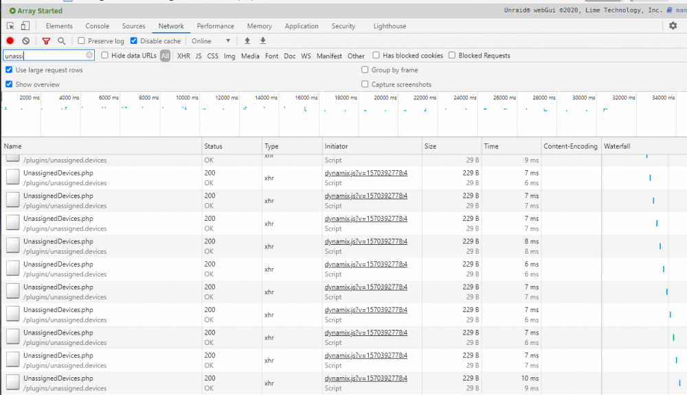

1.) Why is Unassigned Devices sending so many POST requests to "http://thoth/plugins/unassigned.devices/UnassignedDevices.php" while the MAIN tab is open? Regarding my network monitor it connects to the server every second:
POST content:
action=detect&csrf_token=blabla
Response:
{"reload":false,"diskinfo":0}

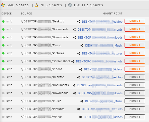

2.) And I have/had an additional problem. I start at the beginning.  Yesterday I decided to replace my SSD. So I changed all cached shares to "prefer" and executed the mover to move all data to the HDD. But the mover was extremely slow. I stopped the mover and enabled the mover logs. Result: New log entries popped up really slow and the mover tried to move files that were already moved?! Didn't make sense. And the even more strange thing was, that there was still action on the HDD. So I used inotifywait to check the traffic on the HDD and finally tried to use lsof to check which process was accessing this HDD and after 20 seconds (!) it returned this:
lsof
lsof: WARNING: can't stat() cifs file system /mnt/disks/DESKTOP-QQ89TOG_Desktop
      Output information may be incomplete.
After additional 20 seconds a WARNING for the next SMB share path appeared. I decided to stop the command and unmount all SMB shares. But it was not possible through the Dashboard. The logs returned that it took more than 10 seconds:
Nov 17 08:56:22 Thoth unassigned.devices: Removing Remote SMB/NFS share '//DESKTOP-/Pictures'...
Nov 17 08:56:22 Thoth unassigned.devices: Unmounting Remote SMB/NFS Share '//DESKTOP-/Pictures'...
Nov 17 08:56:22 Thoth unassigned.devices: Unmounting '//DESKTOP-/Pictures'...
Nov 17 08:56:22 Thoth unassigned.devices: Unmount cmd: /sbin/umount -t cifs '//DESKTOP-/Pictures' 2>&1
Nov 17 08:56:32 Thoth unassigned.devices: Error: shell_exec(/sbin/umount -t cifs '//DESKTOP-/Pictures' 2>&1) took longer than 10s!
Nov 17 08:56:32 Thoth unassigned.devices: Unmount of '//DESKTOP-/Pictures' failed. Error message: command timed out
Finally I unmounted manually ALL SMB shares by the WebTerminal which took each 30 to 120 seconds (!), until I was able to (fast) mount and unmount through the dashboard again. I think it had something to do with some mounted SMB shares that were offline (shutdown Windows PCs). That's how it looks now (before all SMB shares were mounted):
Its only a guess, but I think this delay caused, that the mover has been executed twice (race condition) and so started to move files, that were already moved. Or the mover suffers from the huge timeout which is similar to what happend to me with the lsof command?!
P.S. After unmounting all the SMB shares the mover is fast as usual and does not return any errors. Even after I mounted the SMB shares that are online at the moment.
Conclusions:
- the timeout of 10 seconds should be raised or changeable through the UD settings
- something needs to be changed with the handling of mounted, but offline SMB shares. Maybe an auto unmount after x seconds and if the Auto Mount option has been selected it checks by interval (ping or similar) if it is able to remount the share.

You have a lot of remote mounted shares.  Is it really necessary to do things that way?
What would this do?  If the remote server is not reachable, increasing the delay will only slow down things further.  The reason for the timeouts is to keep some commands like 'df' from completely hanging the Unraid server.  If it can't complete in 10 seconds, it probably won't happen at all.
I've given this a lot of thought because of other users having the same issues.  Unmounting the remote share whenever the remote server is off-line will create more problems than it solves.  CIFS does not work as cleanly as you might think when it comes to unmounting and re-mounting a share when the remote server is off-line.
Conclusion:
- Keep the remote server online and available, or only mount the remote shares when actually needed.
I meant only the timeout of the unmount command, not the general timeout. As long the command is interrupted after 10 seconds its not possible to unmount through the Dashboard. And shouldn't the plugin allow the user to unmount something which was mounted through the plugin? 🤔
Yes. I use the mounted shares to backup the client PCs. Works really nice and does not need any backup software.
What are these problems? I mean what is different compared to a disconnected USB drive?
Of course I could use scripts only, but this is nothing I prefer and nothing I could easily explain to other people. I mean thats the reason why I'm using a Plugin. GUI power 😅
CIFS does not work the same as a hard drive unmount.  Unmounting a remote share that is off-line is messy and shouldn't be done.  The best bet is to get the remote server back on-line.  I'll take a look at some options.
Unmounting a remote share that is off-line is not a good idea for several reasons.  CIFS will do a recovery once the remote server is back on line.  Unmounting a remote share when the remote server is off-line will pull the rug out from under any application using that share and is a really bad idea.  What would be the criteria for unmounting the share?  There are so many different servers I don't know where to even start on the time to wait to unmount, and whether or not the remote server would handle it properly.
The unmount of a CIFS mount is supposed to be forced when the server is off-line.  Looking into the code, I see a logic error that I will correct.  I'll spend a little time testing before including it in UD.
Can't confirm that. "mount -t cifs" returns nothing, although both SMB servers are online again (which is shown in the UD dashboard). "cat /etc/mtab" does not return shares, too.
Again: What is the difference compared to a USB drive (applications could rely on that, too)? Its up the the user to decide if he needs permanent connection. And the Unraid mover is a main unraid component which is in my opinion more important than a backup script which fails because of a unmounted server, which is not reachable anyway. Why not adding a new option?
Regarding my experience not needed. It takes longer, but it disconnects through the usual command, too.
That's how I solved it at the moment:
#!/bin/bash
# make script race condition safe
if [[ -d "/tmp/${0///}" ]] || ! mkdir "/tmp/${0///}"; then exit 1; fi; trap 'rmdir "/tmp/${0///}"' EXIT;
# auto unmount offline smb shares
while read line; do
    smb_server=$(echo $line | grep -oP '^//.*?/')
    smb_server=${smb_server:2:-1}
    smb_share=$(echo $line | grep -oP '^//.*? on ')
    smb_share=${smb_share:0:-4}
    timeout 1 ping -c 1 $smb_server
    if [[ $? -eq 124 ]]; then
        echo "Automatically unmount offline $smb_share"
        /sbin/umount -t cifs $smb_share
    fi
done < <(mount -t cifs)
Only auto-re-mount is missing as I'm searching for the config file of UD at the moment ;)
Edited by mgutt
When I make changes/enhancements to UD I have to take into consideration the application to the wider community.  It appears you have a unique need and have come up with a solution for your situation.  At this time, I don't feel it appropriate to add an automatic unmount/re-mount of remote shares.  We've discussed some of the technical issues.
I do continually look for better ways to handle CIFS shares.  CIFS mounts depend on a reliable network connection and when the remote server goes off-line, the Linux commands to query things like used and free space will hard hang.  'df' is the worst.  That's why the commands are timed out by UD.  Every remote server also seems to do things differently and it's quite a challenge to keep up with every server's quirks.  Some older NAS devices are still using SMBv1, which has known security issues.
