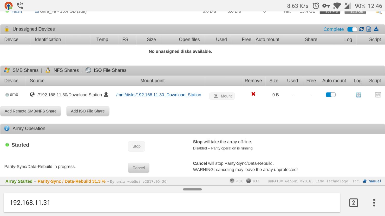

Hi all, Newbie here.
I would like to mount a SMB share (Synology) on Unraid. I can choose the Share (Download Station in this case) from "Add Remote SMB/NFS Share" so I am pretty sure the Username and Password are correct. However I cannot mount it.
Any Insight? Thanks.
Look at the UD log and see why it doesn't mount.
Thanks for your help. It said the remote server is offline but I can still access the remote server via SMB on other computers.

8 minutes ago, johnnie.black said:
Wrong slash, \\ not //
Use the server and share lookup in UD when mounting SMB shares and you won't have this problem typing it in manually.
I did not type those slash. All I did was type the IP/Host (192.168.11.30), Username and Password and select the correct share after clicking "Load Shares".
May I know how to change the "auto generated" slash? Thanks.
Let UD lookup the server and share.  When you add an SMB share click on the "Search for Servers in WORKGROUP" button to lookup the servers on your network.  Select the server and then click on "Load Shares" and select the share.  Enter any credentials and add it to UD.
There may be an issue with UD when entering the IP address.  I'll have a look.
The server did show up if I click "search for servers in WORKGROUP" but no share can be find after clicking "Load Shares".
I will try to set up another working smb server to see if there is a bug in the plugin or anything else.
The "//" are correct for UD mounts.
Download and post the UD log.
I managed to mount the share using command line for now. Will try to set up a smb server soon.
Here you are. Hope the log can help.
unassigned.devices.log
Go to a command line and give me the result of this command:
/bin/ping -c 1 -W 1 192.168.11.30
When you add an SMB or NFS share and the 'Mount' button is grayed out, it means that UD cannot ping the server and therefore thinks the server is off-line and can't mount it.  Figure out why the server cannot be ping'd and it should work.  You also see the 'smb' icon shows the server is off-line.
1 packets transmitted, 0 received, 100% packet loss, time 0ms
I guess it is my issue then..?
Yes.  UD doesn't think the server is on-line if there is no response to the ping.
It is strange. UD can find the server when searching but think it is offline. I can mount the share using command line (this method).
May I have some suggestions that where should I look into first?
Mounting the share would happen in UD if the server responded to the ping.  UD won't even attempt to mount the share if the server doesn't respond to a ping.  Get the server to respond to the ping, and UD will allow mounting the share.
See if there is an option on the server to respond to pings.
YOU ARE THE BEST! I put the IP address on Unraid in the whitelist of the firewall setting on the synology and now UD can successfully mounted the shares.
