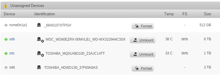

NVMe cache device is on the unassigned devices list with a strange identifier:
Do you have the preclear plugin installed?
Nope.
Are you running unRAID 6.4?
Yes, I know the NVMe is not identified correctly, still it shouldn't appear as an available unassigned device.
1 hour ago, dlandon said:
Post a diagnostic.
Attached.
tower1-diagnostics-20170716-1213.zip

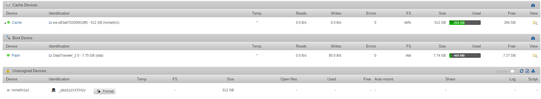

Please show a screen shot of all unassigned devices.  Try to make it more readable.  I can barely read the device id.
29 minutes ago, dlandon said:
 I don't like the truncated nvme-TOSHIBA-RD400_.  That may be part of the issue,
Probably.
