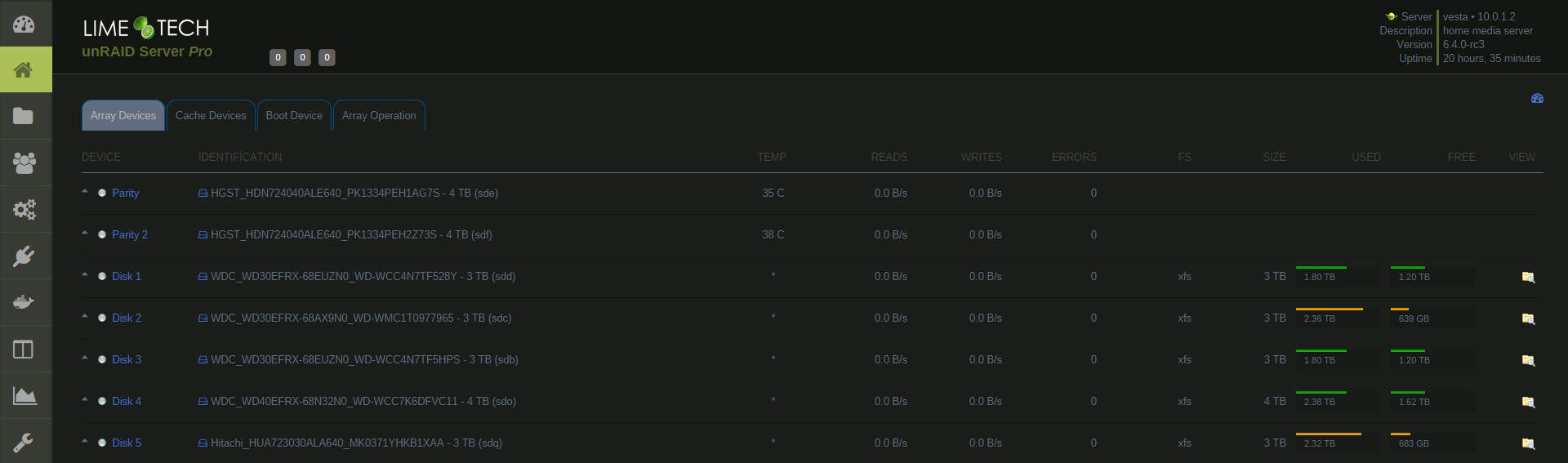

Using 6.0.4rc3 with the Gray theme I see some alignment issues from about half way across the screen.
This is on 1440x900 laptop.
Screen shot included.
Kevin.

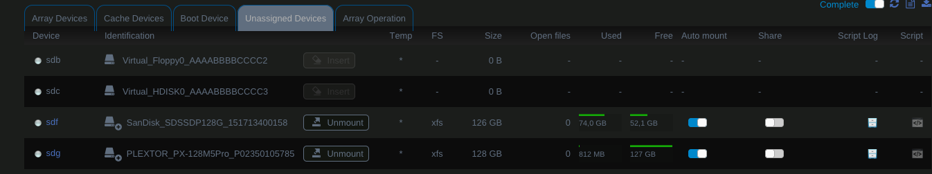

The 'Used' and 'Free' indicators are very lightly shaded and if you look closely you'll see the shading is wide and fits.  The issue is that the graphic indicator is left justified and it looks mis-aligned.  The field should probably be shaded differently to be more discernible.  If you look at the 'Main' screen, you'll see the same issue with the 'Used' and 'Free' indicators on the drives.
This is built into Dynamix and is not under my control.
Is UD using its own styling components? In the gray theme there is no alternating background. See below
Yes it is.  These are the style sheets I asked you to look at.  I'm not a style sheet guy.
I just copied the white css to azure, and black css to gray.  Color adjustments are needed.
Looking really close I would say that Auto mount & Share could be moved to the right slightly and if it's possible Free & Used should be Centre aligned.
Just my thoughts. I haven't looked at HTML & CSS for about 10 years.
Kevin.
I've sent a PM to gfjardim to see if he can give me a hand with the Azure and Gray style sheets.
I've done some updates the the UD web page to be more compatible with the Azure and Gray themes in unRAID 6.4.  I also did some alignment so the table elements line up better in all the themes.
The UD plugin uses its own style sheets as well as the Dynamix style sheets.  The Azure and Gray need some color adjustments, but I am not a style sheet guy.  I'm hoping gfjardim can lend a hand.  He authored the original UD style sheets.
I think I have the colors work out on the spinny thing that shows when UD is busy

Hello guys,
I am new to Unraid OS and I have some questions regarding this plugin. How can I activate Auto-Mount after each restart?  I toggled the Auto mount slider but it does not auto mount after restart? Is there a possibility to mount ReFS formatted drives? I can not find any driver for that.
Yours

6 hours ago, UltimateWidder said:
Hello guys,
Yours
Which auto mount slider is not working?  Post the UD log.  ReiserFS support is built into unRAID.  UD will mount a ReiserFS disk.
I believe is talking about ReFS, the new MS filesystem and AFAIK not supported by unRAID or any other linux OS.
