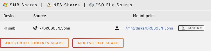

I've recently started seeing an error message appear in my syslog whenever I refresh the Main page of the GUI (I use non-tabbed mode so the UD section gets refreshed every time I select Main):
Nov 20 04:12:45 Mandaue unassigned.devices: Error: Cannot get IP address for 'DROBO5N' from nmblookup.
It's telling the truth because the DROBO5N file server is currently powered down:
The fact that it's unavailable is nicely indicated by the grey ball so the entry in the syslog is unnecessary. I'm wondering if it's caused by a remnant of debugging code that you added to investigate @fibreiv's recent problem.
Diagnostics: mandaue-diagnostics-20181120-0435.zip
That log entry is so we can tell why the ping of the remote server did not work.  If your remote is mounted, it shouldn't show.  I'll take a look.
Today's update stopped the error messages. Thank you, Dan.

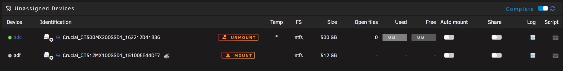

Hi all. I have problem with one SSD (of two, passed-through to Windows VM's). Where it shows always as mounted, and cannot be unmounted.
Nov 21 14:24:01 echidna unassigned.devices: Disk '' could not be unmounted...
Nov 21 14:38:03 echidna unassigned.devices: Disk with serial 'Crucial_CT500MX200SSD1_162212D41B36', mountpoint 'Wiederherstellung' is not mounted and cannot be unmounted...
Nov 21 14:38:03 echidna unassigned.devices: Disk with serial 'Crucial_CT500MX200SSD1_162212D41B36', mountpoint 'Crucial_CT500MX200SSD1_162212D41B36-part2' is not mounted and cannot be unmounted...
Nov 21 14:38:03 echidna unassigned.devices: Disk with serial 'Crucial_CT500MX200SSD1_162212D41B36', mountpoint 'Crucial_CT500MX200SSD1_162212D41B36-part3' is not mounted and cannot be unmounted...
Nov 21 14:38:03 echidna unassigned.devices: Device '' script file not found.  'REMOVE' script not executed.
Nov 21 14:38:03 echidna unassigned.devices: Unmounting disk ''...
Nov 21 14:38:03 echidna unassigned.devices: Unmounting ''...
Nov 21 14:38:03 echidna unassigned.devices: Unmount cmd: /bin/umount '' 2>&1
Nov 21 14:38:03 echidna unassigned.devices: Unmount of '' failed. Error message:  umount: : no mount point specified.
Nov 21 14:38:04 echidna unassigned.devices: Since there aren't open files, will force unmount.
Nov 21 14:38:04 echidna unassigned.devices: Unmounting ''...
Nov 21 14:38:04 echidna unassigned.devices: Unmount cmd: /bin/umount -f -l '' 2>&1
Nov 21 14:38:04 echidna unassigned.devices: Unmount of '' failed. Error message:  umount: : no mount point specified.
Nov 21 14:38:05 echidna unassigned.devices: Disk '' could not be unmounted...
How I can unmount it ?
A snippet of the log is not helpful.  Post your diagnostics.
The sdc disk is one of your cache disks, but the cache disk is not that disk.  It appears it is an old assignment in UD that is not for the correct disk.  I.e you had a disk in UD that was moved to a cache disk?  Or preclear is confusing UD.
Do this:
- Remove the preclear plugin in and see if that disk is removed from UD.
- Then, reboot the server and see if it clears up.
- Delete the /flash/config/plugins/unassined.devices/unassigned.devices.cfg file.  You'll have to re-do any UD settings.  Reboot the server.
Do this:
I did all 3 steps, unfortunatelly situation is stil the same. SSD is mounted, and cannot be unmounted.
Attached diagnose file.
echidna-diagnostics-20181123-1310.zip
Show me a screen shot of the UD devices and post the /flash/config/plugins/unassigned.devices/unassigned.devices.cfg file.
.cfg file is empty
-rwxrwxrwx  1 root root    1 Nov 23 13:05 unassigned.devices.cfg*
