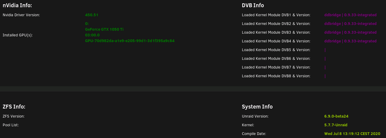

what am I missing?
Edited by emrepolat7
53 minutes ago, emrepolat7 said:
---Trying to get latest version for DigitalDevices driver---
---Latest version for DigitalDevices driver: v0.9.37---
---Trying to get latest version for LibreELEC driver---
---Latest version for LibreELEC driver: v1.4.0---
---nVidia driver manually set to: v450.51---
---Trying to get latest version for Seccomp---
---Latest version for Seccomp: v2.4.3---
---Trying to get latest version for 'nvidia-container-runtime' driver---
---Latest version for 'nvidia-container-runtime': v3.2.0---
---Trying to get latest version for 'nvidia-toolkit' driver---
---Can't get latest version for 'nvidia-toolkit', putting container into sleep mode!---
what am I missing?
Nothing, they moved the toolkit to another location, give me some time and i will fix this, will report back ;)

Container updated and now fully compatible with v6.9.0beta24 (prebuilt images will be updated soon).
EDIT: Prebuilt images are now online.
Thank you very much
Envoyé de mon HD1913 en utilisant Tapatalk
I compile my kernel for bêta 24 with nvidia and it's work.
Great News no more need flr patch for Audio and usb passthrough on x570 ryzen Board. It's implemented in 5.7.7 stock kernel [emoji16].
