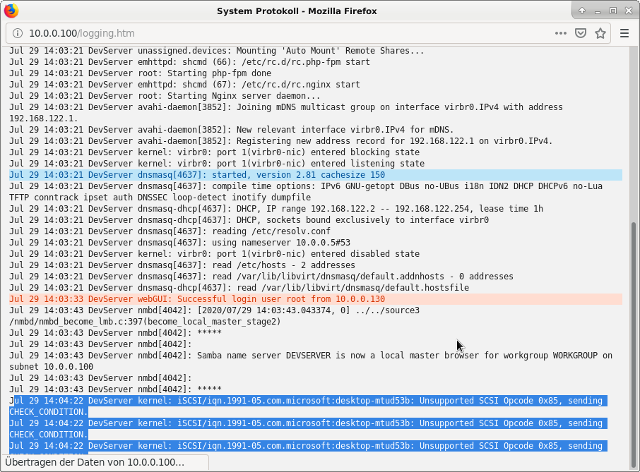

I'm currently searching for some users that help test my custom build with iSCSI built into Unraid (v6.9.0 beta25).
EDIT: Build for Unraid v6.8.3 is also now available.
Currently the creation of the iSCSI target is command line only (will write a plugin for that but for now it should also work this way - only a few commands in targetcli).
The configuration is stored on the boot drive and loaded/unloaded with the array start/stop.
If somebody is willing to test the build please contact me.
As always I will release the complete source code and also implement it in my 'Unraid-Kernel-Helper Docker Container' so that everyone can build his own version with other features like nVdidia, ZFS, DVB also built in.
Also made a post here:
