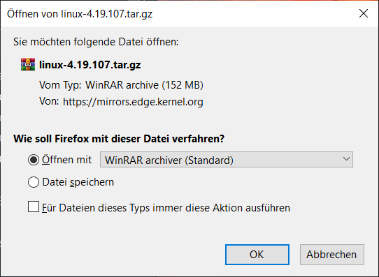

23 minutes ago, Jase said:
No, I didn't stop the container throughout the process. I have tried the link above out and the browser says "This site can’t be reached mirrors.edge.kernel.org took too long to respond."
Yes that's why the container isn't working because it can't connect to that site, have you got a instance of PiHole running on your server or something else?
Is the site https://www.kernel.org/ working or is it the same?

If you can get that file for 6.8.3 'linux-4.19.107.tar.gz' from somewhere else (but that's nothing I recommend) and place it in the main directory it would also built the container.

The file is reachable and downloadable (attached a screenshot):

Thank you so much for your help! Danke!
So, yes I'm being blocked somewhere and I'm guessing my Unifi firewall is preventing it. Manually moving the downloaded kernel 4.19.107 on another network worked after restarting the container. Now it is stuck with ZFS vmaster. Kernel.org works on the network but just won't download with Unraid. Where would I find ZFS vmaster?
