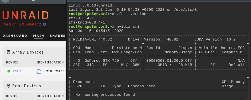

Hey, @ich777 thanks so much for the ZFS support, now when new kernels come out, I don't need to wait for any other devs to compile nvidia / zfs etc which is fantastic!  And the ZFS works the same as the other ZFS plugin, so can switch back and forth if I so desired, but probably just going to use your version now, thanks!
Edited by Marshalleq

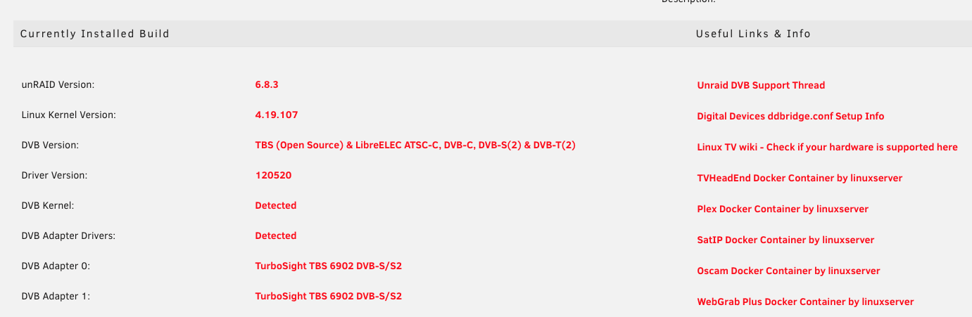

Hi everyone I can confirm both TBS Opensource dvb tuner and nvidia card is working with this prebuild image. Transcoding is also working with plex thanks again for the great work ;) @ich777
