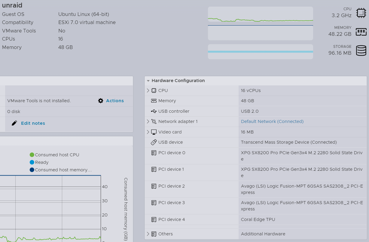

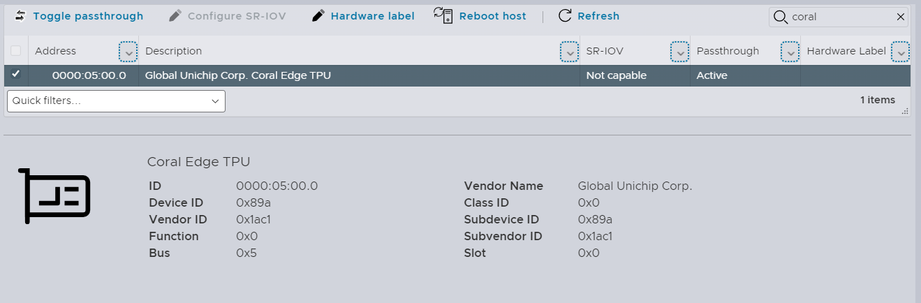

Would love some advice on getting mini pcie coral up and running.
underlying hardware might be causing issues - unraid is running virtualized on esxi 7 on a dell r730. coral is passed through to unraid
shows up in system devices - driver is installed but *doesn't* show on coral driver status screen, subsequently doesn't show in frigate container. driver version installed is 2023.07.31
[1ac1:089a]03:00.0 System peripheral: Global Unichip Corp. Coral Edge TPU
any suggestions would be much appreciated.
@ich777 do you have any advice for virtualized unraids?
Sadly enough no, there are too many variables involved in virtualized environments.
Please post your Diagnostics.
I‘m not sure but most of the times it has to do with the Host system.
I‘ve seen such issues a few times with Nvidia GPUs too.
absolutely, please let me know if you need anything else. Really appreciate you taking the time!
