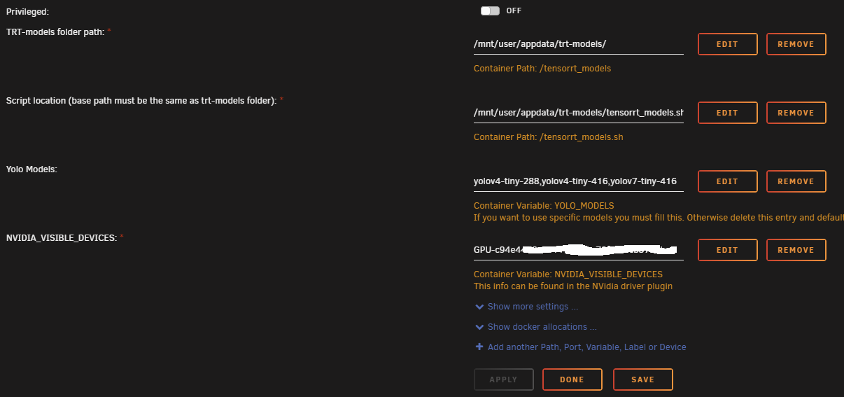

Need some help, when trying to generate models using the tensorrt-models docker
When trying to grab tensorrt_models.sh using the link in the template I get a "404: Not Found" error
https://raw.githubusercontent.com/blakeblackshear/frigate/dev/docker/tensorrt_models.sh
Using the link in the documentation https://docs.frigate.video/configuration/detectors
https://github.com/blakeblackshear/frigate/raw/master/docker/tensorrt_models.sh
open console and run the following
chmod +x /mnt/user/appdata/trt-models/tensorrt_models.sh
I can't execute or start the docker it gives me
Execution error
Bad parameter
I get the following error in the logs
text  error  warn  system  array  login
/opt/nvidia/nvidia_entrypoint.sh: /tensorrt_models.sh: /bin/bash^M: bad interpreter: No such file or directory
/opt/nvidia/nvidia_entrypoint.sh: line 49: /tensorrt_models.sh: Success
Execution error
Bad parameter
Does "chmod +x /mnt/user/appdata/trt-models/tensorrt_models.sh" give you some output?
Do you have the /mnt/user/appdata/trt-models folder mapped already to frigate and frigate running?

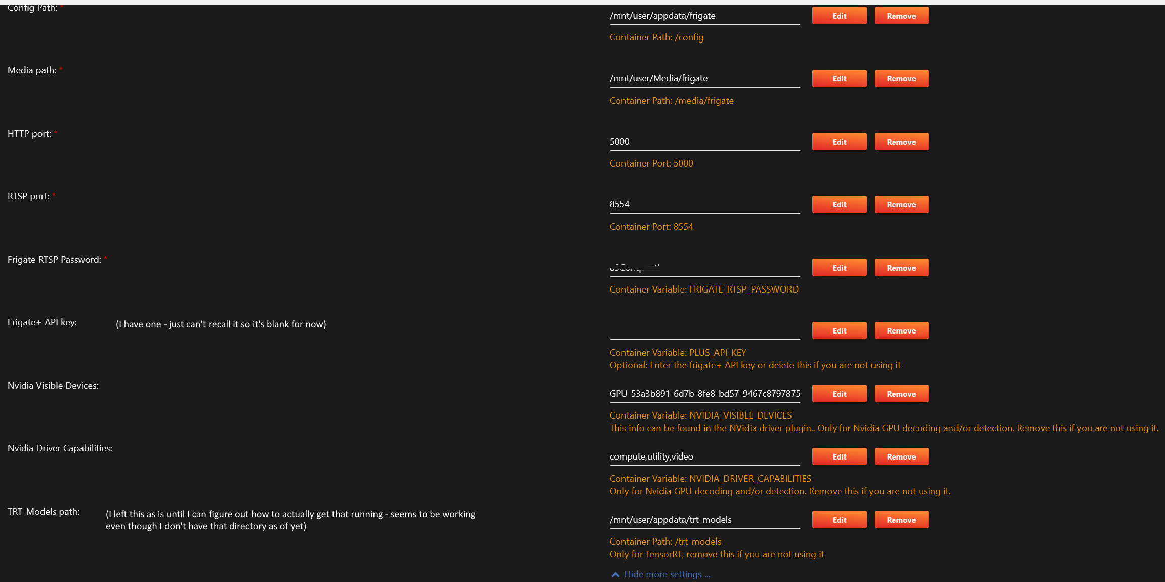

So, I've been messing with it because I am too stubborn to call it quits.  I seem to have it up and running.  However, picking the Nvidia Branch when selecting which version to install from CA and then trying to enter into the config.yml:
hwaccel_args: preset-nvidia-h264
Which, causes an error about FFMPEG crashing.  If I remove the hwaccel_args: preset-nvidia-h264 and restart frigate docker, I can see the stream.  I did enter my GPUID and clicked advancded tab and entered the --runtime=nvidia at the end of all the other text that was already pre-populated.
--shm-size=256mb --mount type=tmpfs,target=/tmp/cache,tmpfs-size=100000000 --restart unless-stopped --runtime=nvidia
Running the command nvidia-smi without the hwaccel_args tells me that there are no running processes.
I'm using a Geforce GTX 1050 on a Reolink RLC-410W
You DID tell me to ask for help.  So, this is pretty much your fault now ;)

Update 19:46HRS: Tried messing with the Tensor docker.  It filled my docker memory usage to 90% once it extracted almost 4GB worth of files.  Almost crashed my entire system.  Not good.
Edited by CoZ

3. Can you attach a screenshot of the template config you are using and the config file?
You can expand the docker image from unraid if you are out of space, this is something that I can't expect from every user. You are the responsible of your system not me. If you don't like this just buy any commercial software.

I would like to have both, the screenshot and the file, to see if there is something to fix in the way you are launching the container or in the config file.
As requested.  I am sure you are going to have a field day with this one and just rip apart what I've done.  I'm ready.  Go for it. ;)
