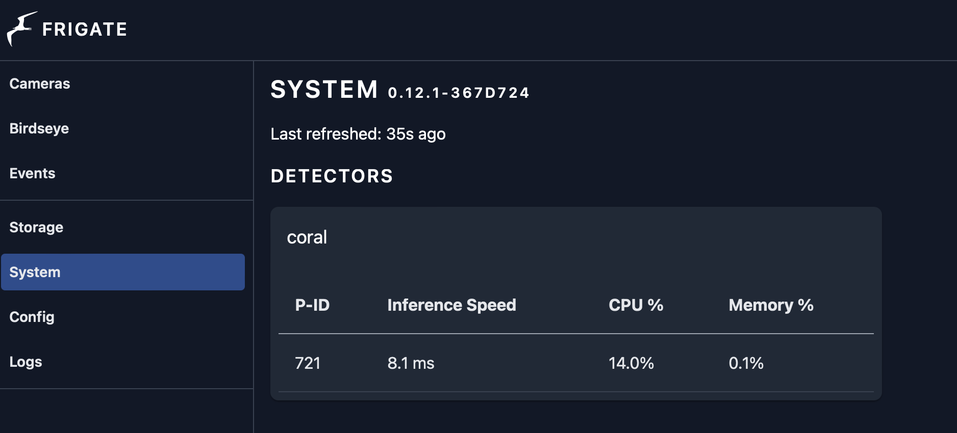

I did. but I removed it. I imagine you should still be able to see it in unraid lsusb first. Is there a command to check with ffprobe?
Think it was plug and play for me... you say you tested it in windows? Is it still passed through to a VM?
Within frigate you can click 'system' and it will show up if the correct config is there which is:
detectors:
  coral:
    type: edgetpu
    device: usb
1720542401_Screenshot2023-09-11at14_28_33.thumb.png.3edd8e04fe801ae76c28488c74cf4873.png

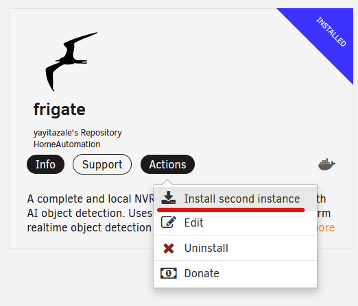

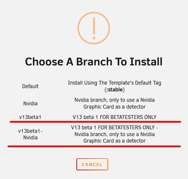

Now that the beta1 is official I have added the beta1 and beta1-tensor tags to the deploy selector. Anyone interested can test the beta1 just installing a second instance with the beta tag. I strongly suggest you to use a different paths than the stable frigate for config and media folders.
Steps to securely test betas:
  • Create a new folder on appdata called frigate-beta.
  • Create a new media folder again with a different name.
  • Just stop the running stable frigate app, don't delete.
  • Copy and paste the config file in the new folder and edit it modifying it with the new requirements.
  • Optionally, copy and paste the database file in the new folder.
  • Launch the new frigate beta as a second instance with a different name, like "frigate-beta" and change the path of the config file and media path to the new ones. In this way you can have both old and new frigate (only one running but both containers):
imagen.png.4a9b82377a335c77db867adf7d040bfe.pngimagen.png.8ab125a14cf0c3876039906e49b3d789.png
  • You can make trials to make beta to work, but if you don't make it in just one try, you can just stop the frigate beta and start the stable one as many times as you need.
  • Don't forget to delete the unused orphan images clicking in the advanced view in the docker container page:
