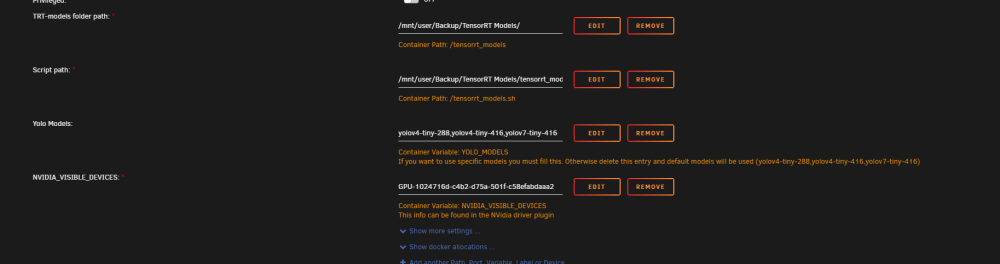

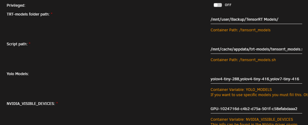

@yayitazale Below is how i have it currently setup, i tried changing the path to user/appdata but it still fails
This is what i see in the container logs
/opt/nvidia/nvidia_entrypoint.sh: /tensorrt_models.sh: /bin/bash^M: bad interpreter: No such file or directory
/opt/nvidia/nvidia_entrypoint.sh: line 49: /tensorrt_models.sh: Success

Can you try to put the script on the path of first entry "TRT-Models folder path", in the case of the image, "/mnt/user/Backup/TensorRT Models/" ??
I suspect that the second entry is not working but as I tested using the same folder for both I didn't notice it. If this works I would change the template and the steps on the description.

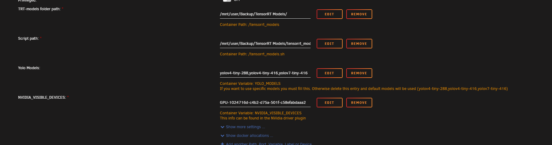

@yayitazale So unless i misunderstood you, i moved the script to the user/backup/tensorrt models folder, updated the paths, re-did the chmod +x and ran it but the same error happened.
Here is my current config
/opt/nvidia/nvidia_entrypoint.sh: line 49: /tensorrt_models.sh: Permission denied
/opt/nvidia/nvidia_entrypoint.sh: line 49: exec: /tensorrt_models.sh: cannot execute: Permission denied

Ok now the error is different. Are you sure you did the chmod +x to the file in /mnt/user/Backup/tensorrt models/ ??
