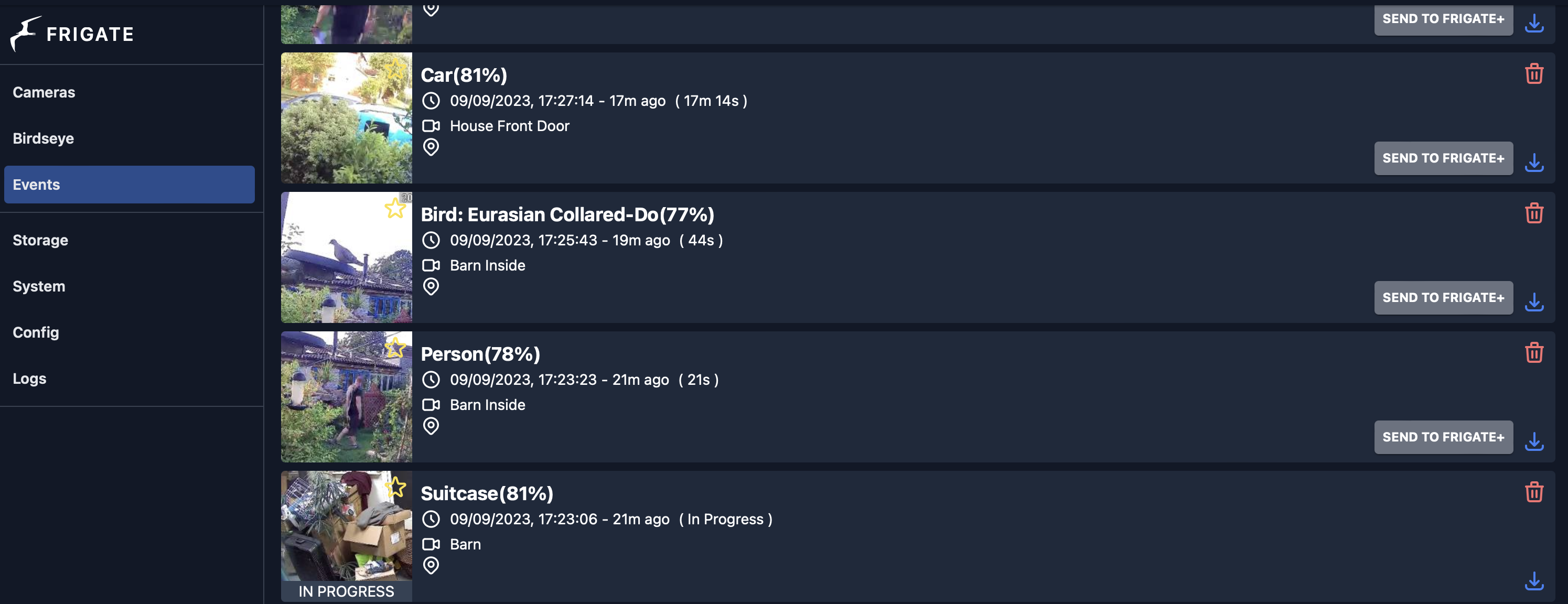

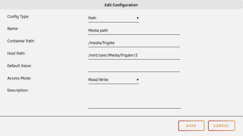

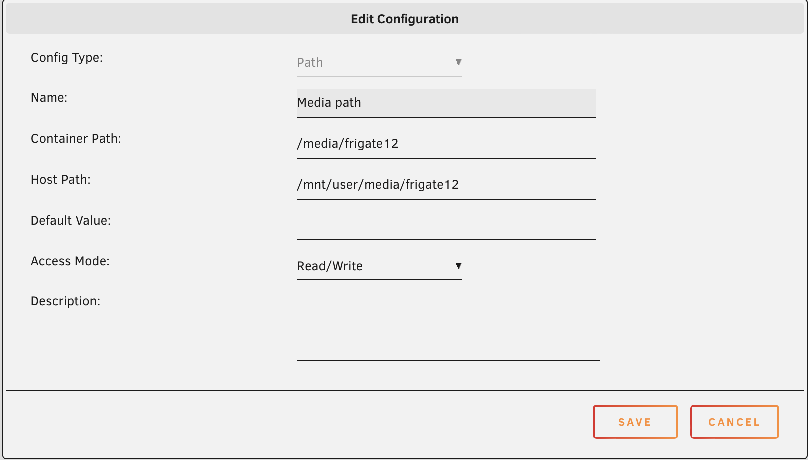

Before doing that I wanted to get it running cleanly.  Right now I can only see clips in UI when in progress.  Some show the clip link as greyed out or others report "The media could not be loaded, either because the server or network failed or because the format is not supported."
Probably related, I noticed that the media folder frigate12 I configured has nothing in it.  But the frigate folder set up for the original docker is still showing new files.  The old Frigate docker is not started.  The media path is setup - but I think something is getting crossed here?
I captured what I think are the log entries when I try to play a clip that returns the error.
2023-09-04 09:43:51.189378806  [2023-09-04 09:43:51] frigate.http                   ERROR   : No recordings found for the requested time range
2023-09-04 09:43:51.709133133  2023/09/04 09:43:51 [error] 172#172: *275 ngx_child_request_wev_handler: upstream returned a bad status 404 while sending to client, client: 192.168.2.201, server: , request: "GET /vod/event/1693824835.69601-0uhrev/master.m3u8 HTTP/1.1", host: "192.168.2.110:5000", referrer: "http://192.168.2.110:5000/events"
2023-09-04 09:43:51.709171127  192.168.2.201 - - [04/Sep/2023:09:43:51 -0400] "GET /vod/event/1693824835.69601-0uhrev/master.m3u8 HTTP/1.1" 502 559 "http://192.168.2.110:5000/events" "Mozilla/5.0 (Macintosh; Intel Mac OS X 10_15_7) AppleWebKit/537.36 (KHTML, like Gecko) Chrome/114.0.5735.106 Safari/537.36 WebCatalogPhoton/34.2.0" "-"
2023-09-04 09:43:51.736153730  [2023-09-04 09:43:51] frigate.http                   ERROR   : Event does not have recordings: 1693824835.69601-0uhrev
2023-09-04 09:43:51.736772756  2023/09/04 09:43:51 [error] 172#172: *275 ngx_child_request_wev_handler: upstream returned a bad status 404 while sending to client, client: 192.168.2.201, server: , request: "GET /vod/event/1693824835.69601-0uhrev/master.m3u8 HTTP/1.1", host: "192.168.2.110:5000", referrer: "http://192.168.2.110:5000/events"
2023-09-04 09:43:51.736777945  192.168.2.201 - - [04/Sep/2023:09:43:51 -0400] "GET /vod/event/1693824835.69601-0uhrev/master.m3u8 HTTP/1.1" 502 559 "http://192.168.2.110:5000/events" "Mozilla/5.0 (Macintosh; Intel Mac OS X 10_15_7) AppleWebKit/537.36 (KHTML, like Gecko) Chrome/114.0.5735.106 Safari/537.36 WebCatalogPhoton/34.2.0" "-"
2023-09-04 09:43:58.377046426  192.168.2.113 - - [04/Sep/2023:09:43:58 -0400] "GET /api/stats HTTP/1.1" 200 4241 "-" "HomeAssistant/2023.8.3 aiohttp/3.8.5 Python/3.11" "-"

16 hours ago, The Transplant said:
I will look into FFMPEG - I haven't found any how-tos so will see if I can figure that out.
And my config:

In the folders mapping you should have this, as inside the container there is no difference between the dockers. That is the point of using containers, that for the container itself everything is where it has to be but you can tinker the things from outside.

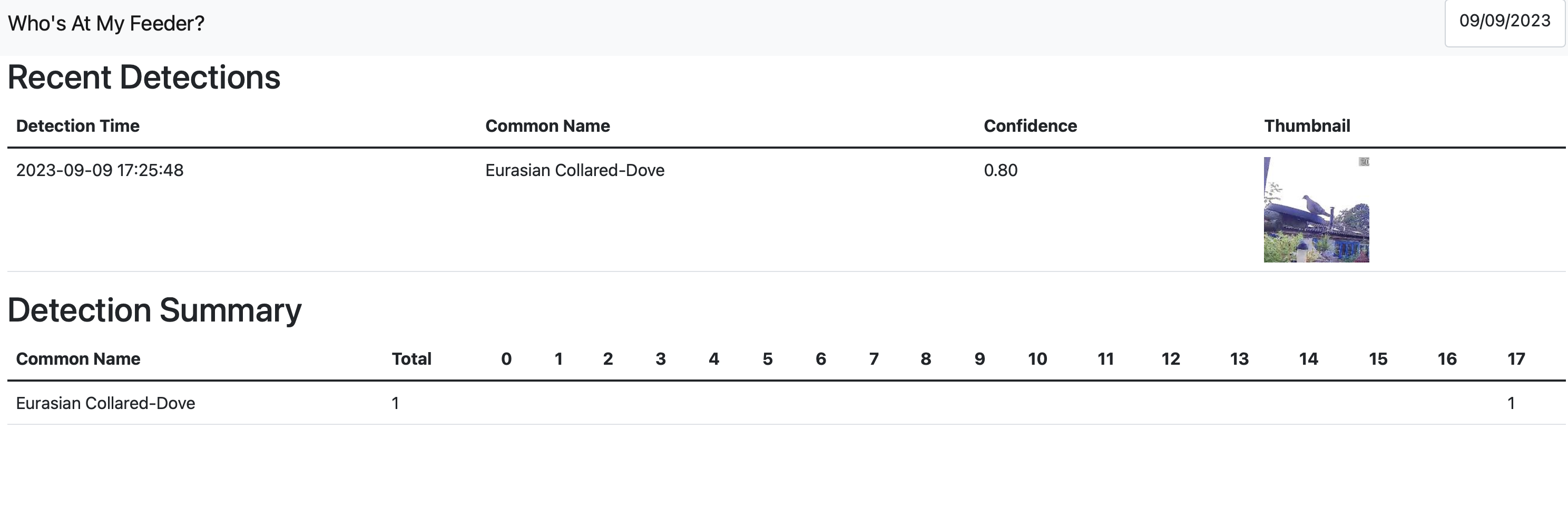

Took me a few days but finally got Whosinmyfeeder working.
838556974_Screenshot2023-09-09at17_44_36.thumb.png.25feb6085c90ff9596629e04c1f5b690.png
Frigate
1749627485_Screenshot2023-09-09at17_44_55.thumb.png.94e74b51b1a4b514ea54429c52a55445.png
The problem was I was putting the MQQT port on the end of the IP.
For anyone else looking this is what the config should look like for Whosinmyfeeder
NOTE: Only frigate needs a port no on the end of the IP
Whosinmyfeeder config.yml
frigate:
  frigate_url: http://192.168.22.2:5000
  mqtt_server: 192.168.22.2
  mqtt_auth: false
  mqtt_username:
  mqtt_password:
  main_topic: frigatea
  camera:
    - barn_inside
  object: bird
classification:
  model: model.tflite
  threshold: 0.6
webui:
  port: 7766
  host: 0.0.0.0
