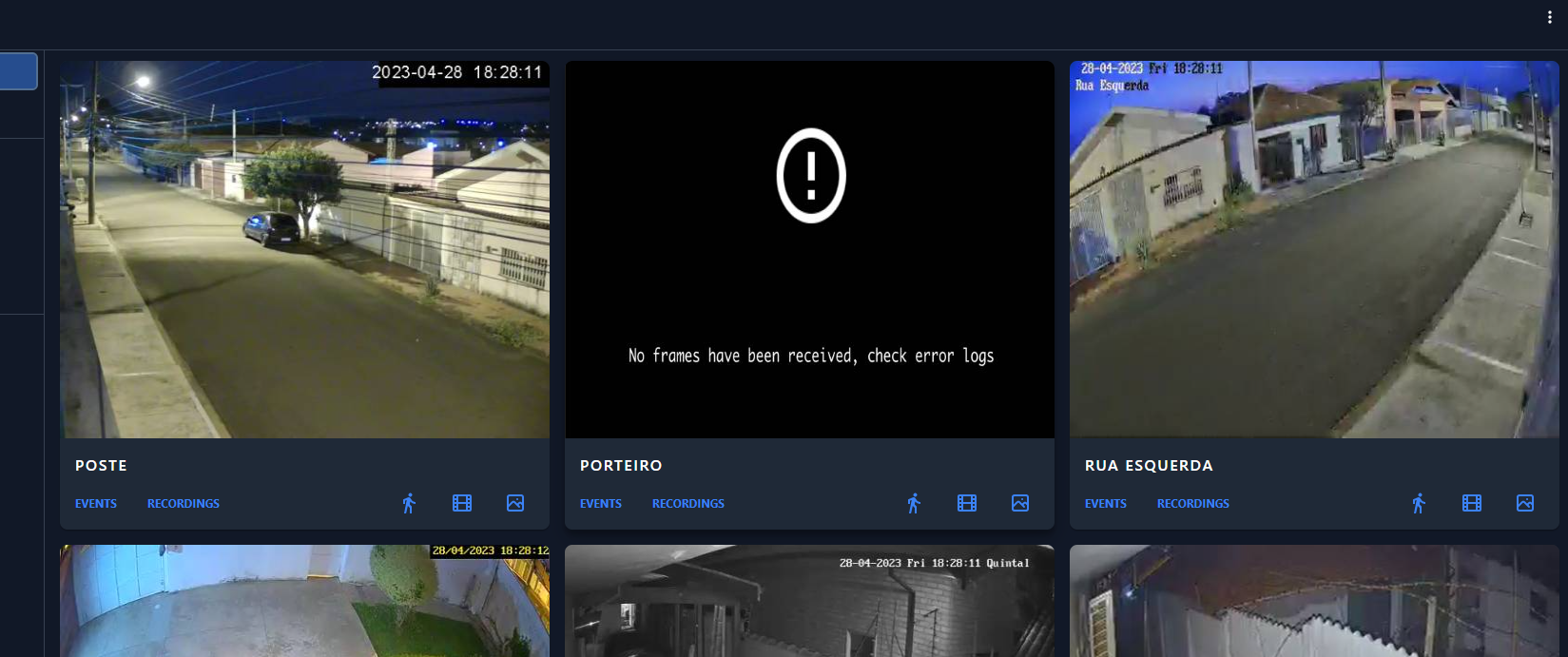

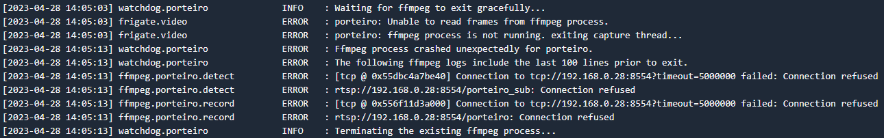

I would like to ask for some help, I would greatly appreciate it if you can shed some light on how to solve the problem, I am trying to implement the use of go2rtc in my new version of FRIGATE 0.12.0-DA3E197
PROBLEM: When I entered the information that I didn't have in the old versions to use GO2RTC, the camera image no longer appears in the FRIGATE UI and instead of the image it shows this message:
No frames have been received, check error logs
In the error log, it accuses the information in the attached photo: Connection refused
Below is my config.yml , in this config I am trying to enable only 1 camera, because when I tried with all of them there was a greater chance of giving a problem, syntax, any other error, so I tried with some cameras and finally I am trying only with one to find the problem.
All Cameras are Hikvision and to avoid any chance of being the video protocol I chose the camera: PORTEIRO which only uses h.264 in both streams, the other cameras have h.265 for recording and h.264 for detection.
CODE FRIGATE.txt

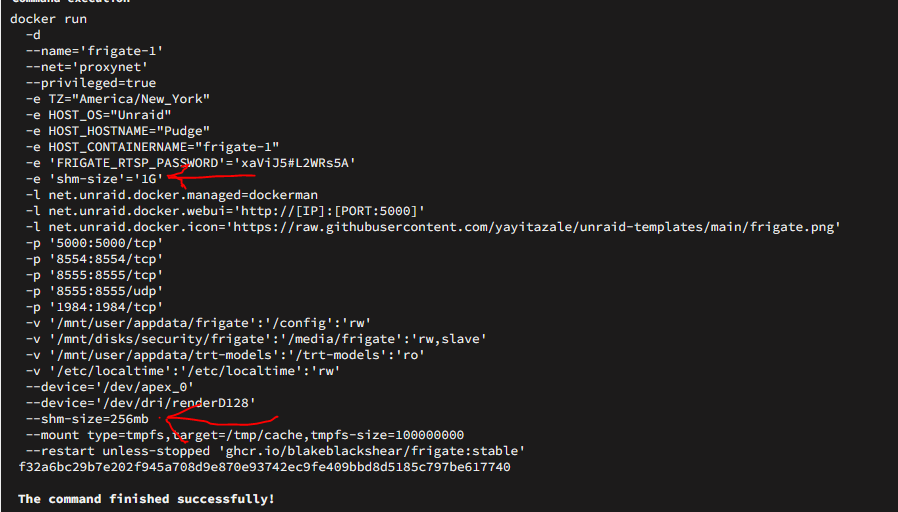

Hello all, I am upgrading to the 0.12 release, but i cannot increase the size of my SHM share. I've attempted to add a variable "shm-share"="1G" but there appears to be an override a the bottom "--shm-size=256mb". What am i doing wrong here? Also, shouldn't this be a variable in the default template anyways?1807565314_SHMoverride.PNG.1afb519d3fa5c29b756870398c176885.PNG
Edited by capnJiP
its under advanced settings (change the slider from basic view) under "Extra Parameters"
i've been looking for that all morning, thanks!
You have same IP on both rtsp connection to the camera on the go2rtc part and the restream config inside the camera config. The first one must be the IP of the camera, the second one must be the IP of the unraid server. Please check out, one of them is not correctly configured.

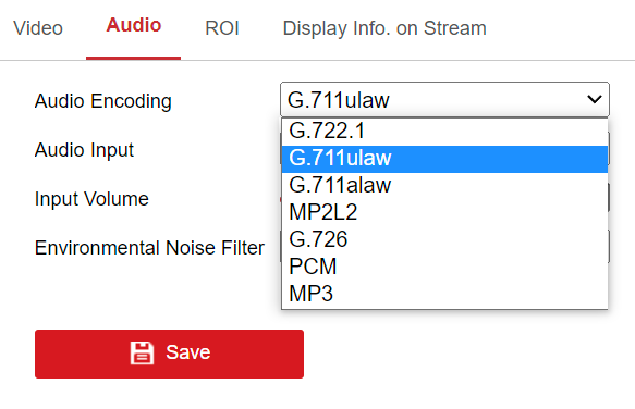

I am trying to get audio working in the latest release.  my camera does not support AAC which is the best option to choose?
