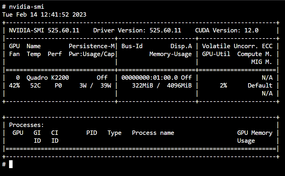

19 minutes ago, yayitazale said:
ok so added the below line
ffmpeg:
  hwaccel_args: -c:v h264_cuvid
however its still not using it
this is from the container but my dashboard on Unraid reports some activity
but my CPU usage has not dropped.
ffmpeg:

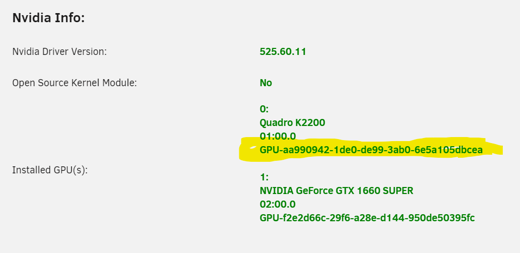

Are you launching the nvidia-smi inside or outside the container? Launch it on unraid's console.

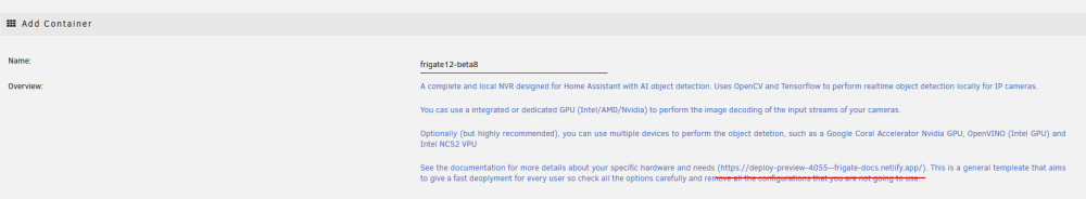

Hey there,
I'm using the beta8 Frigate docker, MQTT in docker, run HA in a VM also on unraid, and using Nvidia GPU for hardware acceleration.  All is working fine, couple of minor issues, but really liking this and dropped Shinobi, finally (!)
I'm curious if there are any additional steps or instructions to enable object detection using Nvidia GPU as opposed to CPU?  I don't have Coral but my vintage Xeons seem to be doing fine, would be great to offload to GPU though.
I see this in the docker: - If you want to use the NVidia TensorRT Detector, you have to add the tag suffix "-tensorrt" to the repository link, and create the models using the "tensorrt-models" app from the CA app.

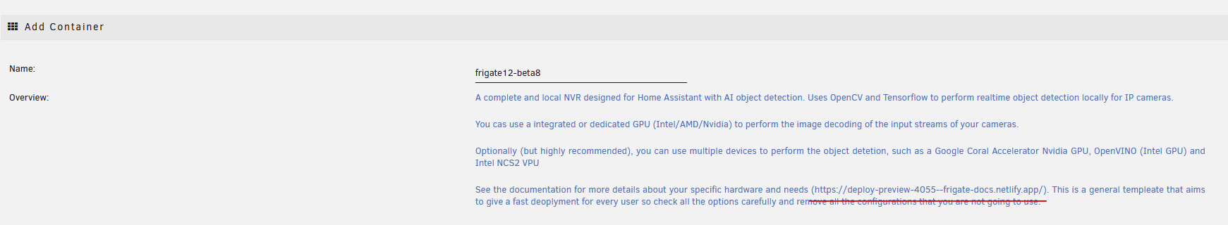

So would the steps be more or less as follows?
1) Get the tensorrt-models and follow the instructions as listed there
2) Change repository on Frigate from ghcr.io/blakeblackshear/frigate:0.12.0-beta8 to ghcr.io/blakeblackshear/frigate:0.12.0-beta8-tensorrt
(note - is it beta8 or beta2?)
Is that it?  Do I need to add anything else to my Frigate config?  In this link it states "Note: There is no support for Nvidia GPUs to perform object detection with tensorflow. It can be used for ffmpeg decoding, but not object detection."
Thanks very much!
Edited by chrispcrust

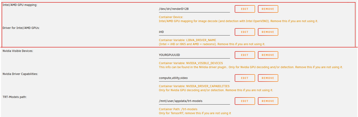

5 hours ago, chrispcrust said:
Hey there,
Thanks very much!

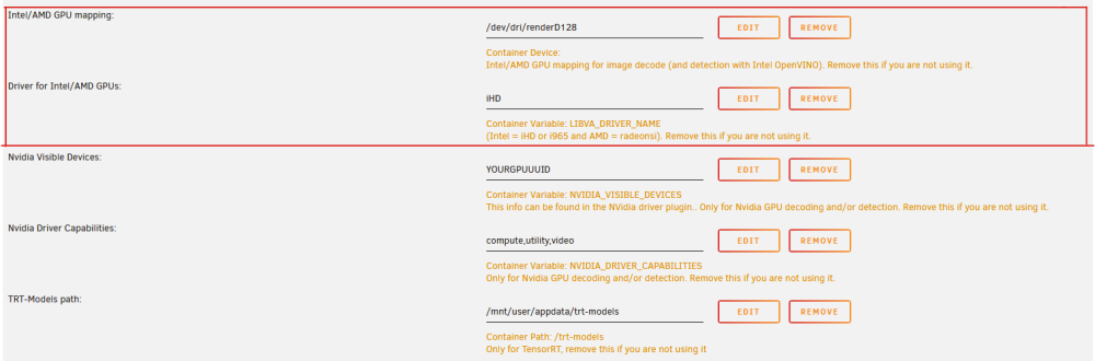

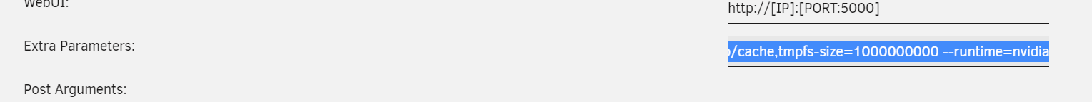

Steps are almost correct but you also need to add the extra parameter "--runtime=nvidia", then fill the Nvidia entries of the template. You can also delete the intel/amd gpu entries if you are also going to use the nvidia card itself for hardware accel (but you can split the load and let the nvidia card only do the detections).
Anyway, I just pushed a new version for the template to avoid mistakes on the step 2 of your list so for now on there will be a brach selector to make a easier deployment for regular/nvidia branches.
The docs are you refering are only for frigate 11. Frigate 12 betas docs are here: https://deploy-preview-4055--frigate-docs.netlify.app/ (this is also refered on the description of the template).

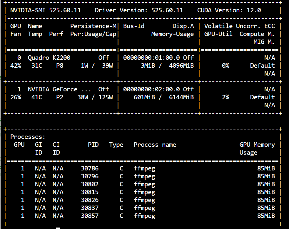

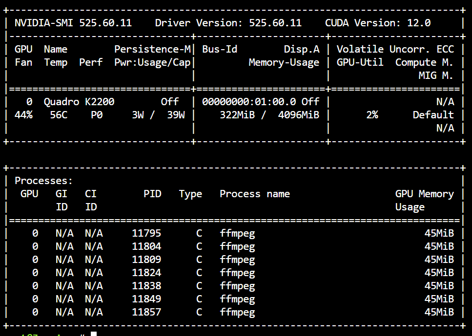

you are right i was looking in the container.  looking at unraid it is using it I think i was expecting it to stop using CPU but for some reason its still using CPU too.
Thank you so much!  I did get it set up on my one (test) camera, only going to be using it for 2 total, so shouldn't overload my 1060 3gb too bad :)
Really great documentation!  I can't say I know the first thing about object detection models, so I'm using default everything.. I'll report back with any feedback on performance.

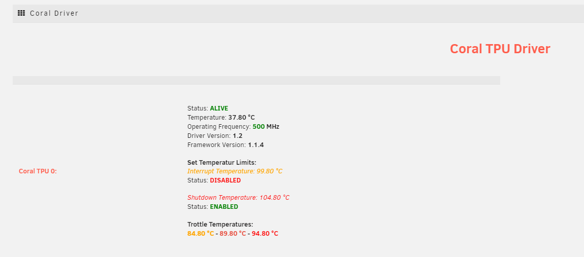

There are still a lot of processes going on behind the scenes that cannot be carried out by the GPU. You can test the CPU % difference between using or not the Hard Accel. Obviously you will see a difference but where there really is a substantial difference is in detection.
Thanks for the info suppose something is better then nothing I have a coral for my detection so i guess its the best it will get
I have a similar setup than yours (7 cameras, tpu and hard accel) and I have 20% of cpu usage more or less.
in that case mine is the same about 20% cpu makes me happy to know its all working correctly

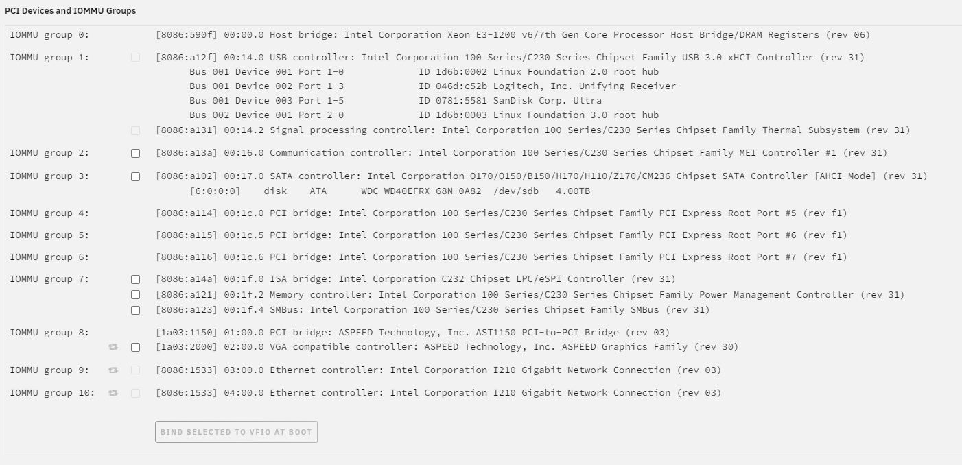

i switches the hardware today for my unraid server. Not i frigate does not work. The error:
docker: Error response from daemon: error gathering device information while adding custom device "/dev/dri/renderD128": no such file or directory.
But the driver is installed and i see this:
But und /dev/dri i see only this:
Someone has an idea?
tower-diagnostics-20230310-2254.zip
9 hours ago, Ironcurtain said:
/dev/dri/renderD128
This is the iGPU, but it is not activated, are you sure it's enabled in the BIOS and set to the first Display Device?
I only see your onboard Aspeed graphics in your Diagnostics and this is the card what you see in /dev/dri
If you want to pass through your Coral TPU you have to use in your specific use case (PCI based Coral TPU) this device path:
/dev/apex_0
I have an Asus P10S-I Board which has an integrated graphi controller from Aspeed. There is an i3 7100 on the board.
In the bios i can only enable vt-d and set the VGA Priority to Offboard or Onboard Device. But it makes no difference.
When i understand this threat correct, it is not possible to use the igpu with this board. But im pretty sure, that it worked in the past.
This is my output unter system devices:

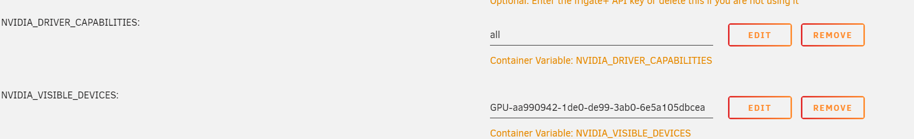

so after getting everything up and running I have added another GPU into my server to use with a VM.  so i have changed the config of my docker I have added the below
and then the following two parameters
I have added the correct ID for the GPU but for some reason its using the other GPU what have i done wrong?
