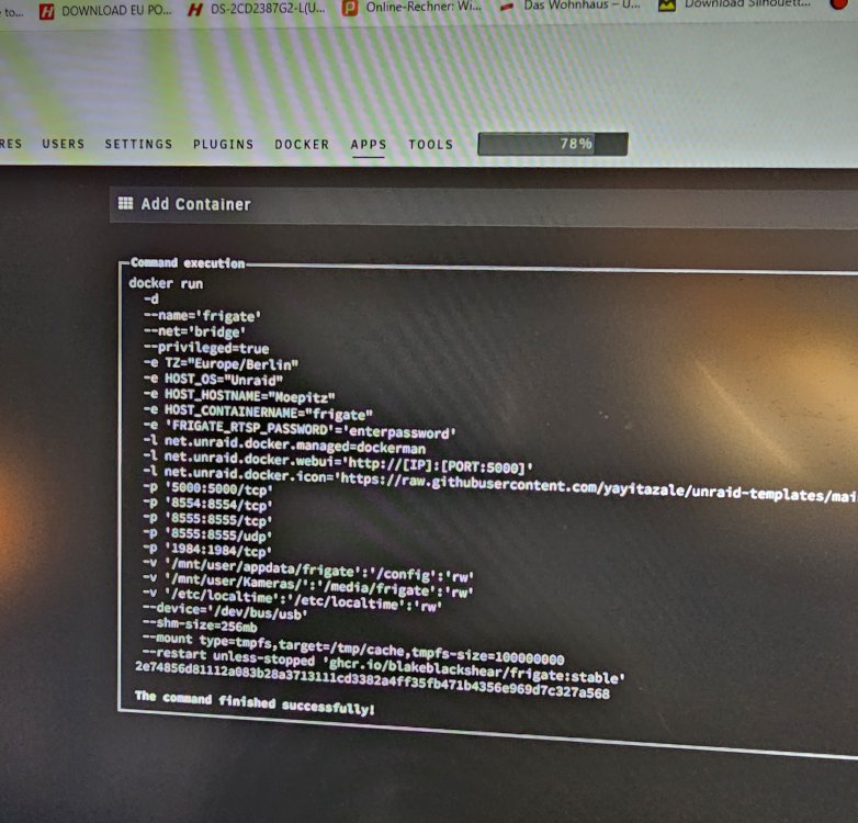

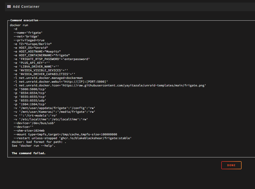

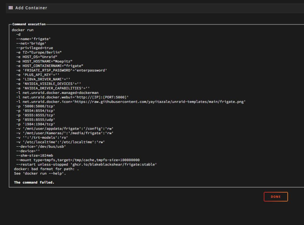

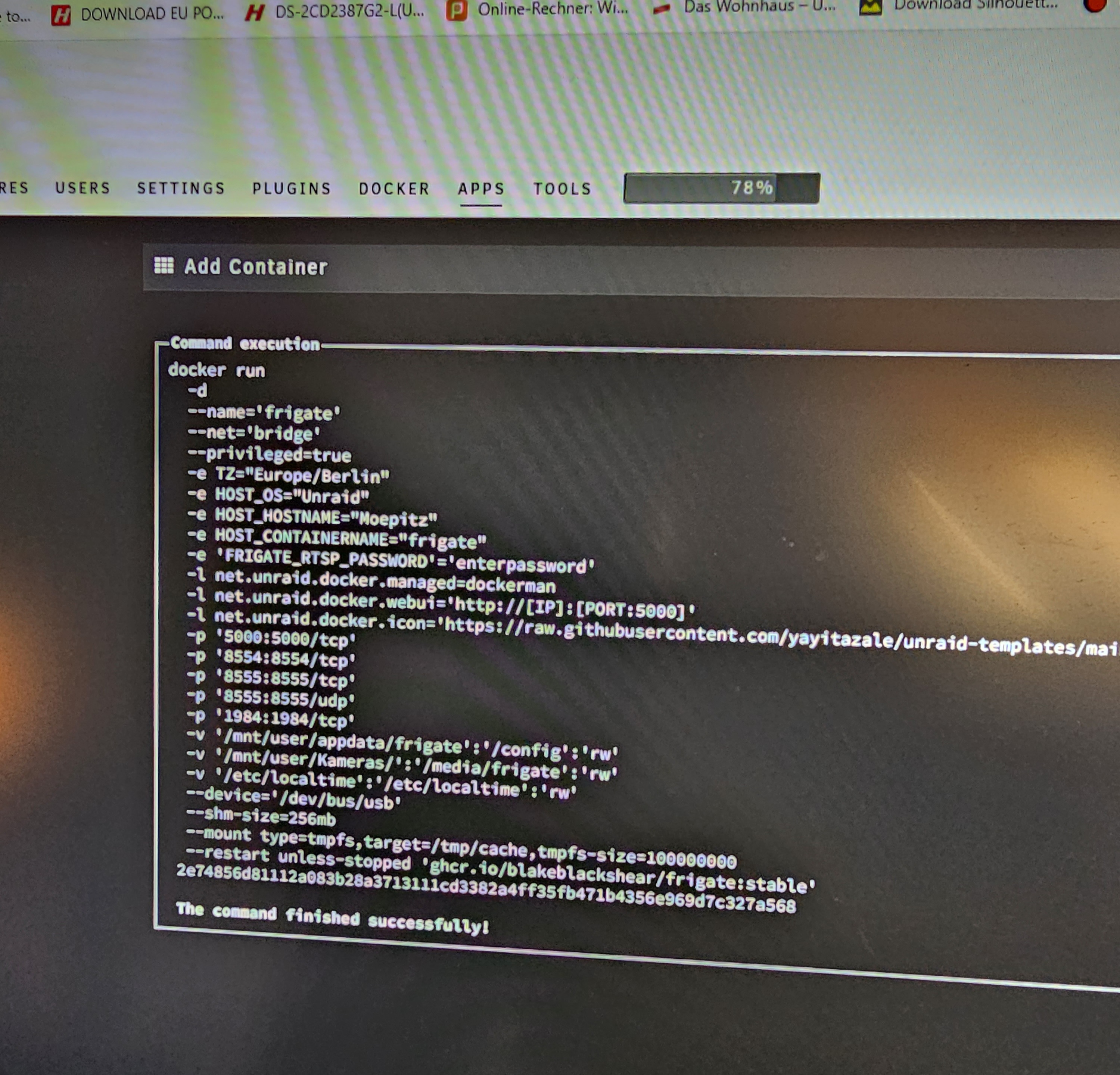

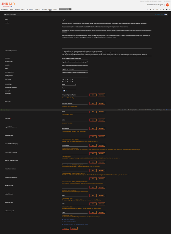

Today i wantet to switch to 0.12, i uninstalled the old docker, deleted the old files but now i'm having trouble to install the 0.12 version .... someone an idea what is wrong
Did you read the docs? You should remove all the entries of the template that you are not using.
Thank you for your answer.... yes i read the docs, and i think that i habe removed all the entries that iam not using.... look at the screenshot.... if i klick "done" with this template, it shows the fault obove....
192.168.1.9_Apps_AddContainer_xmlTemplate=default__tmp_community.applications_tempFiles_templates-community-apps_yayitazalesRepository_blakeblackshear-frigate-stable.xml.png
Ouch.... my fault.... I have to delete the whole argument, not only leave them empty 🤣🤣🤣 now it works👍
Okay. I might be stupid... Confirmed. I am stupid. I forgot to....check my privilege.....I'll see myself out now.

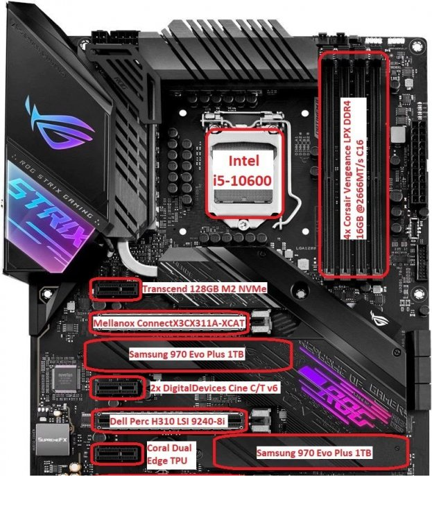

On 11/11/2022 at 12:07 PM, ich777 said:
This is really strange and sounds like some other issue with the BIOS and allocation itself since the Coral TPU doesn't even need Re-BAR but some manufacturers seem to struggle implementing it correct.
On my Asus Z490-E Gaming I can put it in whatever slot I want, see my configuration here:
Hi @ich777,
may I ask what adapter you are using for your dual edge TPU to be able to use it in PCIe? Are you able to access both TPU cores, or just one?
Greetings
Just one since both the adapter and also the physical interface is PCIe x1, otherwise you would need a PCIe x2 or better speaking a x4 interface (I don't know a motherboard with a PCIe x2 interface.
This one: Click
Please note that this adapter is meant for Wifi cards but if it's enough for you to use one TPU it will work fine, please don't connect the USB Adapter since most Wifi/Bluetooth combo cards are using PCIe for Wifi and USB for Bluetooth and no, you won't be able to get the second TPU to work over USB.
ATTENTION: You know that you have to make your own custom heat spreader for the Dual Edge TPU? If you don't do that this card will be a serious fire hazard <- this is also mentioned in the documentation (not the chip itself, the power regulation is most of the time the issue).
You can create your own heat spreader from something like a M2 NVME heat spreader and a few thermal pads.
I just wanted to point that out because this is very important!
