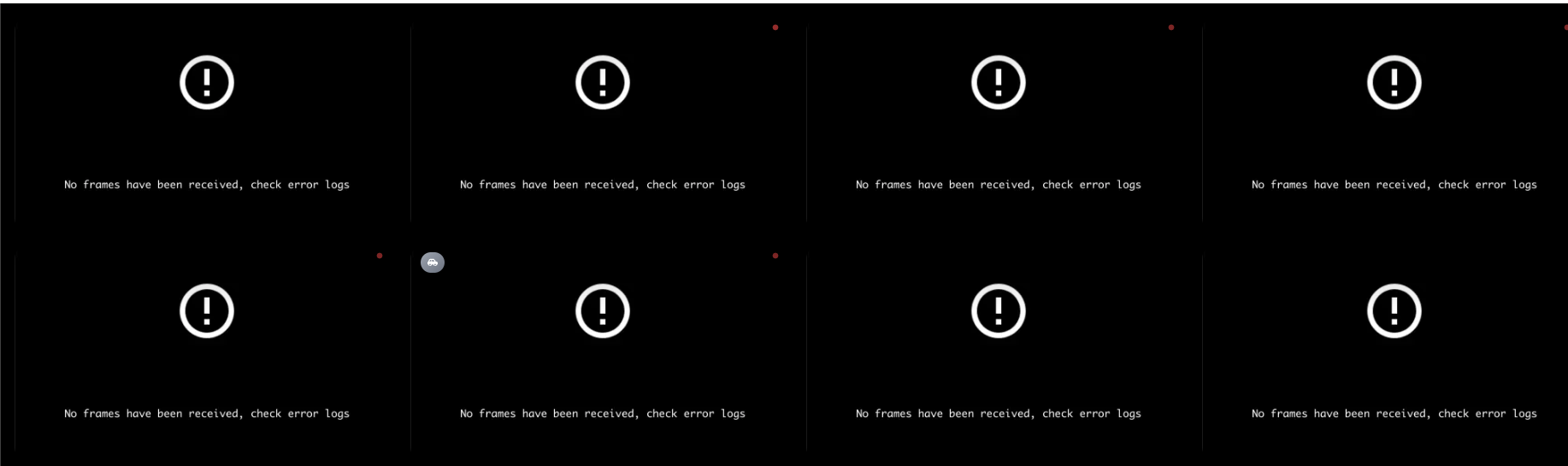

So I got that issue commented out, and I went through the breaking changes, and checked everything.  I also had RTMP in my config file, so I removed those.  But I keep getting ffmpeg errors now.  I never got them before the upgrade.  I'm not sure what could be different here that would cause the issue.
Before this I did have multiple streams from my cameras, and I read from a thread in 2022 that can cause issues, so I cut them all to 1 stream, but I'm still having the issue.
To clarify, I restart it and they ask work. Then this eventually happens. Sometimes it clears up again. It's mostly doing error saying ffmpeg can't be read.

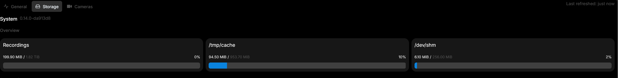

Did you change the SHM size?
Uhh did I miss that somewhere? I just went and looked and didn't see that in the docs.
I had just finished creating the issue in github and was coming back here to get your name so I could tag you.  I tagged you in it.
yes i do not know what a "SHM size" is

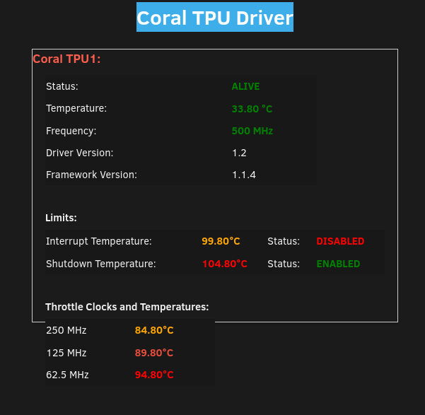

   I also see something that I don't know if it's true or not or should I look in to it. My google coral TPU is showing HOT! I don't know if it's the way unraid is reading it or if i have a problem .. My TPU is living in a 4U rack mount server that has a HELL of a lot of Air Flow. any thoughts?
https://docs.frigate.video/frigate/installation/#calculating-required-shm-size
You have to change clicking in "advanced view" of the container and going to the "Extra Parameters:".  In V14 I had to increase to double the size of the calculation in order to have stability in the system.
Edited by yayitazale
This is a known problem, and the temperature limits are there to avoid fire (yes, the catch fire). In you image your TPU ins in 33ºC so there is no problem at all, but if you reach the limits I suggest you to add a heatsink (and maybe a fan). Search in internet "heatsink coral tpu" and you will find some 3D printable solutions with 40mm fans.
see that is why you ask questions here ... thanks for the --shm-size= i set my system to --shm-size=1024mb
will see how that works .. and thanks about the TPU temp just seen the template out of place and though i had a problem ... Till you are better paid... THANKS JG

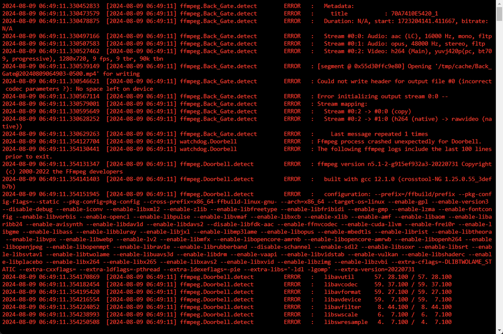

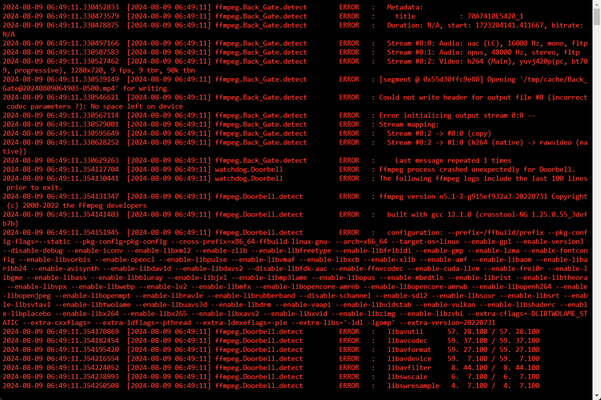

still getting errors

Hi
My system auto updated  last night, and it broke.
Is there a way that I can roll back to the previous version, will only take time to fix it on the weekend.
I normally roll back by changing the version
Repository:          ghcr.io/blakeblackshear/frigate:stable
2725180210410
2024-08-12 00:41:02.587349147  [2024-08-12 00:41:02] ffmpeg.Front.detect            ERROR   : [rtsp @ 0x557e96ad3200] DTS discontinuity in stream 0: packet 88 with DTS 82725180218592, packet 89 with DTS 82725180222966
2024-08-12 00:41:02.587362272  [2024-08-12 00:41:02] ffmpeg.Front.detect            ERROR   : [rtsp @ 0x557e96ad3200] DTS discontinuity in stream 1: packet 110 with DTS 82725180232536, packet 111 with DTS 82725180236569
2024-08-12 00:41:02.587375431  [2024-08-12 00:41:02] ffmpeg.Front.detect            ERROR   : [rtsp @ 0x557e96ad3200] DTS discontinuity in stream 1: packet 118 with DTS 82725180240550, packet 119 with DTS 82725180244442
2024-08-12 00:41:02.587388527  [2024-08-12 00:41:02] ffmpeg.Front.detect            ERROR   : [rtsp @ 0x557e96ad3200] DTS discontinuity in stream 1: packet 123 with DTS 82725180244445, packet 124 with DTS 82725180248625
2024-08-12 00:41:02.587402228  [2024-08-12 00:41:02] ffmpeg.Front.detect            ERROR   : Could not write header for output file #0 (incorrect codec parameters ?): No space left on device
2024-08-12 00:41:02.587479555  [2024-08-12 00:41:02] ffmpeg.Front.detect            ERROR   : Error initializing output stream 0:0 --
2024-08-12 00:41:02.587530777  [2024-08-12 00:41:02] ffmpeg.Front.detect            ERROR   :
2024-08-12 00:41:02.609130964  [2024-08-12 00:41:02] watchdog.Back_Gate             ERROR   : Ffmpeg process crashed unexpectedly for Back_Gate.
2024-08-12 00:41:02.609182958  [2024-08-12 00:41:02] watchdog.Back_Gate             ERROR   : The following ffmpeg logs include the last 100 lines prior to exit.
2024-08-12 00:41:02.609223542  [2024-08-12 00:41:02] ffmpeg.Back_Gate.detect        ERROR   : [rtsp @ 0x5638f9de1200] DTS discontinuity in stream 1: packet 25 with DTS 82725180153142, packet 26 with DTS 82725180156366
2024-08-12 00:41:02.612314508  [2024-08-12 00:41:02] ffmpeg.Back_Gate.detect        ERROR   : [rtsp @ 0x5638f9de1200] DTS discontinuity in stream 1: packet 59 with DTS 82725180185160, packet 60 with DTS 82725180188461
2024-08-12 00:41:02.612374046  [2024-08-12 00:41:02] ffmpeg.Back_Gate.detect        ERROR   : [rtsp @ 0x5638f9de1200] DTS discontinuity in stream 1: packet 61 with DTS 82725180188462, packet 62 with DTS 82725180192621
2024-08-12 00:41:02.612414938  [2024-08-12 00:41:02] ffmpeg.Back_Gate.detect        ERROR   : [rtsp @ 0x5638f9de1200] DTS discontinuity in stream 1: packet 66 with DTS 82725180192623, packet 67 with DTS 82725180195698
2024-08-12 00:41:02.612450597  [2024-08-12 00:41:02] ffmpeg.Back_Gate.detect        ERROR   : Could not write header for output file #0 (incorrect codec parameters ?): No space left on device
2024-08-12 00:41:02.612486599  [2024-08-12 00:41:02] ffmpeg.Back_Gate.detect        ERROR   : Error initializing output stream 0:0 --
2024-08-12 00:41:02.612523645  [2024-08-12 00:41:02] ffmpeg.Back_Gate.detect        ERROR   :
2024-08-12 00:41:02.657231236  [2024-08-12 00:41:02] watchdog.Back_Yard             ERROR   : Ffmpeg process crashed unexpectedly for Back_Yard.
2024-08-12 00:41:02.657248049  [2024-08-12 00:41:02] watchdog.Back_Yard             ERROR   : The following ffmpeg logs include the last 100 lines prior to exit.
2024-08-12 00:41:02.657261678  [2024-08-12 00:41:02] ffmpeg.Back_Yard.detect        ERROR   : [rtsp @ 0x55d3578e5200] DTS discontinuity in stream 1: packet 9 with DTS 82725180146248, packet 10 with DTS 82725180151129
2024-08-12 00:41:02.657278294  [2024-08-12 00:41:02] ffmpeg.Back_Yard.detect        ERROR   : [rtsp @ 0x55d3578e5200] DTS discontinuity in stream 1: packet 22 with DTS 82725180159066, packet 23 with DTS 82725180163875
2024-08-12 00:41:02.657295330  [2024-08-12 00:41:02] ffmpeg.Back_Yard.detect        ERROR   : Could not write header for output file #0 (incorrect codec parameters ?): No space left on device
2024-08-12 00:41:02.657410871  [2024-08-12 00:41:02] ffmpeg.Back_Yard.detect        ERROR   : Error initializing output stream 0:0 --
2024-08-12 00:41:02.657412595  [2024-08-12 00:41:02] ffmpeg.Back_Yard.detect        ERROR   :
2024-08-12 00:41:02.666629606  [2024-08-12 00:41:02] watchdog.Doorbell              ERROR   : Ffmpeg process crashed unexpectedly for Doorbell.
2024-08-12 00:41:02.666671144  [2024-08-12 00:41:02] watchdog.Doorbell              ERROR   : The following ffmpeg logs include the last 100 lines prior to exit.
2024-08-12 00:41:02.666709829  [2024-08-12 00:41:02] ffmpeg.Doorbell.detect         ERROR   : [rtsp @ 0x55dd5aece200] DTS discontinuity in stream 0: packet 7 with DTS 82725180139632, packet 8 with DTS 82725180144202
2024-08-12 00:41:02.666745258  [2024-08-12 00:41:02] ffmpeg.Doorbell.detect         ERROR   : [rtsp @ 0x55dd5aece200] DTS discontinuity in stream 1: packet 16 with DTS 82725180147671, packet 17 with DTS 82725180150893
2024-08-12 00:41:02.666824125  [2024-08-12 00:41:02] ffmpeg.Doorbell.detect         ERROR   : [rtsp @ 0x55dd5aece200] DTS discontinuity in stream 0: packet 27 with DTS 82725180158936, packet 28 with DTS 82725180163225
2024-08-12 00:41:02.666826172  [2024-08-12 00:41:02] ffmpeg.Doorbell.detect         ERROR   : [rtsp @ 0x55dd5aece200] DTS discontinuity in stream 1: packet 33 with DTS 82725180163227, packet 34 with DTS 82725180167280
2024-08-12 00:41:02.666845224  [2024-08-12 00:41:02] ffmpeg.Doorbell.detect         ERROR   : Could not write header for output file #0 (incorrect codec parameters ?): No space left on device
2024-08-12 00:41:02.666877458  [2024-08-12 00:41:02] ffmpeg.Doorbell.detect         ERROR   : Error initializing output stream 0:0 --
2024-08-12 00:41:02.666911447  [2024-08-12 00:41:02] ffmpeg.Doorbell.detect         ERROR   :
2024-08-12 00:41:02.845500548  [2024-08-12 00:41:02] frigate.video                  ERROR   : Garage: Unable to read frames from ffmpeg process.
2024-08-12 00:41:02.845514498  [2024-08-12 00:41:02] frigate.video                  ERROR   : Garage: ffmpeg process is not running. exiting capture thread...
2024-08-12 00:41:03.570882335  [2024-08-12 00:41:03] frigate.video                  ERROR   : Doorbell: Unable to read frames from ffmpeg process.
2024-08-12 00:41:03.570955083  [2024-08-12 00:41:03] frigate.video                  ERROR   : Doorbell: Unable to read frames from ffmpeg process.
2024-08-12 00:41:03.570979592  [2024-08-12 00:41:03] frigate.video                  ERROR   : Doorbell: Unable to read frames from ffmpeg process.
2024-08-12 00:41:03.570995878  [2024-08-12 00:41:03] frigate.video                  ERROR   : Doorbell: Unable to read frames from ffmpeg process.
2024-08-12 00:41:03.571010611  [2024-08-12 00:41:03] frigate.video                  ERROR   : Doorbell: Unable to read frames from ffmpeg process.
2024-08-12 00:41:03.571022805  [2024-08-12 00:41:03] frigate.video                  ERROR   : Doorbell: Unable to read frames from ffmpeg process.
2024-08-12 00:41:03.571106520  [2024-08-12 00:41:03] frigate.video                  ERROR   : Doorbell: Unable to read frames from ffmpeg process.
2024-08-12 00:41:03.571159876  [2024-08-12 00:41:03] frigate.video                  ERROR   : Doorbell: Unable to read frames from ffmpeg process.
2024-08-12 00:41:03.571200191  [2024-08-12 00:41:03] frigate.video                  ERROR   : Doorbell: Unable to read frames from ffmpeg process.
2024-08-12 00:41:03.571238101  [2024-08-12 00:41:03] frigate.video                  ERROR   : Doorbell: Unable to read frames from ffmpeg process.
2024-08-12 00:41:03.571280379  [2024-08-12 00:41:03] frigate.video                  ERROR   : Doorbell: Unable to read frames from ffmpeg process.
2024-08-12 00:41:03.571395803  [2024-08-12 00:41:03] frigate.video                  ERROR   : Doorbell: Unable to read frames from ffmpeg process.

2 hours ago, coltonc18 said:
tried that, a little bit ago, and just got the error again.
Don't know that's the only thing I can tell you that I did how big did you make it what number did you put in there how many cameras do you have
8 cameras on frigate right now, and set it to 1024.
Don't know I have 5 right now and my setting is 2048. As you can tell I just keep dumpling the number until it worked don't know if that's the right way or not but mine's working

Hello everyone,
I'm having an issue that I believe is related to the tmpfs for /tmp/cache.
The Frigate logs are throwing this warning:
frigate.record.maintainer      WARNING : Unable to keep up with recording segments in cache for tele-pole-pano. Keeping the 6 most recent segments out of 9 and discarding the rest...
I have 16 gigs of RAM, and Unraid dashboard shows not even 3 gigs of use. This server is only running 4 dockers: MQTT, ZWave, Frigate, and HASS.
here is the output of disk free:
I have the default extra parameter tmpfs:
--mount type=tmpfs,destination=/tmp/cache,tmpfs-size=1000000000
I'm assuming that tmpfs mounted to /run is where that is supposed to go?
If so, why is it only 128M in size?
Overall, this server pretty much never goes over 10% CPU usage on its 2700X, doesn't go over 3 gigs of the available 16, and doesn't use more than 10% of it's 512 gig nvme cache drive.
Edit:
In Frigate's UI, it's correctly showing that it has 1 gig of tmpfs. I'm guessing it is requesting that much, but there isn't that much available.
