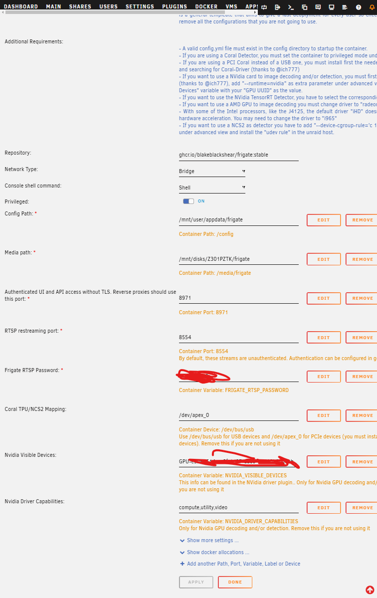

  • Hi @mathgoy, I've been using Frigate with an NVIDIA GPU.   to set it up, go the the docker template and add: --rm --runtime=nvidia to the "Extra Parameters".   Y

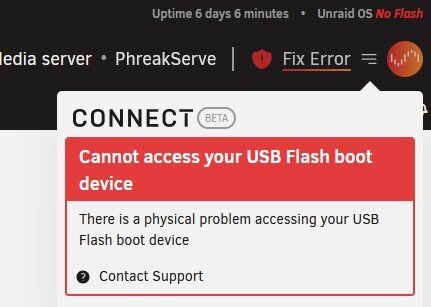

I can now reliably recreate the problem. I've taken down all dockers and VM's and got the same results twice. When I start Frigate, within 24 hours I get this error so it's got to be the Frigate docker or something it's contributing to. I'm willing to help, but it takes me about an hour to remove the server, fix the USB error, install and bring up the server and of course 16 hours for the parity check. If there is a log or some process I can check please let me know. I edited out the Tensor entries (as mentioned in another post), same outcome.

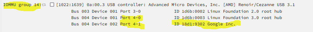

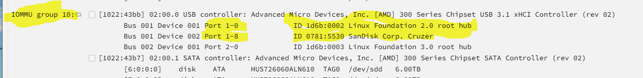

Are your Unraid boot flash drive and the Coral TPU on the same USB controller/hub?  If so, move your flash drive to a different controller.  (A USB 2.0 port for the flash would likely work, as the Coral should be in a USB 3.0 port)
I have a feeling that the Coral may be temporarily going off line (the USB controller/hub dropping connection).  There have been a number of posts across the Internet with folks having issues with this, and I have seen it in my Unraid syslog as well.  If your boot flash is on the same controller, and the hub drops out, Unraid will not automatically pick it back up in the same, correct state needed.
On the Coral issue, some folks report it is the USB cable supplied with the TPU that is at fault.  They replaced with a better quality cable, and issue was resolved.
Edited by ConnerVT
As a follow up, it would be better to make sure the boot flash and Coral TPU are even on different USB controllers.
If you go to Tools > System Devices, you can see where things are connected.  Here is my server running Frigate:

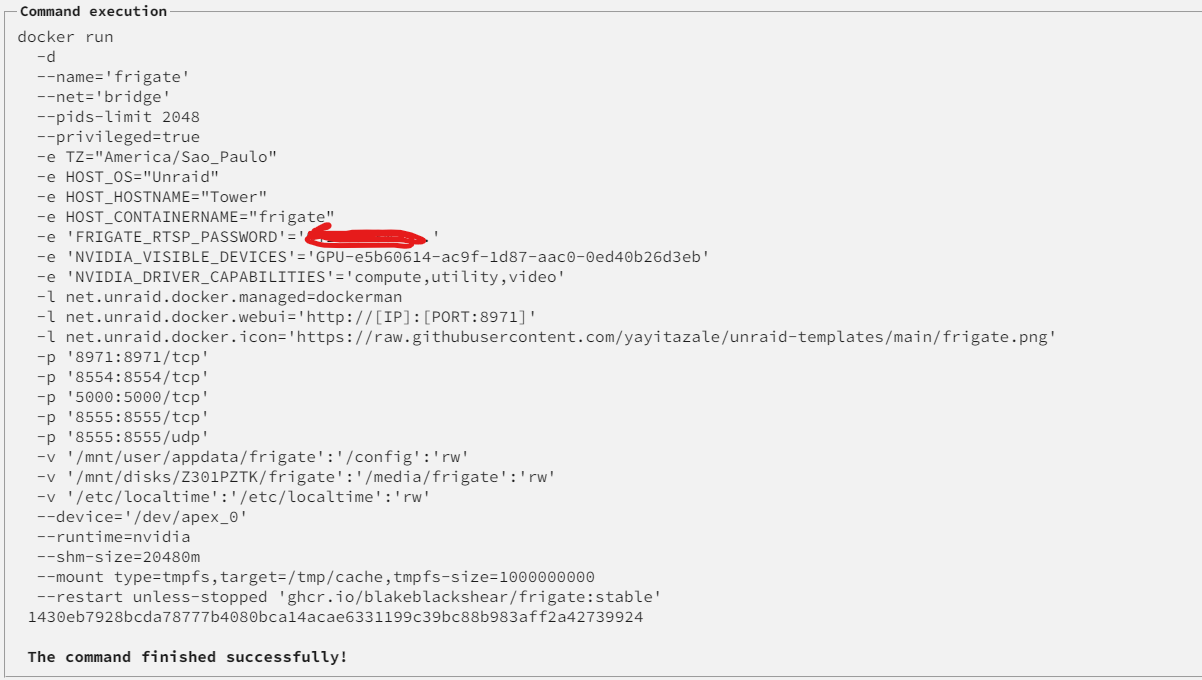

Hello. Good evening everyone! I have a problem with the Frigate. I had it working perfectly, but today I went to update, and installed the FolderView app, and after that my frigate broke. I already deleted and reinstalled everything and it didn't solve the problem. It now keeps giving an error and filling up the shm (mine is currently at 2048m). I would like some help if possible.

version: 0.14
2024-11-18 23:16:44.494305202  --- Logging error ---
2024-11-18 23:16:44.500808895  Traceback (most recent call last):
2024-11-18 23:16:44.500878115    File "/opt/frigate/frigate/record/maintainer.py", line 524, in run
2024-11-18 23:16:44.500879575      asyncio.run(self.move_files())
10 hours ago, DiegoFLima said:
Olá. Boa noite a todos! Estou com um problema com o Frigate. Eu o tinha funcionando perfeitamente, mas hoje fui atualizar, e instalei o aplicativo FolderView, e depois disso meu Frigate quebrou. Já apaguei e reinstalei tudo e não resolveu o problema. Agora ele continua dando erro e enchendo o shm (o meu está atualmente em 2048m). Gostaria de uma ajuda se possível.

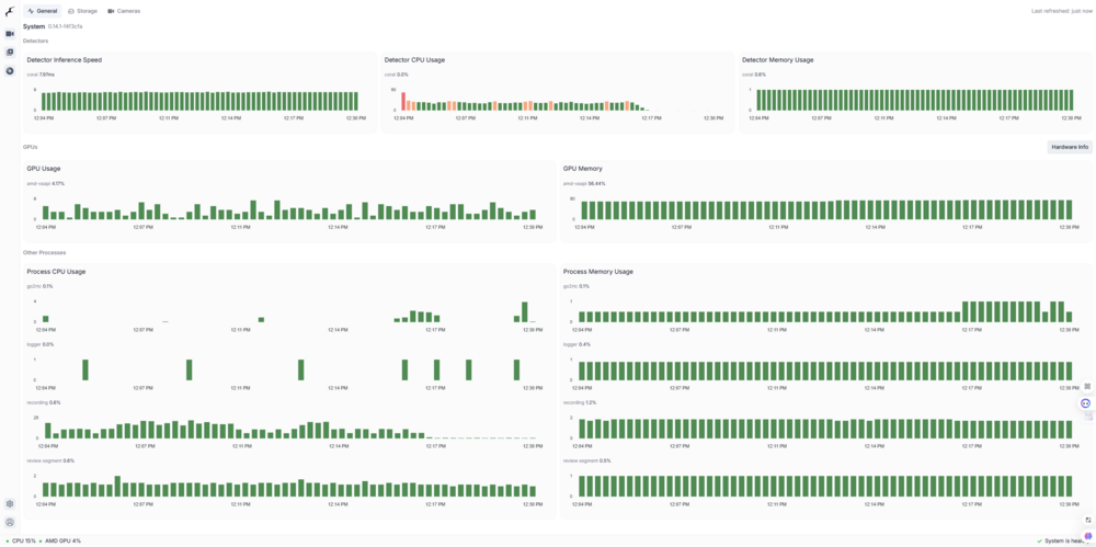

2024-11-18 23:17:20.060084410  [ERROR:[email protected]] global cap.cpp:164 open VIDEOIO(CV_IMAGES): raised OpenCV exception:
2024-11-18 23:17:20.060086710
2024-11-18 23:17:20.060088540  OpenCV(4.9.0) /io/opencv/modules/videoio/src/cap_images.cpp:274: error: (-215:Assertion failed) number < max_number in function 'icvExtractPattern'
2024-11-18 23:17:20.060089460
Did you change the codec to h265? Change it back to h264
I was already using h265 previously and it was working perfectly. my cameras are h265.
Ok so open a issue in github this is not related to unraid template: https://github.com/blakeblackshear/frigate/issues
I did the following.
I adjusted the config.yml file for only 1 camera, and Frigate worked completely.
After that I added 1 camera to 1 camera to the Frigate, managing to reach up to 5 cameras without any problems.
Now when I add the 6th camera, the errors start.
Is there a problem?
Is there a problem?
Did you test only with the last camera?
Anyway, is not possible to me to know your server capabilities, the usable resources...
I tested with each camera separately and home one worked properly. After that I added one by one and made combinations between them. Up to 5 works quietly. Now when you add the sixth camera, then the errors start.
I believe that there is no lack of resources on the server, because they worked correctly with 6 cameras before, and now that it is making an error.
Server amd epyc dual 7601 32 cores and 64 thread (64 cores and 128 thread total).
Google coral pci
Nvidia gforce 1060 ti 6gb
6 cameras ip hiseo h265 4k
Google coral pci
As I told you, please open a Issue in github. I'm not the developer of the project, I only maintain the unraid template and this is out of my knowledge.

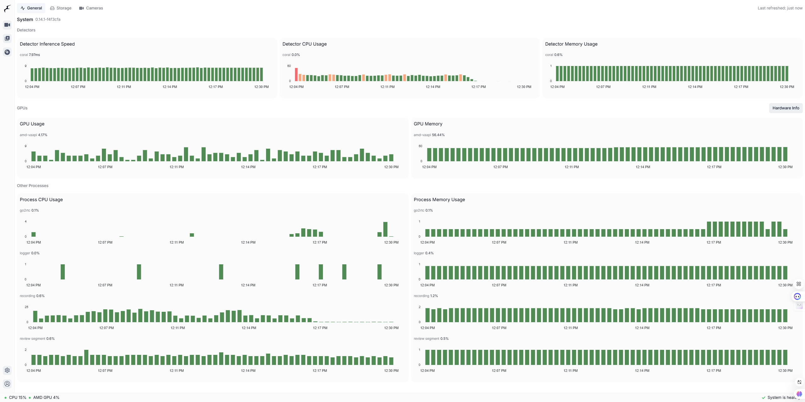

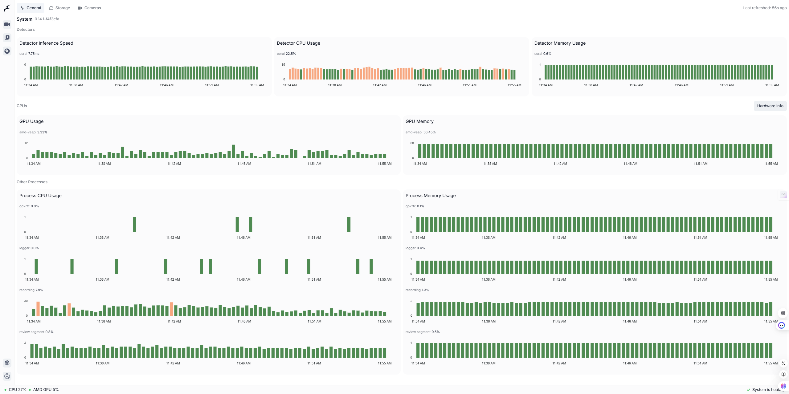

My unRAID server is running at 8-12% CPU without Frigate Docker running and 33% with it running.  If I recall it was closer to 20% before v14.
When I first opened the new Frigate UI, I noticed enable detect, recording, and snapshots icons for each camera were not highlighted so I clicked each of them thinking they'd need to be enabled.  I just unchecked them and my server is back to 15-20% CPU; however, it's not detecting and creating any alerts/recordings for motion.
Any ideas why such an increase in CPU increase with the updated Frigate v14?
With the detect, recording, and snapshots enabled in the UI for all cameras
With the detect, recording, and snapshots disabled in the UI for all cameras
Edited by bugsysiegals
How many cameras do you have? I don't know your settings and config but seem normal, this app is quite demanding.
