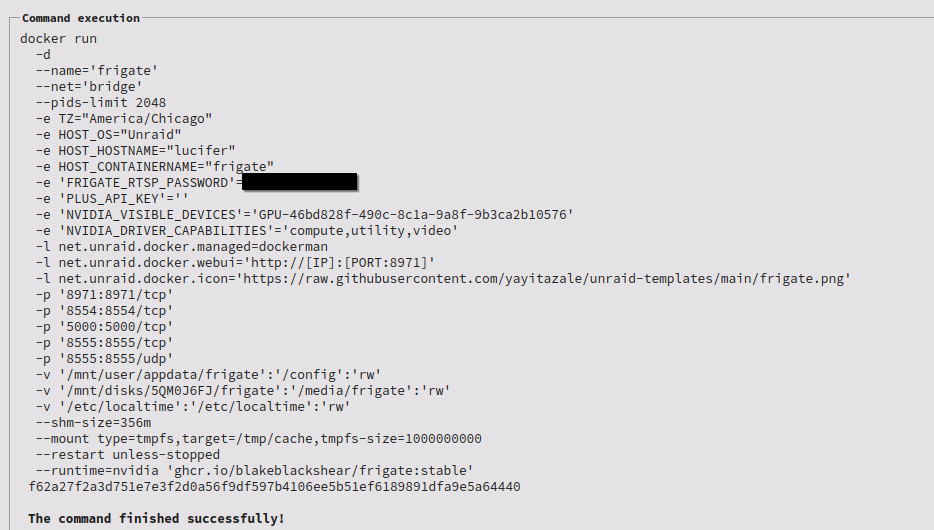

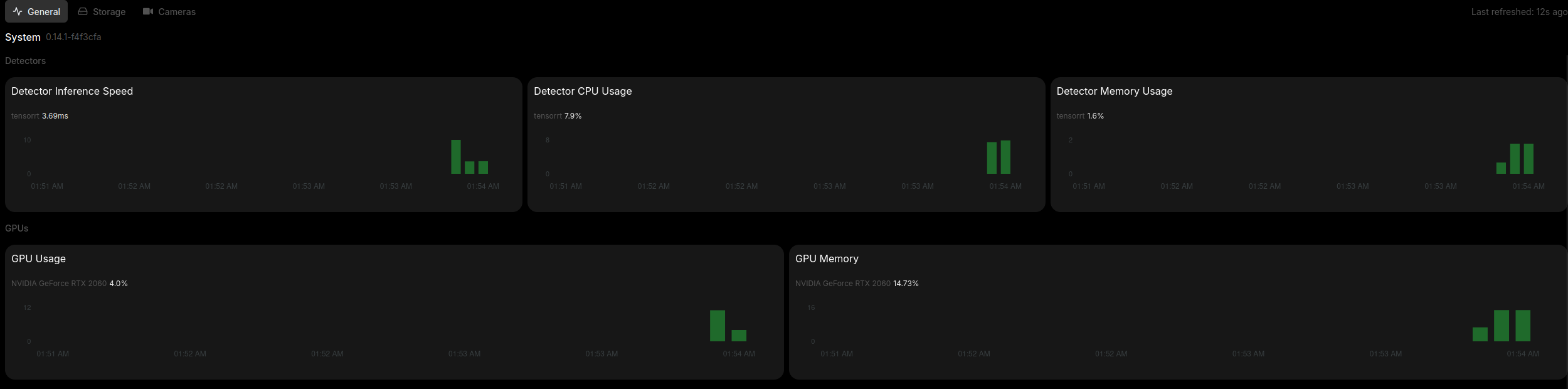

  • Hi @mathgoy, I've been using Frigate with an NVIDIA GPU.   to set it up, go the the docker template and add: --rm --runtime=nvidia to the "Extra Parameters".   Y

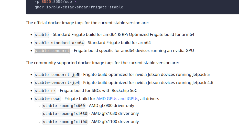

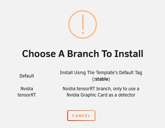

I just updated my Unraid from 6.9.2 to 6.12.4 and my Nvidia driver is now updated to 565.57.01. Below is my Docker Run command to build the container. What is missing, or do I need to change, in order for my card to show up and to be used for GPU object detection?
Please read again the description of the branches before the installation. You are using the default branch witch only uses GPU for Hardware Acceleration. If you want to use GPU for object detection there is another branch.
9 minutes ago, Professor Oak said:
Yes, you can select it when you launch the container from CA store:

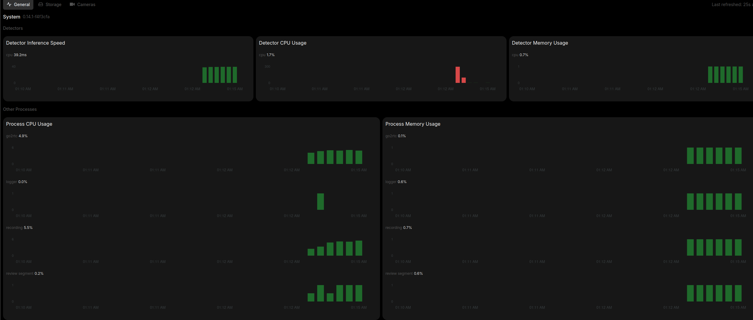

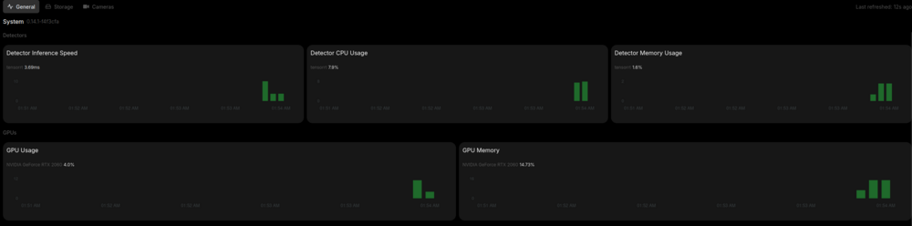

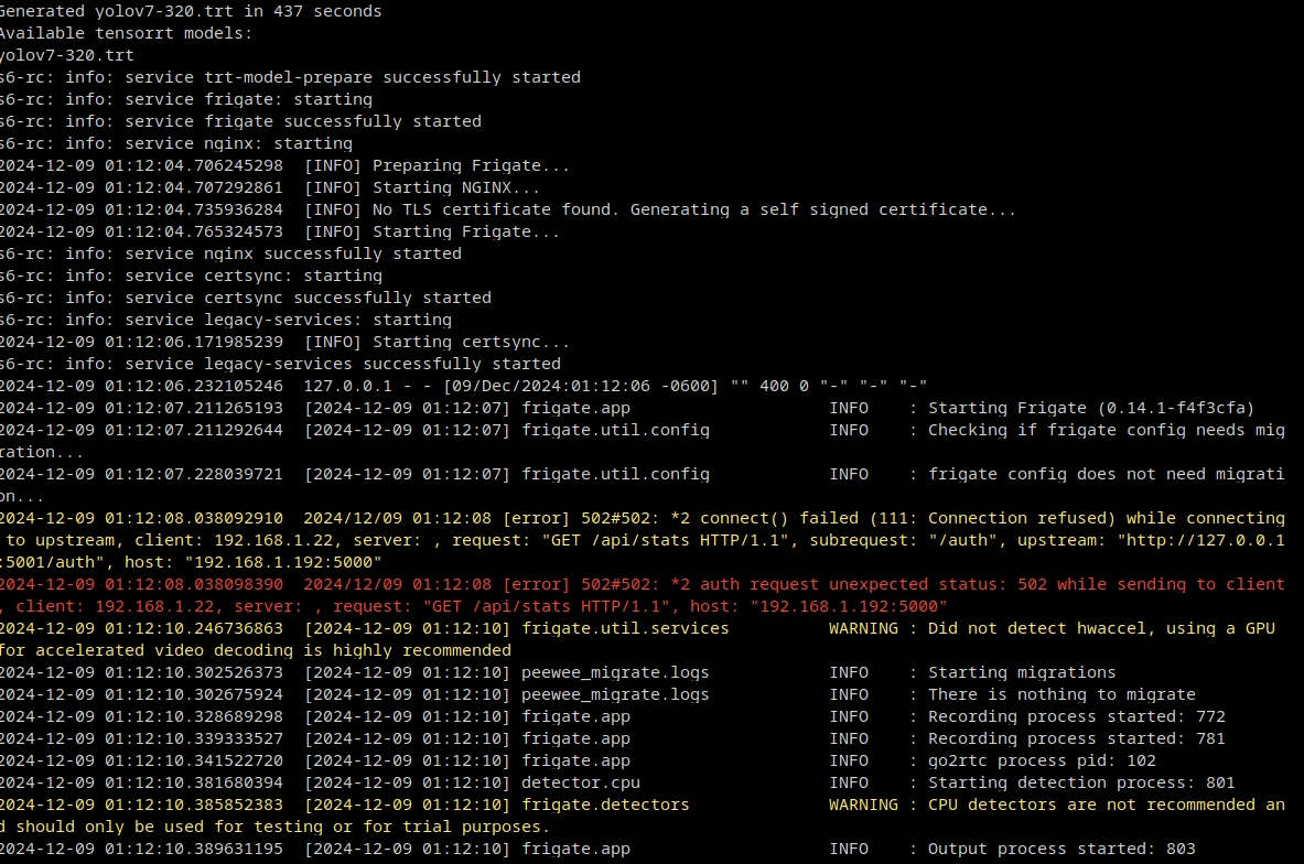

So it's now using the correct branch and shows the available tensorrt model in the startup logs, but it's still using CPU for object detection. Before I upgraded Unraid, the GPU would show up for HW acceleration in the system metrics, but it does not even appear there anymore after upgrading.
image.thumb.png.65c24a6ca36febaae10620763cdc29b6.pngimage.thumb.png.f3d201a59e11a2229b285e5c841bc3df.png
I think I finally got it! There were some additional configuration settings that I added in to set the detector type in the configuration file.

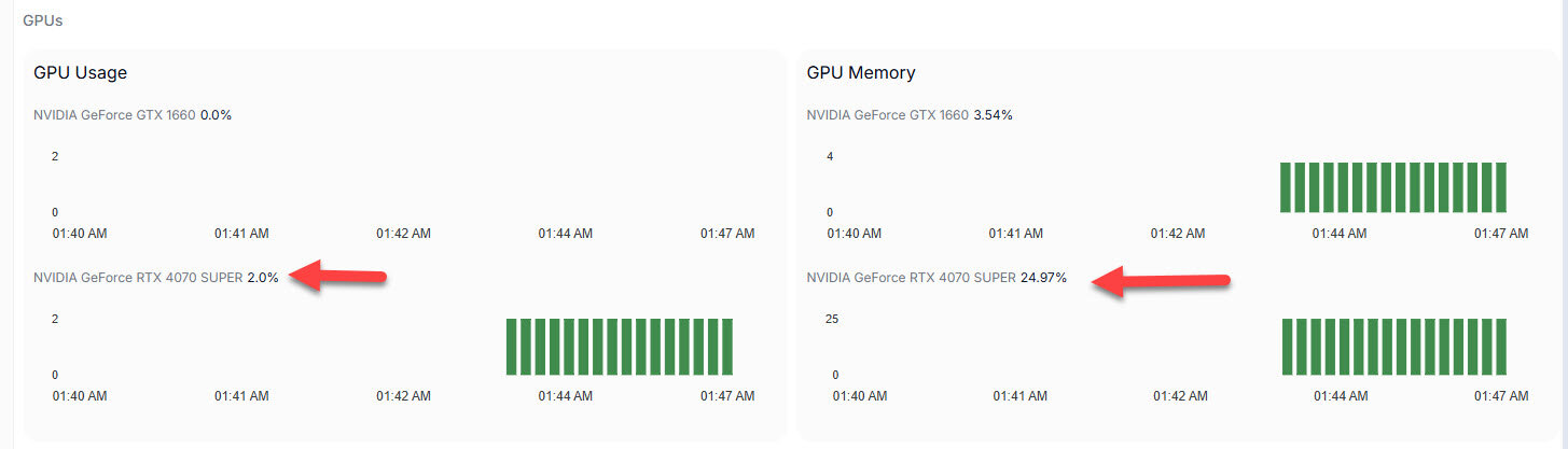

I have (2) GPUs installed on my unraid server: GTX 1660 and RTX 4070. I would like for Frigate to just use one, the GTX 1660. I have setup my parameters accordingly, but both GPUs keep showing up in the System Metrics.
docker run
  -d
  --name='frigate'
  --net='bridge'
  --privileged=true
  -e TZ="America/New_York"
  -e HOST_OS="Unraid"
  -e HOST_HOSTNAME="Tower"
  -e HOST_CONTAINERNAME="frigate"
  -e 'FRIGATE_RTSP_PASSWORD'='xxxxxxxxxxxxxx'
  -e 'NVIDIA_VISIBLE_DEVICES'='GPU-bdacb15e-0574-7cb8-db6e-5eb63d550e36'
  -e 'NVIDIA_DRIVER_CAPABILITIES'='compute,utility,video'
  -l net.unraid.docker.webui='http://[IP]:[PORT:5000]'
  -l net.unraid.docker.icon='https://raw.githubusercontent.com/yayitazale/unraid-templates/main/frigate.png'
  -p '5000:5000/tcp'
  -p '8554:8554/tcp'
  -p '8555:8555/tcp'
  -p '8555:8555/udp'
  -p '1984:1984/tcp'
  -p '8971:8971/tcp'
  -v '/mnt/user/appdata/frigate':'/config':'rw'
  -v '/mnt/user/Media/frigate':'/media/frigate':'rw'
  -v '/etc/localtime':'/etc/localtime':'rw'
  --device='/dev/bus/usb/'
  --shm-size=1024mb
  --mount type=tmpfs,target=/tmp/cache,tmpfs-size=1000000000
  --restart unless-stopped
  --runtime=nvidia 'ghcr.io/blakeblackshear/frigate:0.14.0-tensorrt'
6cff37359b8987a99e637657cc67ef72be2e9db04c866a132a2898a52334ee0f
The command finished successfully!

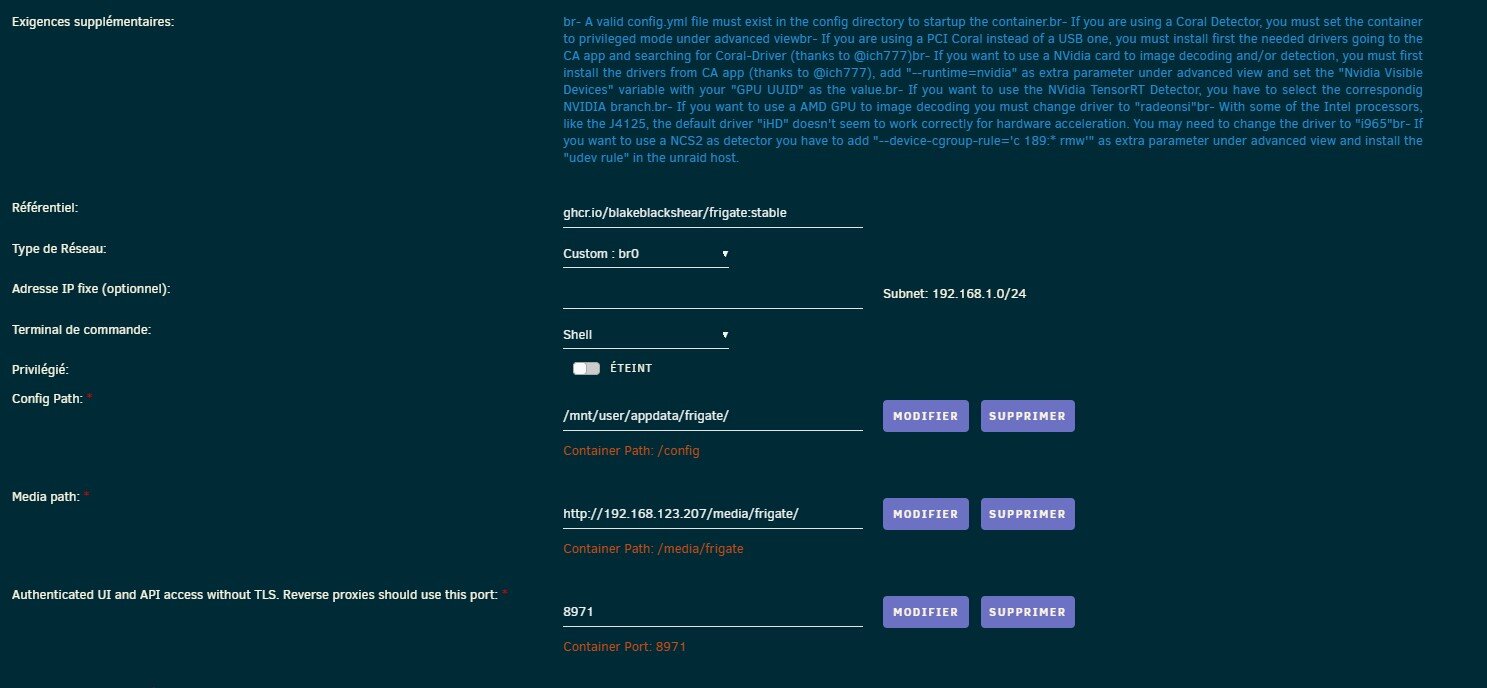

Hello, is it possible to change the image saving path with an http host?
Edited by sapphireone
