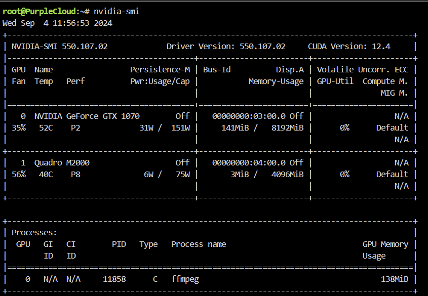

Hi, I installed a 2nd GPU in my machine (nvidia M2000) to take the load off my larger GPU, I updated the GPUID in the frigate container template but it's still using my original GPU, any idea what could be wrong here?
Are you launching the container in privileged mode? Try in not privileged mode first. Otherwise try adding a new environmental variable:
CUDA_VISIBLE_DEVICES=1
The value is the index of the GPU as seen by the container.
Edited by yayitazale
I actually abandoned the idea, turns out the M2000 barely uses less power than my GTX1070 when running frigate and compreface, 33W vs. 17W so I can't really justify having a separate GPU, really thought I'd be saving more energy

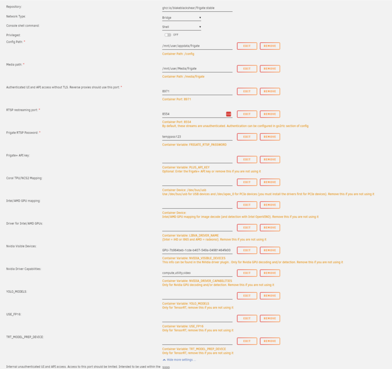

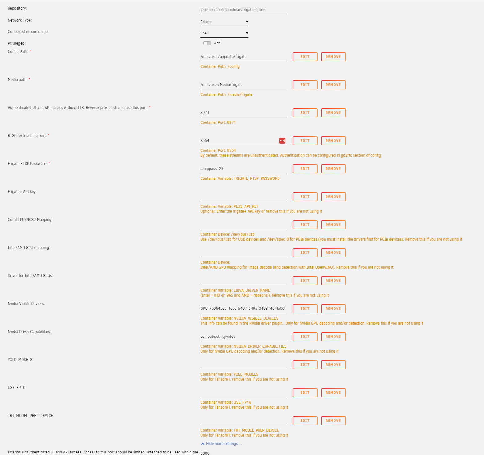

I'm probably doing something dumb - I had Frigate 0.14 working pretty well having just upgraded it from previous versions within Unraid's Docker Window, then I noticed the recommendation to delete and do a fresh install for 0.14 which I hadn't done - so I saved my config.yaml file and now I have a login screen which I didn't have previously?
The only change I made was to add a Frigate+ API key in the relevant field, but my Frigate+ login credentials return as invalid, though they work to sign me in the the Frigate+ website.
The other thing I notice is the "Authenticated UI and API access without TLS. Reverse proxies should use this port: 8971 - but I don't have a reverse proxy ?
The old HTTP port of 5000 is missing from the set up - should I add it back?
Edited by awediohead
more info
6 hours ago, awediohead said:
Update: OK so without changing anything in the set up file I changed the url to http and changed the port to 5000 so now it works, but when you choose the webui for Frigate you get 'bad request' - how to fix this please?

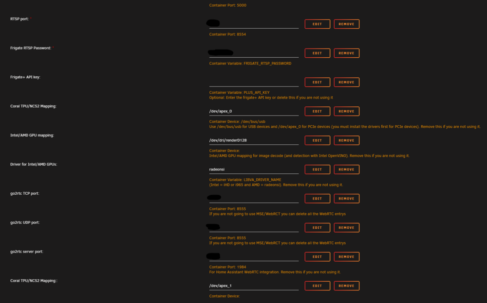

7 minutes ago, _cr8tor_ said:
Thoughts?
I may be wrong but I don’t think you can configure the same port (8555) as udp and tcp.
Its the default config options there, i did adjust it to 5556 for the udp and no change.
