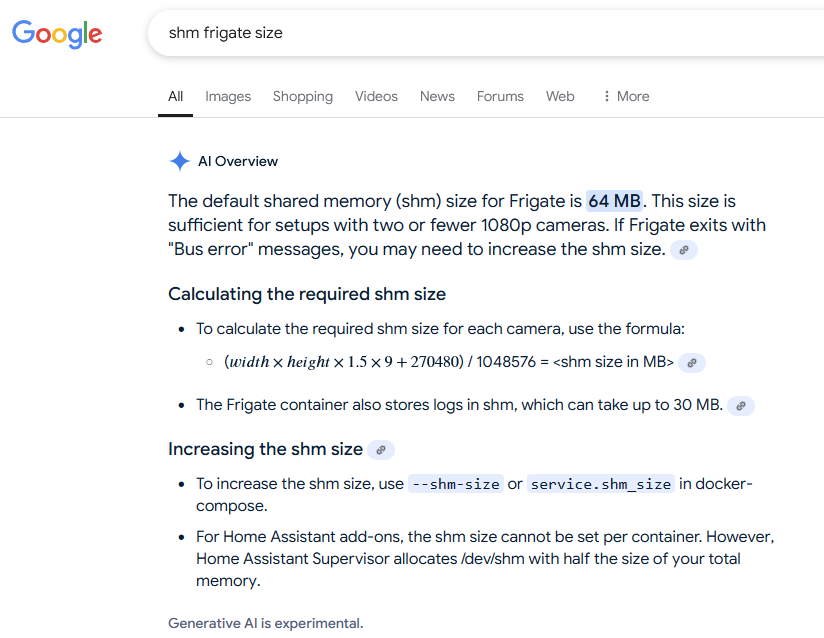

Hi, I'm not clear how to increase the SHM size in this unRaid docker. Can you please help?
The official doc shows to add it in docker compose config but I don't know how to do that in unRaid.
Thanks!

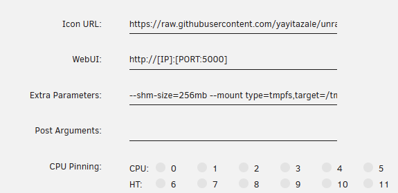

In Docker, click Frigate and Edit to open the template.
Select Advanced View (top right corner.
Add what you need in Extra Parameters.

What is the ideal calculation to find the best shm-size size anyone knows how to do the correct calculation?

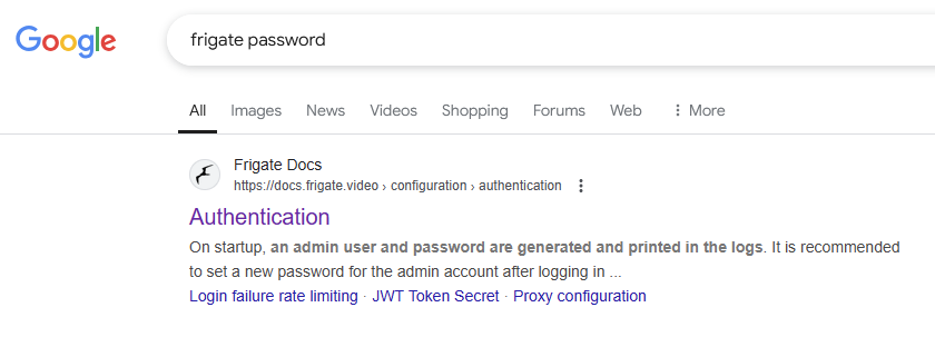

Where do I find default username/password? I've checked the logs and I haven't seen it. I searched forums and just find links to the manual which just states check log. I might have no idea which log to check as this is not mentioned, but I have checked several logs.

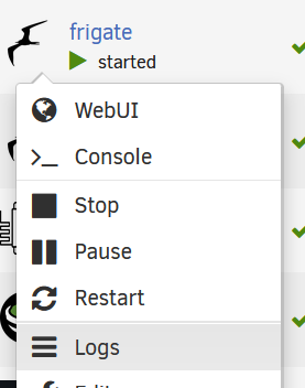

Thanks for the reply. This confirms at least that I am looking in the correct log. Now I guess I need to figure out why that information is not displaying in that log. I have tried uninstalling and reinstalling making sure to check that log as soon as I could change over to that screen but saw nothing indicating a password.
The container does seem to install correctly as I am able to load up the webUI with link, but this was after correcting the link to https://.

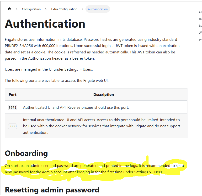

Try it with the password reset process described in the docs.
