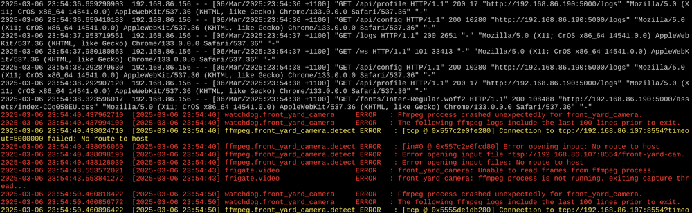

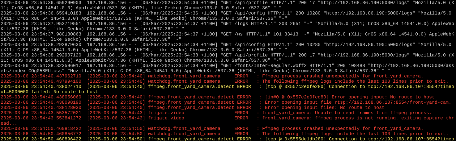

Hi Team,
I have had Frigate running with no issues for months until the latest release. Have read the changelog doc's but still couldn't get it back up and running.
Have removed and started from scratch with base config file from Frigate.
However when accessing WEBUI, I have to constantly refresh the page to get it to load any info. Have tried different devices and same issue.
Anyone got any suggestions as I am at a loss as to how to solve.

Frigate cannot connect to the camera feed.
Thanks @yayitazale appreciate that the camera feed isn’t working in this screenshot but as mentioned can’t get the UI to be responsive or even access to the configuration editor without refreshing screen 10 times.
I’m more keen to see if anything anomalous in the white nginx logs. thoughts? When I try and load a screen in the UI I just get black shell and the page details don’t actually load without refreshing multiple times.
when I have reverted to 0.14.1, nginx logs flow very to above
If you have only one camera feed setup and it is not able to connect to it, maybe it is restarting everything every few seconds so thats why you cannot access the UI corretly. Fix the conection to the camera first.

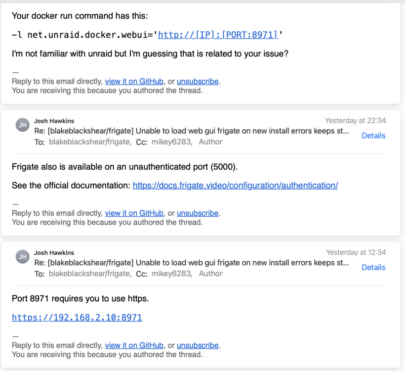

 Hi
 I been  on BlakesBlackshear  issue page . The issue i have now is that i am unable to connect to webui  8971 or 5000 my prefered port.  They seems it may be due to docker run command -l net.unraid.docker.webui='http://[IP]:[PORT:8971.  I tried to change the port : 5000 but the docker fails.  How can i change it to port :5000 or get  port: 8971  . how can i get HTTPS ://192.168.2 .XXX :8971 to be used in unraid (See comments (screenshot) ,
Hope that you can help.

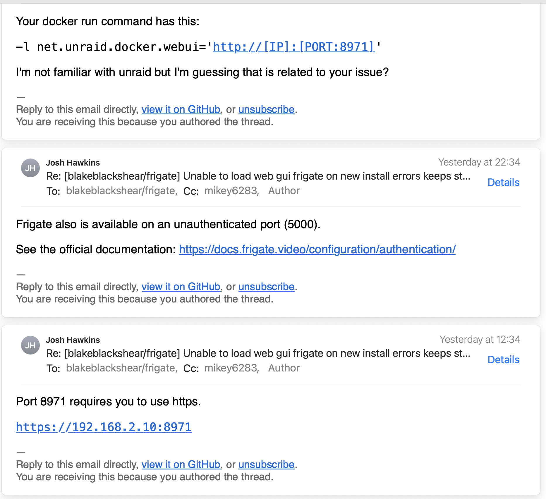

16 hours ago, mikey6283 said:
 Hi
The command is perfectly fine. If you want to access to port 5000, it is already added in the template (you can find it under "Show more settings"), so you do need to change anything, you just need to go to http://192.168.2.10:5000
For 8971 port, you should read this: https://docs.frigate.video/configuration/authentication
If you have issues you can disable TLS in the config.yml with:

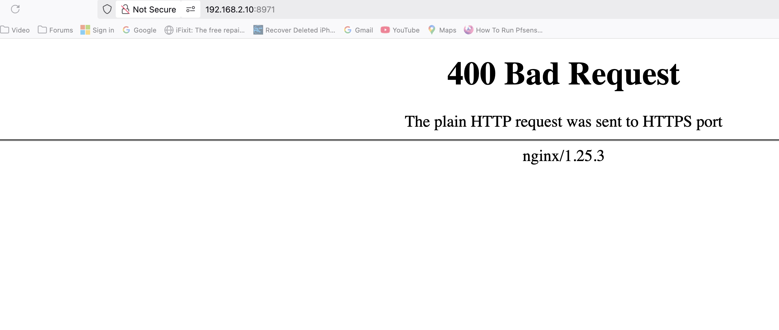

 I have disable TLS for  port: 8971 .

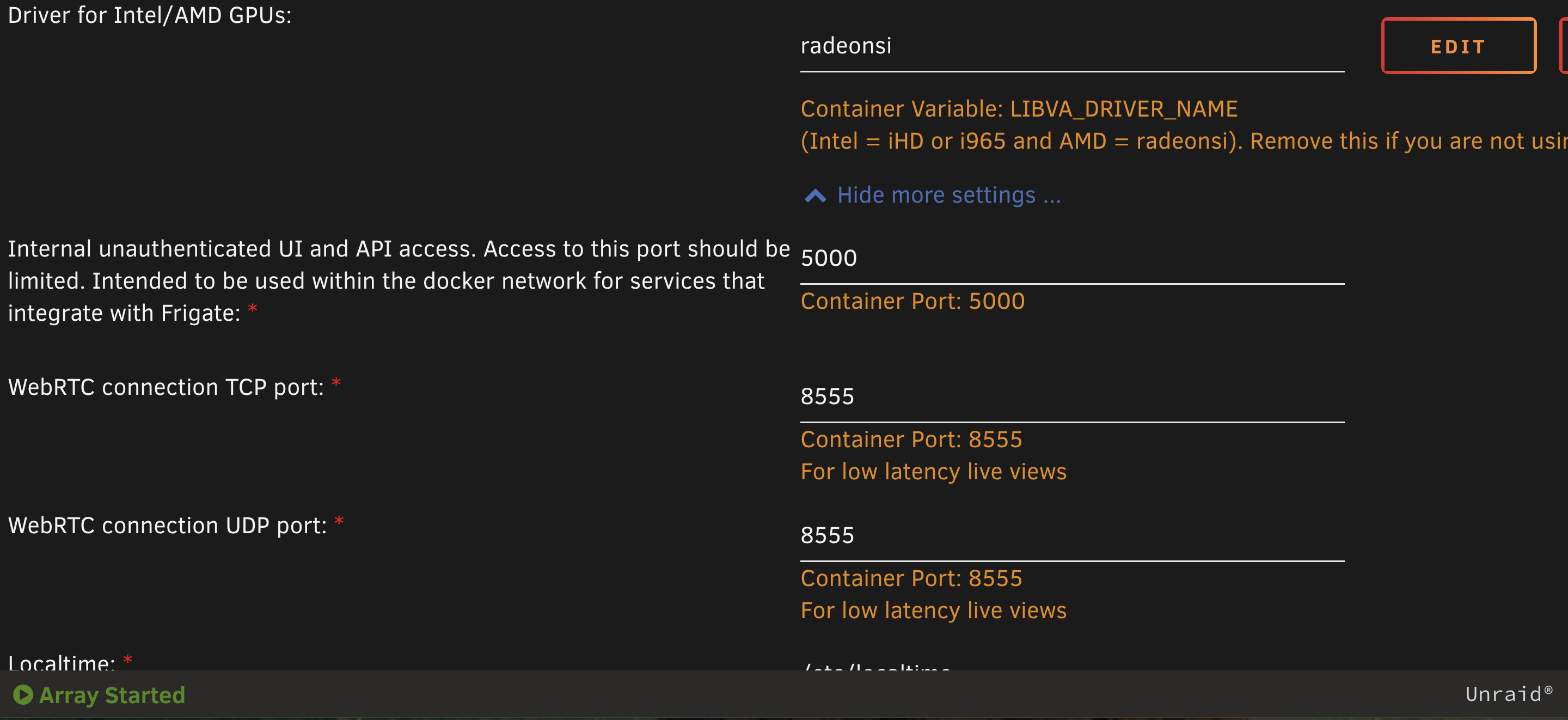

 How do i add the port:5000 from show setting do i just add a new Port with the same credentials, as i am getting the follow NGNIX error relating to the port:8971
You don't need to add anything. Just go to http://192.168.2.10:5000
For the TLS error, did you restarted the container after disabling TLS in the config?

 !   changed TLS to  False in config. restarted container and still get the NGINX error on port; 8971. This has been the issue all the time.
 Webui is no picking up port:5000. Copy of part of config. Container logs as of now:

I don't know what are you doing but this works just out of the box. If you have changed things then I canno't help you
 A few week ago I deleted frigate from unraid by removing the image templates and reinstalled a new template and started again and had these ever since.
 Will it be worth whle starting over again by removing everything regarding Frigate?
I noticed while reading the istallation of 0.15.0  that you have set a username/password is this correct to use port:8971 is that correct?
 I really do appreciate for help.
Port 5000 is still usable for webui but I don't think so will be like that in the future (will be used only for API). Using port 8971 will be a must for UI access, and this port has TLS and user/pass activaded by default. You can deactivate both by config, but at your own risk.
If you have issues with ports I suggest you to review your entire systems (as other dockers and VMs adn so) and for sure starting from scratch should help, as I told you access from port 8971 should work out of the box.

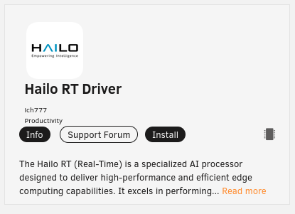

16 minutes ago, yayitazale said:
As far as I know, this card is only tested in the RPI.
These modules are supported on Unraid and there is also a plugin for that:
The Frigate GitHub also talks about amd64 with Hailo devices from what I saw.
The template doesn't need any change, as far as que the device is listed in the host
I'm not sure but I'm also not sure how the Frigate container works but the Hailo devices usually need the device like /dev/hailo0 and if you have multiple /dev/hailo1, /dev/hailo2,...
13 hours ago, jbattermann said:
Frigate added support for it with v0.15 (yay!) and I'm wondering if the Unraid <> Frigate container/app support those already?
Maybe but untested. :)
I only have a Halo 8L card but no time to test currently with Frigate, but I assume it should work. I can definitely tell you that other applications are working but please keep in mind that you have to select the correct firmware in the plugin that is compatible with Frigate.

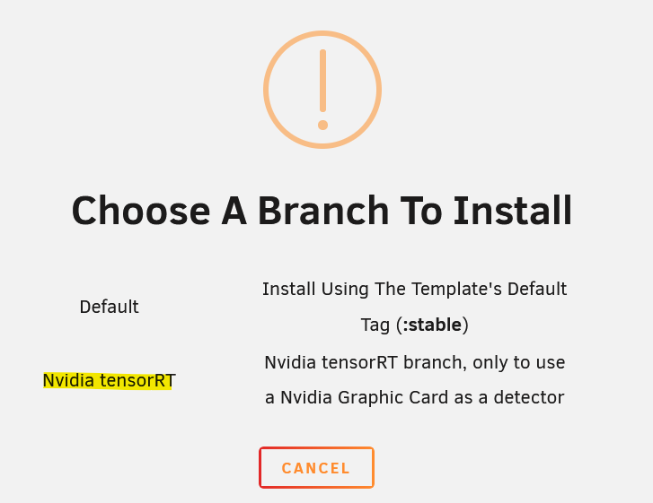

On 4/11/2025 at 10:40 PM, madmaxmk said:
Hello!
I would like to install Frigate so that object detection works via my GeForce RTX 4060. Unfortunately, it always works via the CPU.
Does anyone have a tip on how I can best do this?
Thanks in advance
It is everything explained in the additional requirements of the template:
You have to deploy Frigate using the TensorRT branch:
Then, add "--runtime=nvidia" as extra parameter under advanced view and set the "Nvidia Visible Devices" variable with your "GPU UUID" as the value (you have to install the nvidia driver from the store too, the plugin will give you this value).
Then, before launching the container, you should the follow the steps of https://docs.frigate.video/configuration/object_detectors#generate-models to decide witch yolo model you will use and change the "YOLO_MODELS" variable accordingly (and also check "USE_FP16" and "TRT_MODEL_PREP_DEVICE" variables.
You should prepare the config file with the required info as it is explained https://docs.frigate.video/configuration/object_detectors#configuration-parameters
And then you can deploy the container.
Edited by yayitazale
