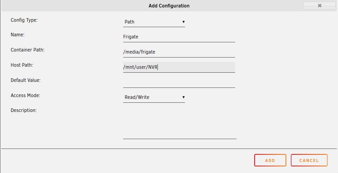

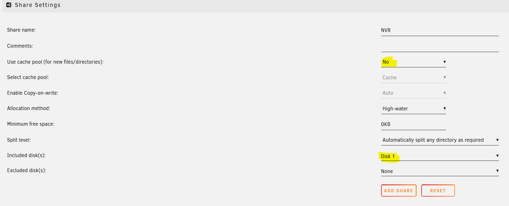

Ok, so if you want to avoid using SSD cache you just can add a path to mount the media folder onto a non cache share of unraid.
Create a new share on unraid and set the use of cache to "no", like this, including the disks you want to use to store NVR:
Be aware that this is going to increase a lot the write/reads on your disk, so I recomend you to use a proper disk to do this job (a WD purple series or so https://amzn.to/3e6UIjC (refered link)). You should config all your shares except the NVR one to not to use this disk and only use it to store NVR)
Then go to your hass container and edit it. You need to add a folder path and point the /media/frigate folder of the container to the non cache share, something like this:
Apply the change and now all the new media created on the /media/frigate folder on hass will be stored on that folder of unraid, skipping the cache disks.
Edited by yayitazale
Then go to your hass container and edit it. You need to add a folder path and point the /media folder of the container to the non cache share, something like this:
Apply the change and now all the new media created on the /media folder on hass will be stored on that folder of unraid, skipping the cache disks.
