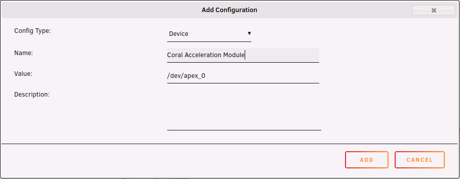

After seeing the great progress that was being made to get the Mini PCIe Coral working I bought one with an adapter to try my luck. It's not going as smoothly as I had hoped. Maybe someone here can point me in the correct direction or next steps to help debug
  • Unraid 6.9.1
  • Adapter I am using: Ableconn PEX-MP117 Mini PCI-E to PCI-E Adapter Card
  • Card correctly shows up in Unraid
  • I have installed "Coral Accelerator Module Drivers"
  • From terminal, if I run the below command I get a return suggesting the card is correctly installed
root@Tower:~# ls /dev/apex_0
/dev/apex_0
  • I have also checked lsmod and can see apex and gasket loaded
root@Tower:~/apex/packages# lsmod
Module                  Size  Used by
apex                   16384  0
gasket                 90112  1 apex
  • I have the card passed though to frigate container

EDIT: I think I got what is wrong here, you passed over a path to the container but it's a device:
7 hours ago, ich777 said:
I already built it for Unraid 6.9.1 Kernel v5.10.21 otherwise the the Plugin won't work on this Unraid version.
Thank you for correcting me. There goes that idea of why it isn't working
I double checked my mapping and it is a device. Removed and recreated it just to be 100% sure. Same results as before, "No EdgeTPU detected". I was really hoping I had missed this and you were right. The search goes on. 650146000_CoralAccelerationModule.jpg.c8877c3616455a01e229c755ae5640a2.jpg
The first screenshot that you postet shows "Container Path: ..." and not "Container Device: ..." this is something different I think...
EDIT: I will change how the Plugin installs the Logo so this will prevent the failure on the installation of the plugin on boot if no internet connection is available.

You don't need to pass in the device to the container.  It really is as simple as loading the plugin to get the drivers going and then telling Frigate to use it.
detectors:
  coral_pci:
    type: edgetpu
    device: pci
detectors:
  coral_pci:
    type: edgetpu
    device: pci
After reading this I really had high hopes this was everything I was doing wrong... No luck 😞
