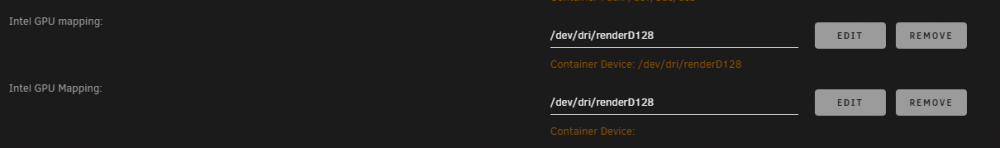

I just started to playing with this container and have some question.
First is about template.
I see this
I think is an error right?
Moreover do I need to add intel gpu mapping if I use coral usb?
I can't start container if /dev/dri... is added.
Edited by Jokerigno
I see this
Yes you are right, this is an error. I deleted the duplicated line, sorry about that.
The Intel/AMD GPU is only used for optimizing the performance of the FFMPEG image decoder using integrated GPU for hardware acceleration, reducing your CPU load.
The CORAL is used to offloading TensorFlow of the CPU. Is an order of magnitude faster and will reduce your CPU load dramatically.
https://blakeblackshear.github.io/frigate/configuration/optimizing
If you can't start the container maybe you don't have a hard. acc. compatible CPU, so you just can delete that record of the template and start it without hard. acc. FFMPEG and instead use your CPU to decode image. If you are using low number of cameras you'll not notice much difference.
Edited by yayitazale

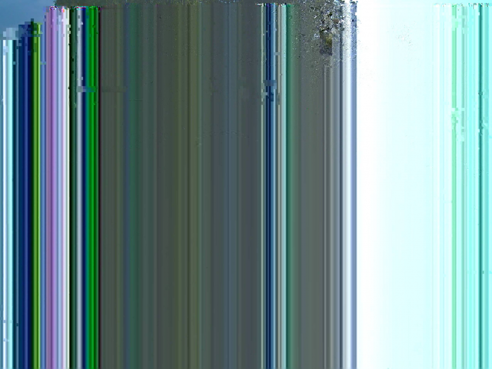

Hi All,
Considering moving from BI+Deepstack to Frigate so I installed that docker
First of all, thanks a lot for the work because I had it up and running in less than 10min. Installation was really ez.
Now I am running some few tests (CPU mode) and I have to say the detection is pretty good.
However, the whole thing will work for 10-15min and then I noticed some issues.
My camera stream becomes messy (see attached) and I have the errors below in the log (it's just an extract)
[h264 @ 0x562cc0734d00] left block unavailable for requested intra mode
[h264 @ 0x562cc0734d00] error while decoding MB 0 4, bytestream 954579
[h264 @ 0x562cc0734d00] error while decoding MB 0 114, bytestream 16535
[h264 @ 0x55fa44f00d00] error while decoding MB 158 17, bytestream -31
[h264 @ 0x55fa44f00d00] cabac decode of qscale diff failed at 109 2
[h264 @ 0x55fa44f00d00] error while decoding MB 109 2, bytestream 1134689
[h264 @ 0x55fa44f00d00] error while decoding MB 104 5, bytestream -9
[h264 @ 0x559eba2b6d00] error while decoding MB 115 13, bytestream -20
[h264 @ 0x559eba2b6d00] cabac decode of qscale diff failed at 19 66
[h264 @ 0x559eba2b6d00] error while decoding MB 19 66, bytestream 27113
[h264 @ 0x55dc86788d00] error while decoding MB 144 2, bytestream -31
[h264 @ 0x55dc86788d00] cabac decode of qscale diff failed at 55 50
[h264 @ 0x55dc86788d00] error while decoding MB 55 50, bytestream 40441
[h264 @ 0x556c09134d00] error while decoding MB 54 17, bytestream -21
The stream comes from a reolink camera and when I have a look on it in BlueIris, it is crystal clear
I believe this is an FFMPEG issuer but I have no idea how to fix it
Any idea what could be the issue?

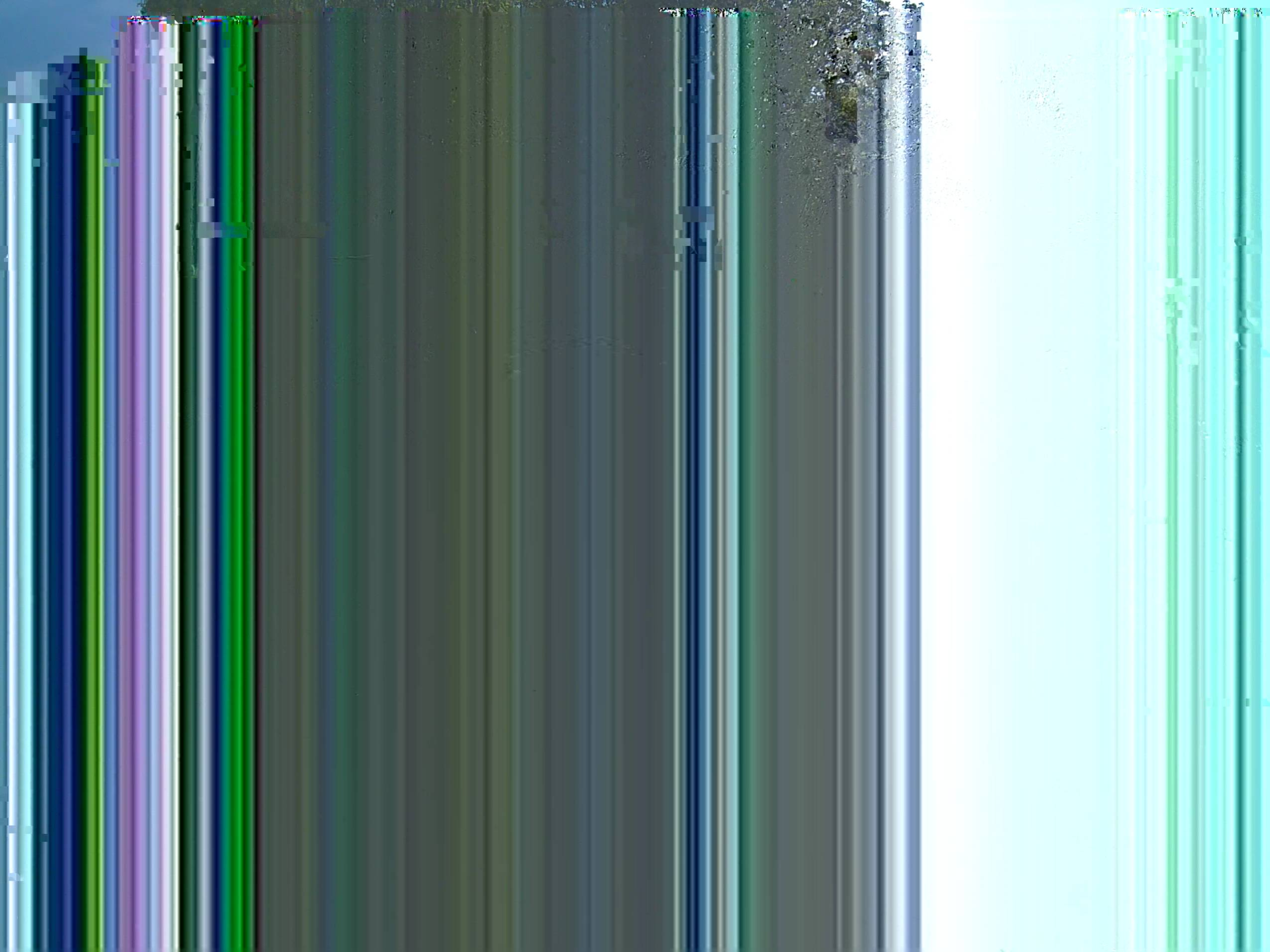

4 hours ago, mathgoy said:
Hi All,
After some further investigations, I found out that it's related to the Reolink Cameras I use.
It's recommended to use a RTMP stream instead of an RTSP.
For those who may have the same issue, here is the link format for RTMP streams on reolink cameras:
rtmp://IPADRESS/bcs/channel0_main.bcs?channel=0&stream=0&user=USER&password=PASSWORD
You will find below the block that worked for my Reolink camera (with the input_args)
