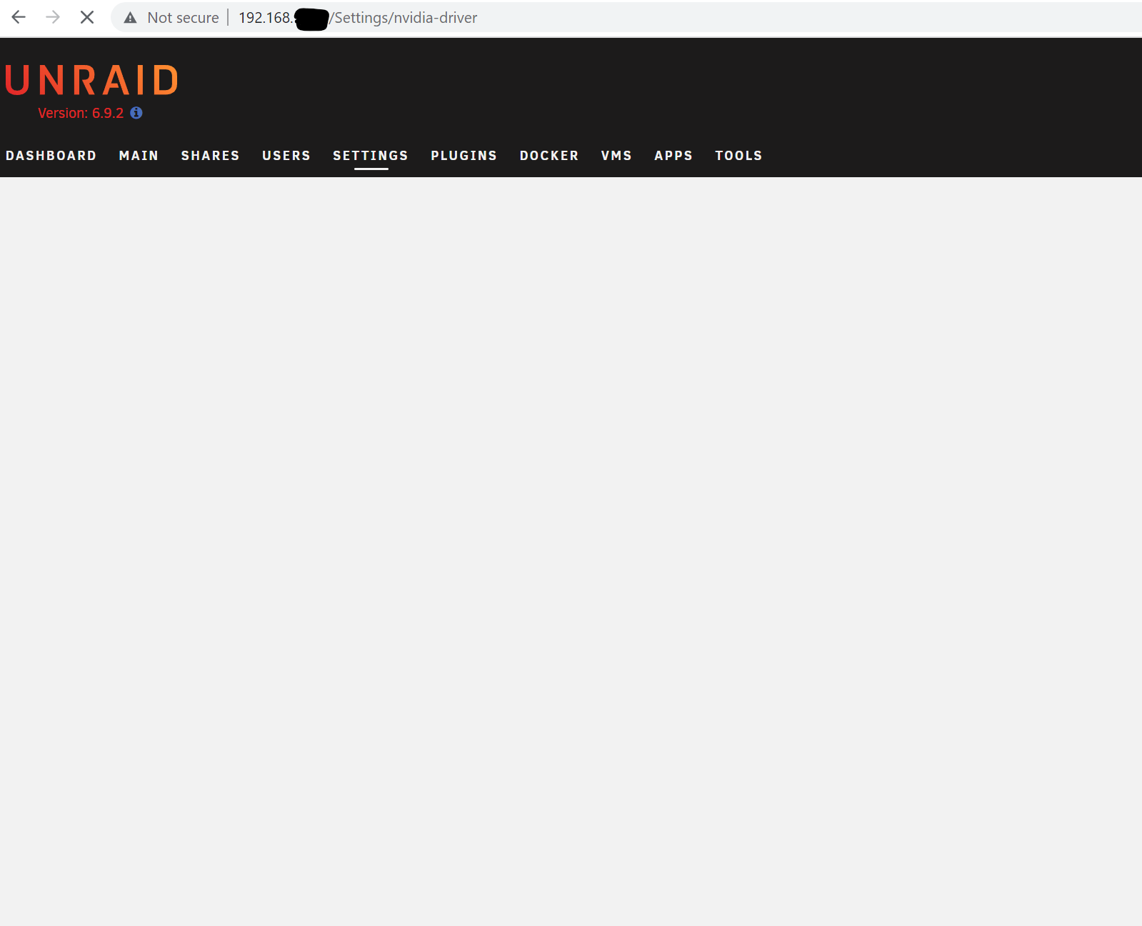

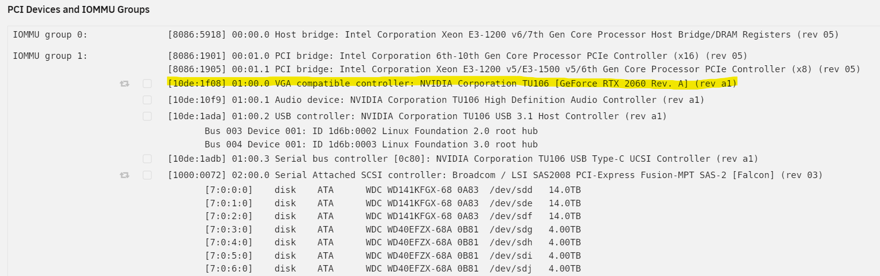

Hi everyone. Sorry if this is a noob error. I have installed a Nvidia RTX2060 into my server and I wish to use this for transcoding in Jellyfin. The GPU shows up in my System Devices, so I assume this means that unraid is recognising the GPU is installed:
I have installed the Nvidia-Driver plugin following the instructions pinned to page 1 of this topic by ich777. When I go to Plugins and click the Nvidia-Driver icon (Step 4 of the instructions), all I am getting is a blank screen. There is a troubleshooting guide in the instructions, but this says that there should still be something that shows up on this screen. Does anyone know what I might have done incorrectly here?
start from scratch
uninstall the plugin, remove the existing files from your USB drive
reboot,  install again and WAIT until the done message comes up, reboot and you should be good to go.
Please post your Diagnostics too.

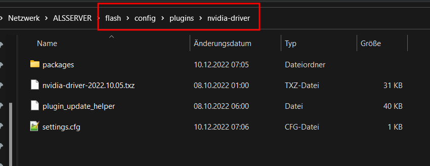

2 hours ago, alturismo said:
start from scratch
Thank you alturismo. I have followed these steps (including waiting for the done message to appear when installing the plugin) but I still have the same issue. Appreciate the feedback nonetheless!
39 minutes ago, TheUnraidNoob said:
Hello ich777. My diagnostics zip is attached. Thank diagnostics-20221221-1726.zipyou for getting back to me!
Something went really wrong with your installation.
Please do the following:
  1. Remove the plugin
  2. Execute this command from a Unraid terminal:
    rm -rf /boot/config/plugins/nvidia-driver
  3. Reboot your server
  4. Install the plugin from the CA App again and wait for the DONE button to appear, this can take a really long time depending on your internet connection (!!!don't close the pop up with the red X!!!)
I would strongly recommend before doing that all that you first upgrade to Unraid 6.11.5, you are still on Unraid 6.9.2 and that version is really out of date and missing some important information for me to diagnose what went wrong from the Diagnostics.
If it doesn't work after that please post the Diagnostics again.

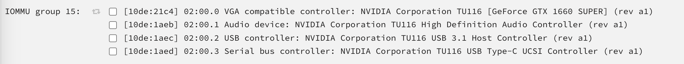

Hi everyone. I apologize for the question, I know it has been raised many times, but I could not find an answer 😞
I build a server and trying to set up a gtx 1660 super to work with a plex. I installed the drivers, the card was not recognized, removed and reinstalled - the same result. Please, help. Screenshots and logs are attached.
222628432_Monosnapbrainservernvidia-driver2022-12-2119-13-08.thumb.png.c1968aa810d1f6a22087fbf998c1417b.pngThe card is recognized in unraid
289224558_MonosnapbrainserverSysDevs2022-12-2119-13-49.thumb.png.9b668f7604df63728652687650975efe.png
brainserver-diagnostics-20221221-1916.zip
This is the error:
Dec 21 19:07:25 brainserver kernel: nvidia 0000:02:00.0: Unable to change power state from D3cold to D0, device inaccessible
Dec 21 19:07:25 brainserver kernel: nvidia 0000:02:00.0: vgaarb: changed VGA decodes: olddecodes=io+mem,decodes=none:owns=none
Dec 21 19:07:25 brainserver kernel: NVRM: The NVIDIA GPU 0000:02:00.0
Dec 21 19:07:25 brainserver kernel: NVRM: (PCI ID: 10de:21c4) installed in this system has
Dec 21 19:07:25 brainserver kernel: NVRM: fallen off the bus and is not responding to commands.
Dec 21 19:07:25 brainserver kernel: nvidia: probe of 0000:02:00.0 failed with error -1
Dec 21 19:07:25 brainserver kernel: NVRM: The NVIDIA probe routine failed for 1 device(s).
Dec 21 19:07:25 brainserver kernel: NVRM: None of the NVIDIA devices were initialized.
This seems more like an hardware incompatibility issue to me.
If possible try this:
  1. Search for BIOS updates, if a newer BIOS is available please update your BIOS
  2. Switch to Legacy Boot mode instead of UEFI
  3. Force the PCIe slot to Gen3 where the card is installed
May I ask why do you want to use a Nvidia GPU when you have the iGPU, the new Intel iGPUs are pretty much capable of the same amount of transcodes like your 1650 (depending on the source quality) and as a benefit you save a lot of power.

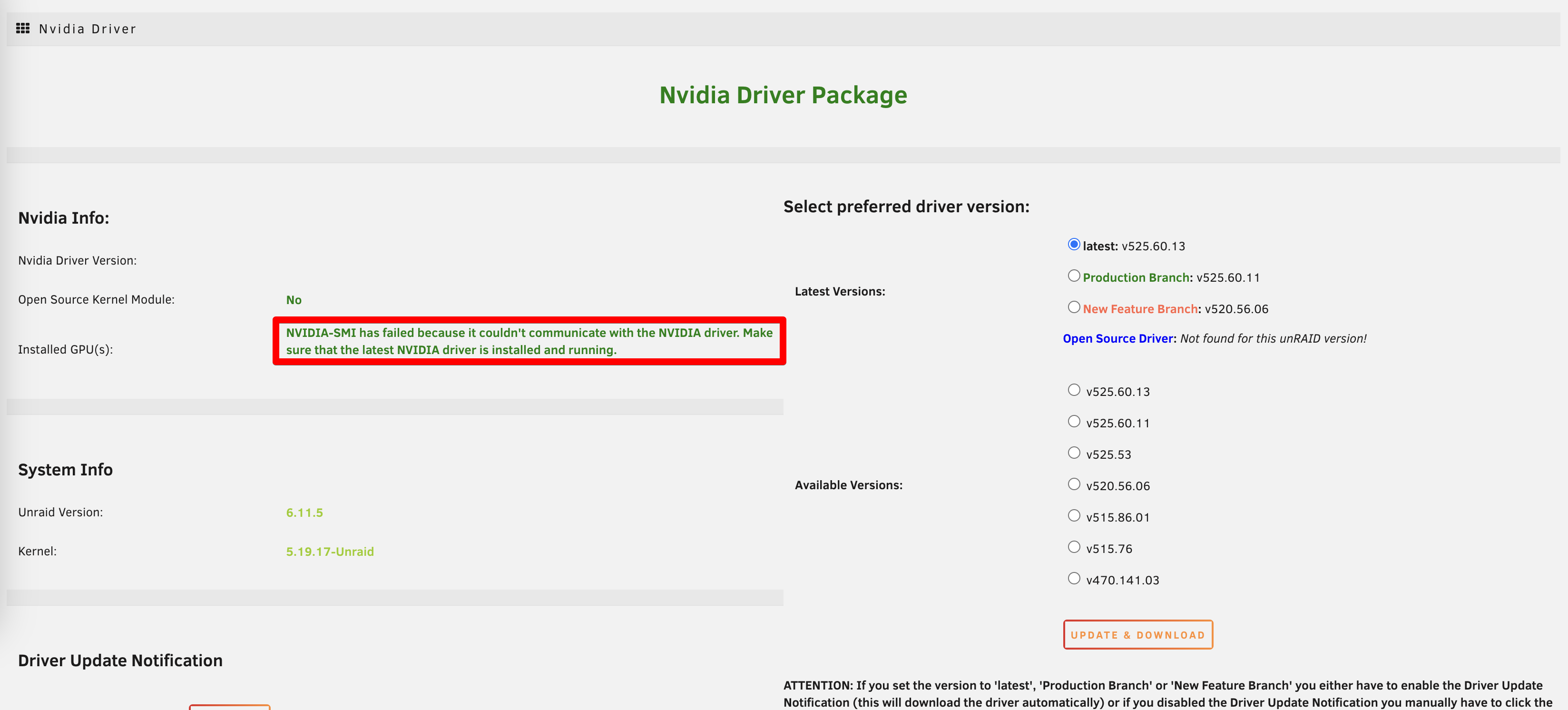

Hello, and thank you for getting back to me. I followed the steps above, including upgrading my Unraid OS to 6.11.5. Same problem as before. This time I am unable to generate diagnostics. When I run diagnostics from the GUI, it is getting stuck at:
/usr/bin/nvidia-smi --query 2>/dev/null|todos >>'/mimir-diagnostics-20221221-2210/system/nvidia-smi.txt'
I also tried running the "diagnostics" command from a terminal window, but same problem. I left it running for several hours, but it still hasn't generated a diagnostics zip file. Any further help you are willing to offer me will be greatly appreciated.
If this fails that bad something is wrong with the card, please check if it is connected to power and also maybe try to re-seat it in the PCIe slot.
Please uninstall the plugin, reboot, pull the Diagnostics (without the plugin installed and after a reboot it will just work fine) and then install the plugin again and post your syslog in a text file if possible.
Are you sure that the card is working?

Hello, and thank you for the continued support. I have reseated the card, and reconnected the 8-pin power connector to the card and to the PSU. Same issue upon reinstalling the plugin. I have attached the diagnostics file (generated after removing the plugin and rebooting) and also the syslog file (generated after reinstalling the plugin and attempting to access the plugin settings page).
The card is definitely working:
   1. It was the card being used in my gaming rig until a week ago when I upgraded. It was stored in an anti-static bag until being installed into the server.
   2. I am able to view the server bios settings on a monitor connected to a HDMI port on the card.
syslog.txt mimir-diagnostics-20221222-0925.zip
The syslog after the install tells me that something went very wrong with the card in this system and the module crashes basically.
But I'm not entirely sure what is causing this.
The fact that you can see a display output tells not much if the card is properly working since the card is not fully initialized at this stage (BIOS & Terminal), you have to actually install the drivers for the card and put a 3D load on it to see if it's properly working.
Anyways, even if the card is working in another system it is possible that some form of hardware compatibility issue is causing this (I don't know much about those Intel motherboards that you are using, I've only heard that there can happen some weird things with certain hardware).
I would recommend that you try to install the card in another system (maybe Windows would be best), install the drivers, put some 3D load on it (Furmark, 3D Mark,...) and see if it is stable for about 10 minutes.
If that is working in the other system please create another Unraid USB Boot device and boot this exact system with this USB Boot device (don't start the Array, just register for Trail), install the CA App and try to install the Nvidia driver there <- this will not change anything to the system which you test the card in, as long as you don't start the Array.
I know this procedure is really tedious but with this you ensure that the hardware is working and if it's a hardware compatibility issue.

I am unable to install the Nvidia-Driver plugin.  I keep receiving the error "Can't download Nvidia Driver Package".  Below is the full message that I receive.  Any suggestions?
Thanks!
plugin: installing: nvidia-driver.plg Executing hook script: pre_plugin_checks plugin: downloading: nvidia-driver.plg ... done plugin: downloading: nvidia-driver-2022.10.05.txz ... done +==============================================================================
| Installing new package /boot/config/plugins/nvidia-driver/nvidia-driver-2022.10.05.txz +==============================================================================
Verifying package nvidia-driver-2022.10.05.txz.
Installing package nvidia-driver-2022.10.05.txz:
PACKAGE DESCRIPTION: Package nvidia-driver-2022.10.05.txz installed. +==============================================================================
| WARNING - WARNING - WARNING - WARNING - WARNING - WARNING - WARNING - WARNING
| Don't close this window with the red 'X' in the top right corner until the 'DONE' button is displayed!
| WARNING - WARNING - WARNING - WARNING - WARNING - WARNING - WARNING - WARNING +==============================================================================
-----------------Downloading Nvidia Driver Package v525.60.13------------------
----------This could take some time, please don't close this window!------------
--------------Can't download Nvidia Driver Package v525.60.13-----------------
plugin: run failed: /bin/bash Executing hook script: post_plugin_checks
