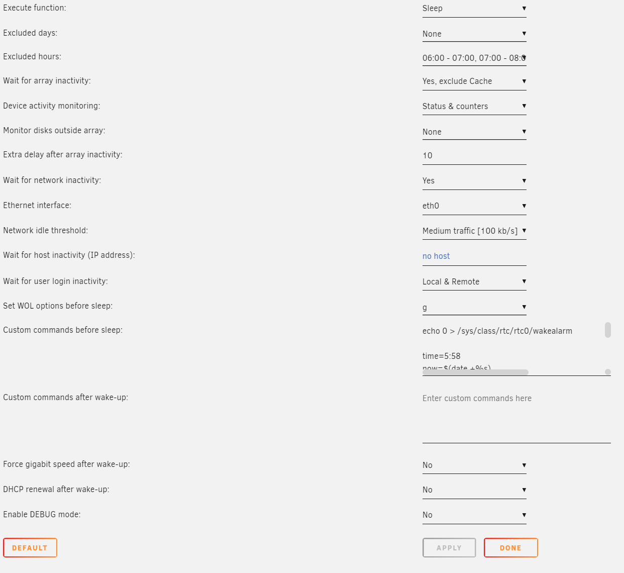

Hi all,
I have an issue where the Nvidia plugin no longer works after the server exits S3 sleep. I use the plugin for hardware transcoding for Tdarr and Plex. If I restart the server then it works properly until S3 sleep is activated (server sleeps and then wakes up).
There was no issue when I was using UNRAID version 6.10. I am currently updated to 6.11.5.
Would this be an issue on my end? If so how would I be able to fix it?
Are the Diagnostics from before or after a sleep?
I have to say that Nvidia and sleep on Linux where never best friends anyways... You find dozens of threads (not especially Unraid related) on the Internet about Nvidia cards not working properly after waking the device from Sleep.

I have attached my settings for Dynamix S3 Sleep:
(custom commands are only used to wake the server at the specified time)
Please let me know if you want to see the custom code.
Edited by corfoto4
23 minutes ago, corfoto4 said:

However that doesn't makes much sense, please do it over WOL or a BIOS schedule <- the BIOS Schedule shouldn't even be hard to set up.
Sorry I'm not that familiar with this plugin at all and have never seen it as I usually don't support it and I personally don't see a reason why to use it on a server (even not on a home server), if possible, please use the shutdown instead.
