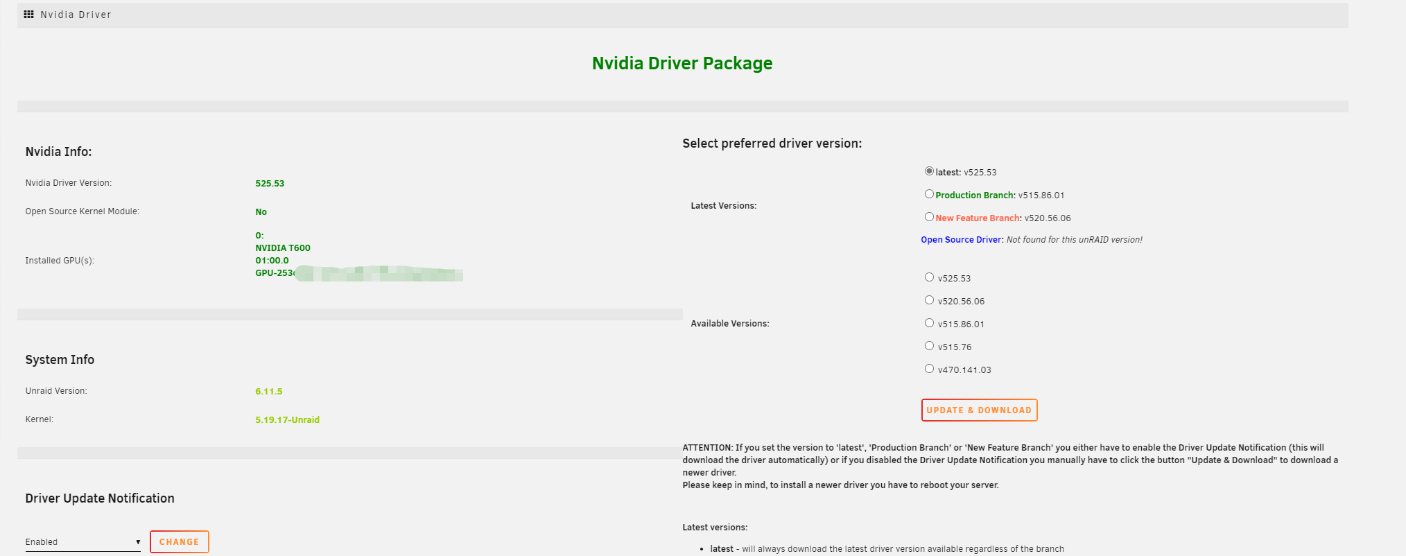

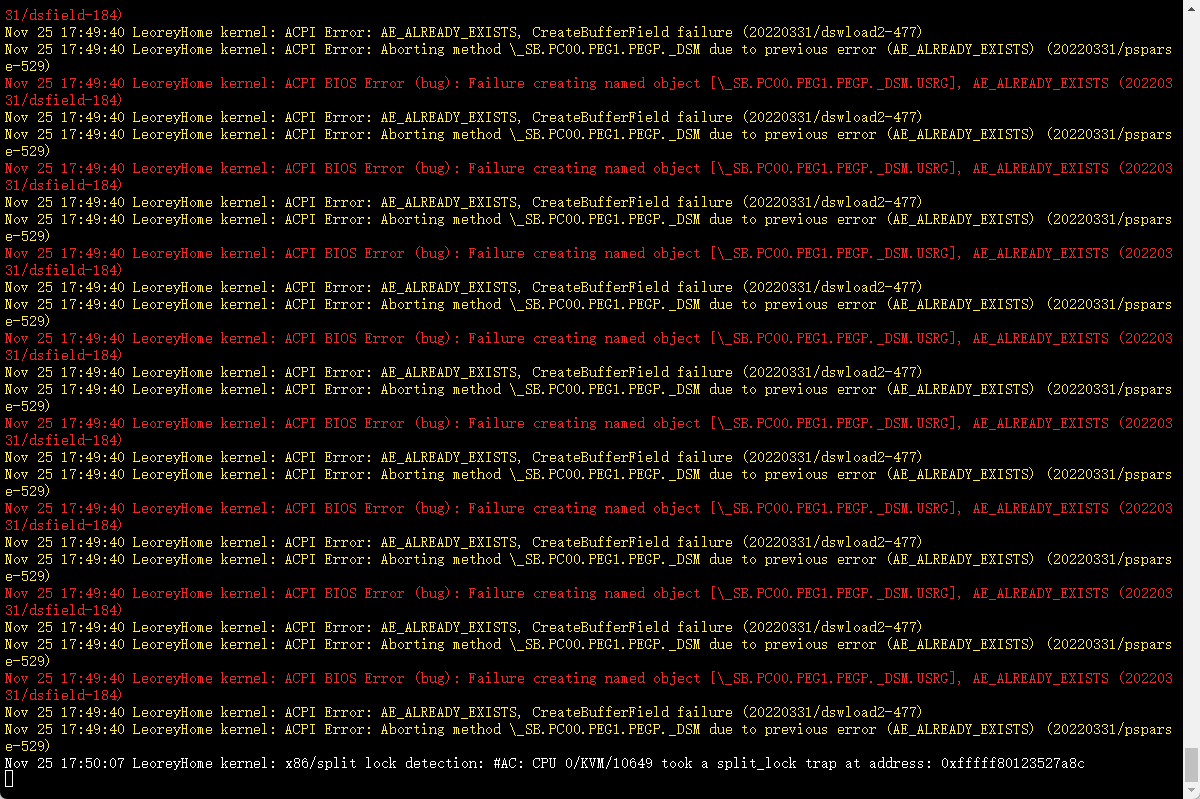

Hi, my diagnostic log is as follows,
I also uploaded a Jellyfin transcoding log for you
I confirmed that Above 4G Decoding and Resizable BAR is enabled in the BIOS
The driver version I am currently using is
525.53
When transcode is in progress, the error seems to be stopped at Nov 25 17:49:40
Looking forward to your reply
leoreyhome-diagnostics-20221125-1752.zip transcode.txt
Edited by crushleorey
I really can't tell what's going on there but from my perspective this is some bug in the BIOS.

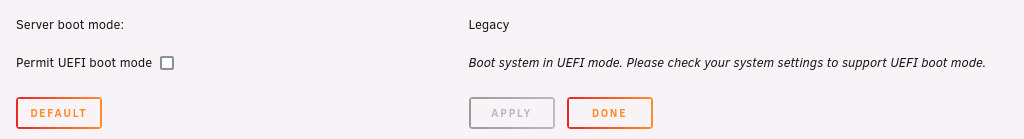

But are you sure that you are booting in CSM mode? For me it seems that you boot with UEFI.
Go to the Main tab from Unraid and then click on the blue text which says "Flash" and make sure that box isn't activated:
(btw you also see in which mode you are currently booted UEFI or Legacy)

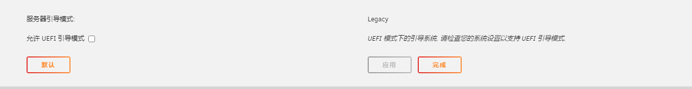

I tried it, still throwing a lot of errors, no improvement
I want to be desperate
The main issue here is the bleeding edge hardware that you are using.
In your case I blame the manufacturer from the Motherboard because this seems some kind of firmware bug which needs to be fixed in your case by ASUS.
Maybe try to contact ASUS about that issue, hopefully they will release a new BIOS with a fix.
There is also another way around this and you can hide the message from your syslog, but keep in mind this is not a real solution, this is more of a workaround.

My graphics card is old, but the platform is very new, but when I use GT1030 there is no problem, the BIOS seems to have no support for Quadro graphics cards
Because this error is generated every second, it will quickly fill up my memory (about 12 hours), causing my Unraid to crash directly
Will the hidden log you mentioned actually record this log and not display it? This does not seem to solve the problem, because my memory will still be full.
In other words, how to set not to record this log that does not seem to affect my normal use?
This is a hardware combination bug and has strictly nothing to do with the QUADRO brand, this could theoretically also happen with any other PCIe card.
This will hide the message entirely from the log so it will use no space in the log directory.

Had a little bit of time, please add this to your go file at the bottom after the line that starts emhttp:
# Suppress ACPI Error messages
echo ":msg,contains,\"ACPI Error: AE_ALREADY_EXISTS\" stop" >> /etc/rsyslog.d/01-blocklist.conf
echo ":msg,contains,\"ACPI Error: Aborting method\" stop" >> /etc/rsyslog.d/01-blocklist.conf
echo ":msg,contains,\"ACPI BIOS Error (bug)\" stop" >> /etc/rsyslog.d/01-blocklist.conf
/etc/rc.d/rc.rsyslogd restart
A little explanation, this will basically inject parts of the three error messages into the rcsyslog blocklist and the last line will restart the syslog daemon.
If you put these lines in your go file (/boot/config/go) then the messages will be blocked after emhttp (Unraid WebGUI and all serverices) is started.

No, that means this is a hardware combination issue, it may be possible that another card eg: PCIe Sound Card, PCIe TV Card, PCIe USB Card,... can cause such messages too.
This is actually a bug in the firmware (BIOS) from your motherboard and need to be fixed by the manufacturer.
It is also possible that a T600 from another manufacturer or OEM is working just fine.
