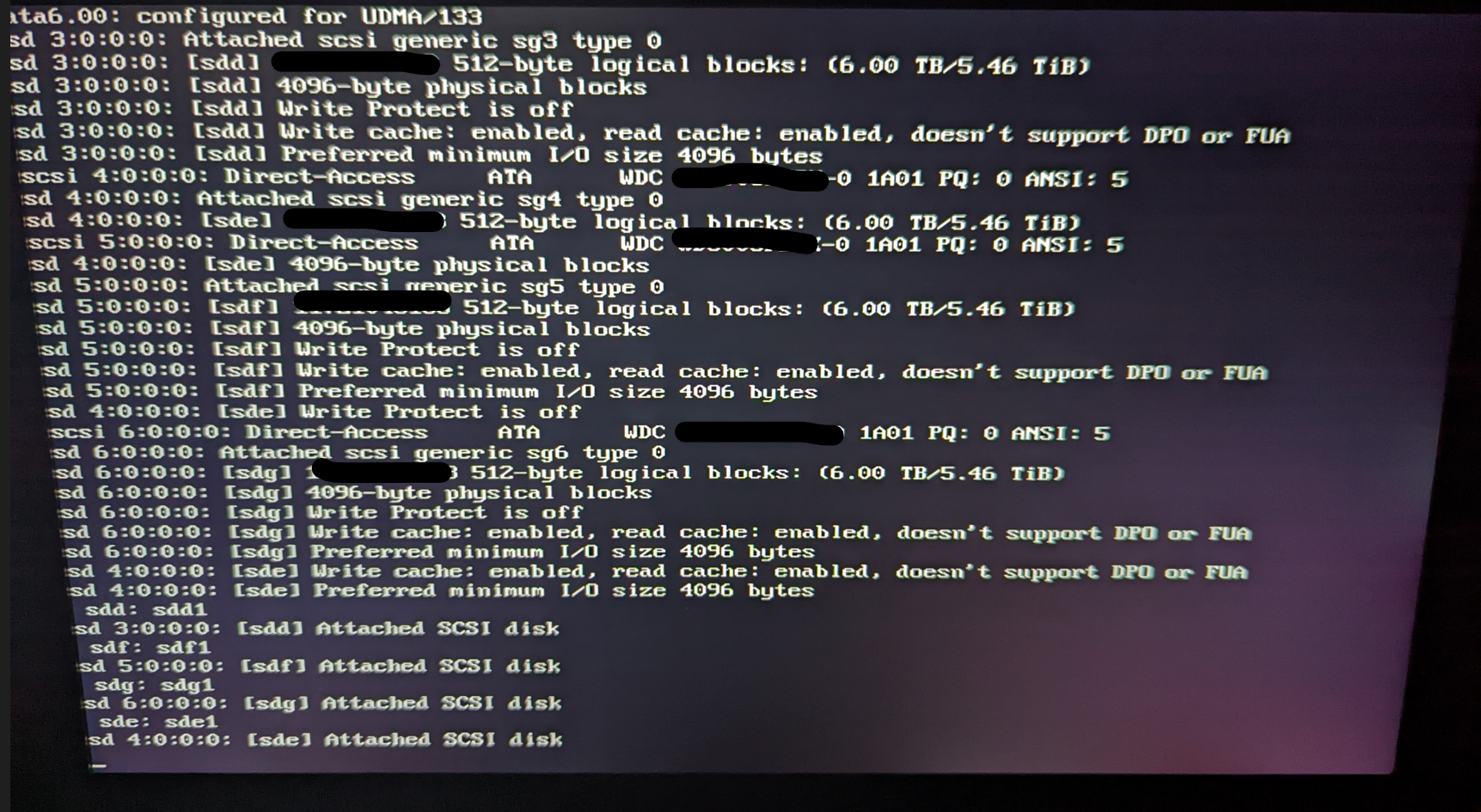

I know this sounds trivial, but I just updated to 6.11.1 and I'm no longer able to use my GPU (P2200) to display my Unraid console on a screen and for Plex transcoding simultaneously.
It worked previously in 6.10.3, and versions before that.
After upgrading, I noticed that the text displayed while booting would stop at the point of mounting the disks (screenshot below).
Before upgrading, it would load all the way to the prompt to enter login credentials, and I could always wake the screen to login through the console.

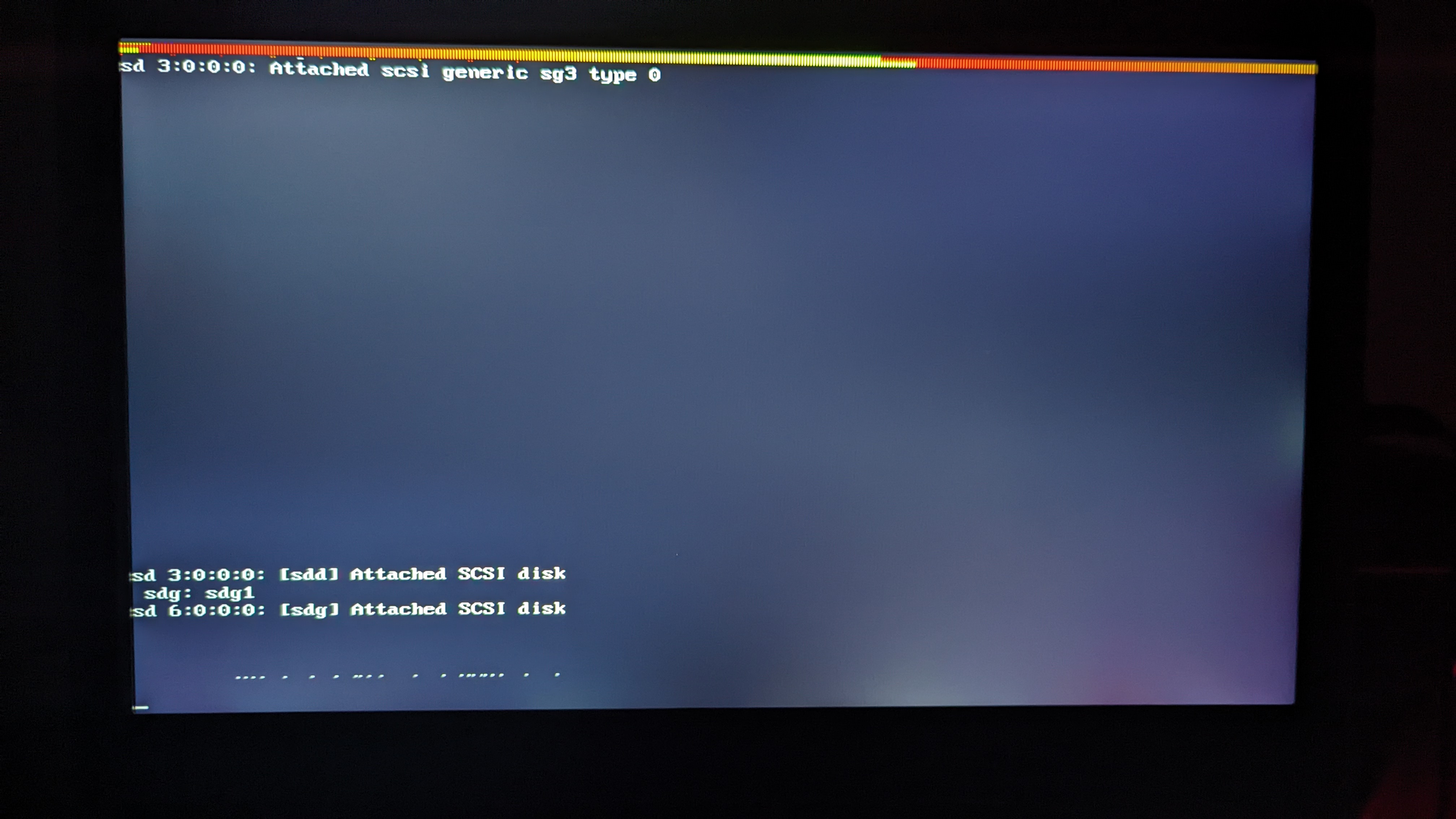

I also noticed after upgrading, if I started a transcode in Plex, the connected screen becomes distorted (screenshot below).
I tried reinstalling the driver and rebooting, but the issue still remains.
The GPU isn't being used by anything else and it's not stubbed at boot.
It's only used for transcoding in Plex and displaying the Unraid console on a screen.
I'm not sure what else to do to get this working like before.
Any help is greatly appreciated.
Connected screen stops here at boot:
Connected screen after starting transcode in Plex:
Nvidia Plugin:
Syslinux config:
Please post your Diagnostics.
If the screen comes distorted after you start a transcode something is wrong with the card.
Are you able to pull the card out of your server and test it on a Windows machine, install the drivers and put some 3D load on it like FurMark or something similar?
Diagnostics attached.
diagnostics-20221019-0140.zip
That would suck since it's not even 2 years old, and worked fine up until upgrading to 6.11.1 tonight.
I don't have another machine I can test it with, but I can at least try shutting down the server and reseating it in the slot.
It also has no issues displaying anything up until the point where it says it's mounting the disks. BIOS displays fine, etc.
It also transcodes 4K just fine in Plex.
It's only the Unraid console that just freezes and stops loading at boot.
You can always try to execute this command from a Unraid terminal and reboot but I don't think that it will change anything in your case:
sed -i "/disable_xconfig=/c\disable_xconfig=true" /boot/config/plugins/nvidia-driver/settings.cfg
(this is only if you have GUI mode enabled and a second graphics card in the server which you want to use as the primary display)
Please try to do that.
This is often the case because it uses a generic display driver that only is used fur such things and only supports 2D and doesn't need much horse power.
Does the Plex transcode work or does it error out?
You can also try another driver version for example the legacy 470 series driver.
From what I see from your log, the driver just loaded fine without any errors whatsoever.

Sorry, I edited my original post to include that Plex has zero issues transcoding with this card, except for the distorted screen that's connected to the GPU (worked before 6.11.1).
I can have multiple 4K transcode streams running simultaneously, and they work great.
I bought the card in 01/2021.
I tried shutting down the server, reseating the card and booting back up, but got the exact same issue as before.

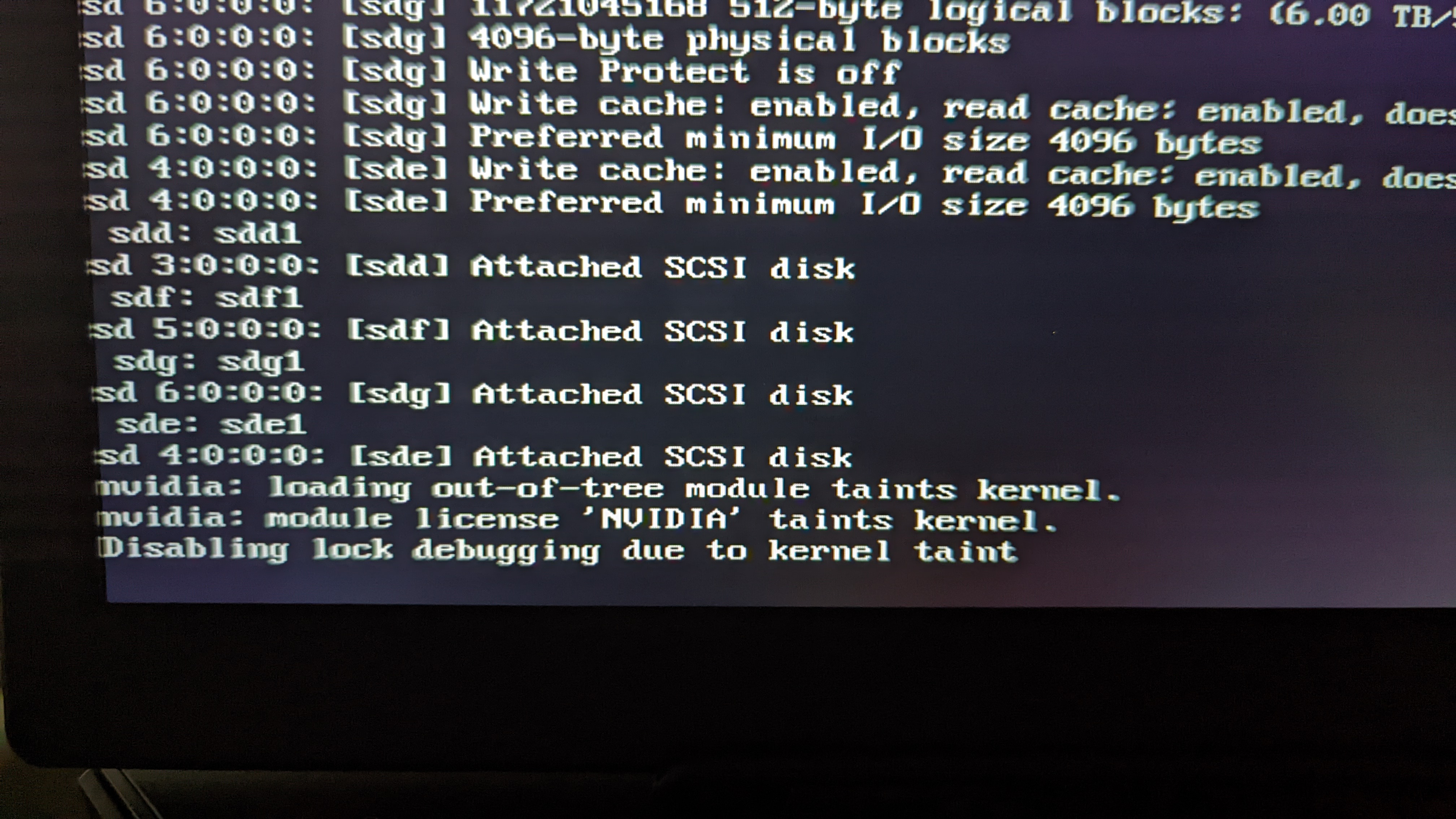

So, I tried downgrading from "latest" to "production branch" in Nvidia Driver Settings, and rebooted.
This time it gets a little further in the loading process, and it stops at a different error.
Does this help indicate anything else?
I also attached another copy of Diagnostics using the new driver. diagnostics-20221019-1118.zip
Loading screen stops here with "production branch" driver:
Edited by carnivorebrah
This is not an error whatsoever... This is just a information that the Nvidia Kernel module taints the Kernel and this is just normal.
Not really...
Do you redirect the console output somewhere in the BIOS or somewhere else?
I really can't think of a reason why it stops output to the screen.
Not really...
That makes sense.
No, I just have the BIOS set to the PCI slot the GPU is in for video output.
I'm starting to wonder if this is an issue with 6.11.1 itself, instead of the driver, and if I should try posting in the release thread for it with details of my issue since upgrading.

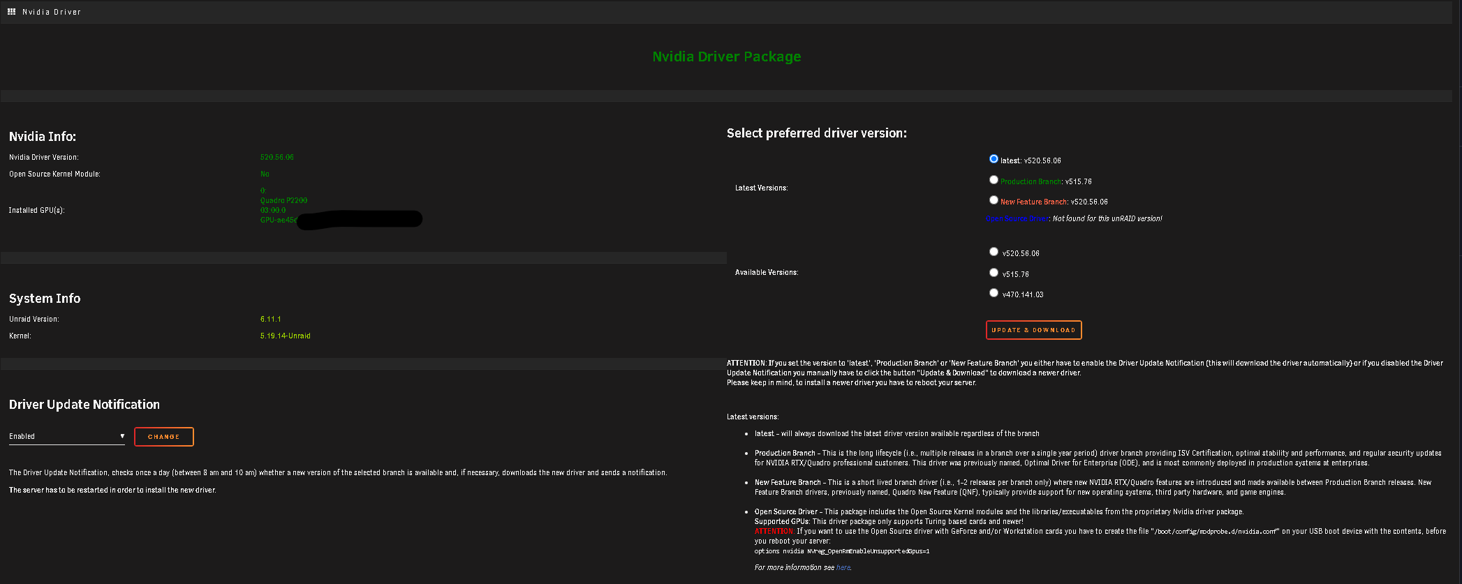

Hi, when visiting the Nvidia-Driver settings page it takes about 2 minutes to load and then displays "Installed GPU(s):No devices were found".
It's up-to-date and the Update & Download button has no effect.
My GPU comes up under System Devices:
00:10.0 VGA compatible controller: NVIDIA Corporation TU116 [GeForce GTX 1660 Ti] (rev a1)
Attached is my diagnostics. For more context I'm passing through my GPU from Proxmox to Unraid. Any ideas?
tower-diagnostics-20221020-2206.zip
Edited by AndrewClaus
You have a lot of:
Oct 20 18:47:00 Tower kernel: NVRM: GPU 0000:00:10.0: RmInitAdapter failed! (0x25:0x65:1411)
Oct 20 18:47:00 Tower kernel: NVRM: GPU 0000:00:10.0: rm_init_adapter failed, device minor number 0
in your Syslog, is this the first time you are trying to install the Nvidia Driver?
Please make sure that you've disabled C-States in your BIOS and that you enable Above 4G-Decoding and Resizable BAR Support if you have these options in your BIOS.

Thanks, those BIOS settings worked! My GPU is now being read by the Nvidia Driver:
However when having transcoding enabled on my Plex, video fails to play with an Error code: s1003. The docker container cannot be stopped via GUI (pictured below) or killed via terminal. I had to force stop my Unraid VM.
With all the part 2 configuration but transcoding disabled within the Plex app the videos play fine, it's only when I enable the acceleration settings:image.thumb.png.47cb7e5641657650a537fe014fa23542.png
