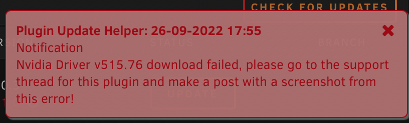

Not sure what good this screenshot is but following instructions.
Manually downloading driver was successful. Attached diagnostics just in case they are useful. They were collected prior to reboot.
brunnhilde-diagnostics-20220926-1800.zip

I cannot get to the NVIDIA plugin spot. I can only get into safe made, and the plugins are not there to unistall and update.  I even tried downgrading, but still wont get past Starting Samba:  hangs
Did you try to upgrade from 6.10.3 to 6.11.0?
When was the last time you rebooted? Changes are high that the Plugin Update Helper is not up to date but that is nothing to worry about if you have a actove internet connection on boot since the driver will be downloaded there.
If you don‘t have a active internet connection on boot I would recommend that you remove the plugin, reboot and then install it again from the CA App.
Try to remove the nvidia-driver.plg file.
The exact location is: /boot/config/plugins/nvidia-driver.plg
(I would also recommend that you remove the nvidia-driver folder that is lacated in there).
After that you should be able to boot and you can grab a fresh copy from the Nvidia Driver plugin from the CA App.

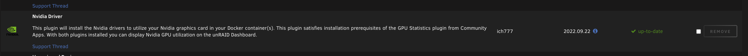

This plugin hasn't been working normally for a month on my server.
I noticed that it never notified me of a driver update. It never downloaded and installed the update even after rebooting my server. I had to update the driver manually and reboot my server.
I've always kept the plugin up to date.
So I deleted the plugin, rebooted, and re-installed the plugin. Now I can't change the Notification setting from Enabled to Disabled. I don't see any Save button on the plugin page. I also can't change Select Driver Preferred Version setting. I usually select Production Branch, but I can't change it from Latest Branch.
Fortunately this plugin is still working for local gui access and my plex docker.
Does anyone have any idea what is causing these issues?
Thanks for the help.

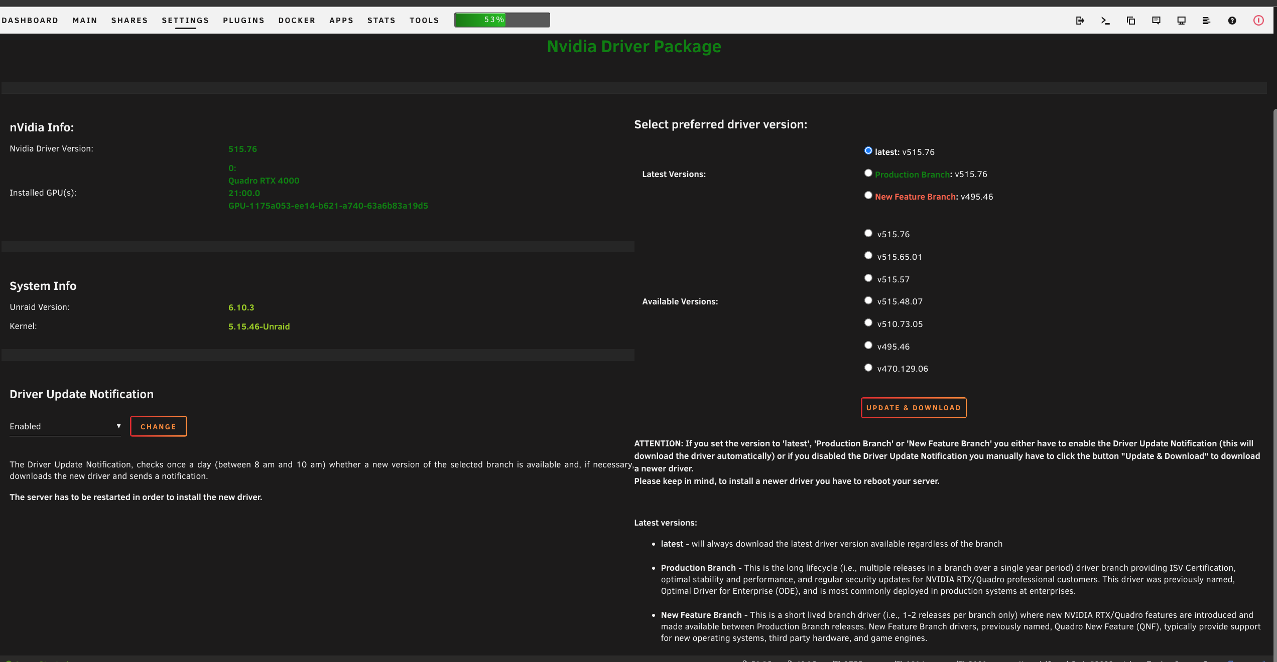

1404573494_ScreenShot2022-09-27at1_22_55PM.thumb.png.2372d3865071f842496eccdd5f209964.png
179969730_ScreenShot2022-09-27at1_22_02PM.thumb.png.909c1c60e7e913b96388ab1cd6cc1958.png
Exact same issue over here, I will look into that and report back ASAP.
Click Update & Download and it will update the selected version, on my machine this works just fine.

About the Select Preferred Driver Version, I don't want it to keep updating to the latest, which is why I'm trying to select the Production Branch and not Latest Production Branch. Unfortunately, I'm unable to keep the Production Branch selected.
Select the Production Branch and click on Update & Download.
AHHH...
Sorry, I just expected there to be a Save button.
The Update & Download button seemed like it was going to download and update even I was already up to date.
I clicked Update & Download and it saw that I was already on the Production branch and just finished without updating. The Production Branch is also now selected.
No, I changed that a while back since it will combine both features because if someone wants to downgrade or change the version to something else one had to click Save and afterwards Download. To make it a bit more convenient you can now click Update & Download
As said above I will look into the Update notification ASAP.
