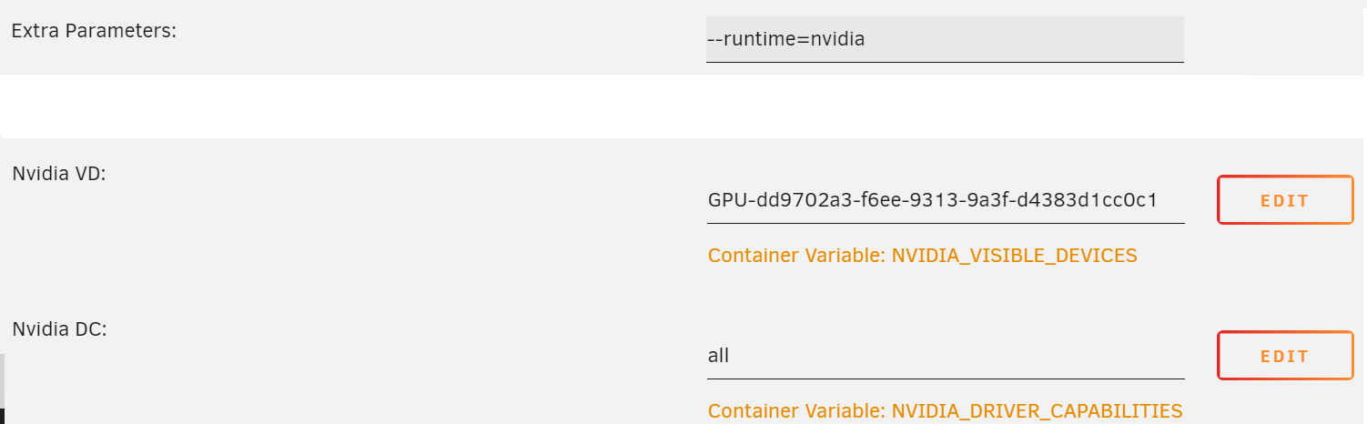

Can't start any dockers with --runtime=nvidia
they all say "Bad Parameter"
any advice on what to look at?

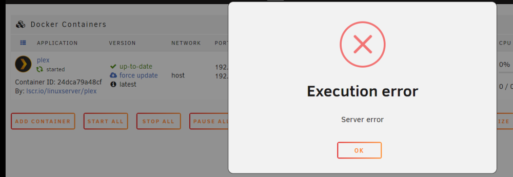

Uri
----------------EDIT---------------------
OK now I see there is a problem with my one of my virtual machines - so I think it is wider spread than just the Nvidia containers. I will have to dig into it. I will update when I find a solution.
1595983706_Screenshot2022-11-03at21_42_39.thumb.png.691e517e63159c672a745aec7f96376f.png
Edited by UBS
updated the issue
