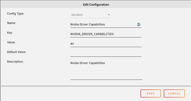

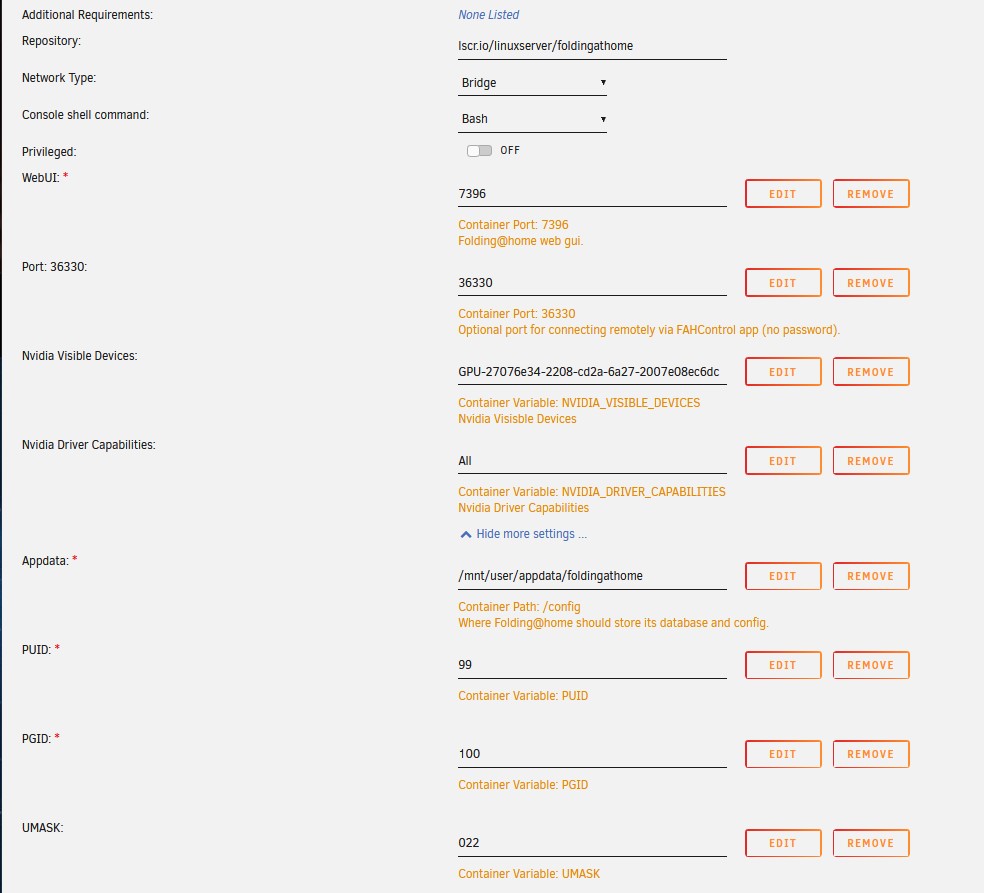

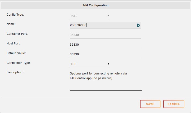

08:06:01:      GPU 0: Bus:41 Slot:0 Func:0 NVIDIA:7 TU106 [Geforce RTX 2060]
08:06:01:       CUDA: Not detected: Failed to open dynamic library 'libcuda.so':
08:06:01:             libcuda.so: cannot open shared object file: No such file or
08:06:01:             directory
08:06:01:     OpenCL: Not detected: clGetPlatformIDs() returned -1001
08:06:01:FS00:Initialized folding slot 00: cpu:10
08:06:01:WARNING:FS01:No CUDA or OpenCL 1.2+ support detected for GPU slot 01: gpu:41:0 TU106 [Geforce RTX 2060].  Disabling.
08:06:01:WU00:FS00:Starting
I am seeing this when I try and use my GPU in Folding at home. I assume because it is recognizing that there is a GPU, there is a driver issue.
I included pics of the config for the docker and the way I set the Nvidia variables.
I am on driver 515.76
using Unraid 6.11.1
Let me know if I can provide any more info
Thanks
Is the GPU recognized correctly in the Plugin?
If the GPU is correctly recognized and listed on the Plugin page then please post on the appropriate support thread from the container because the driver is indeed working and this issue is related to the container since this is also the log output from the container.
