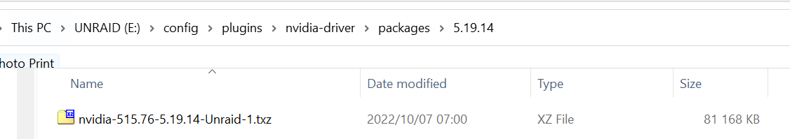

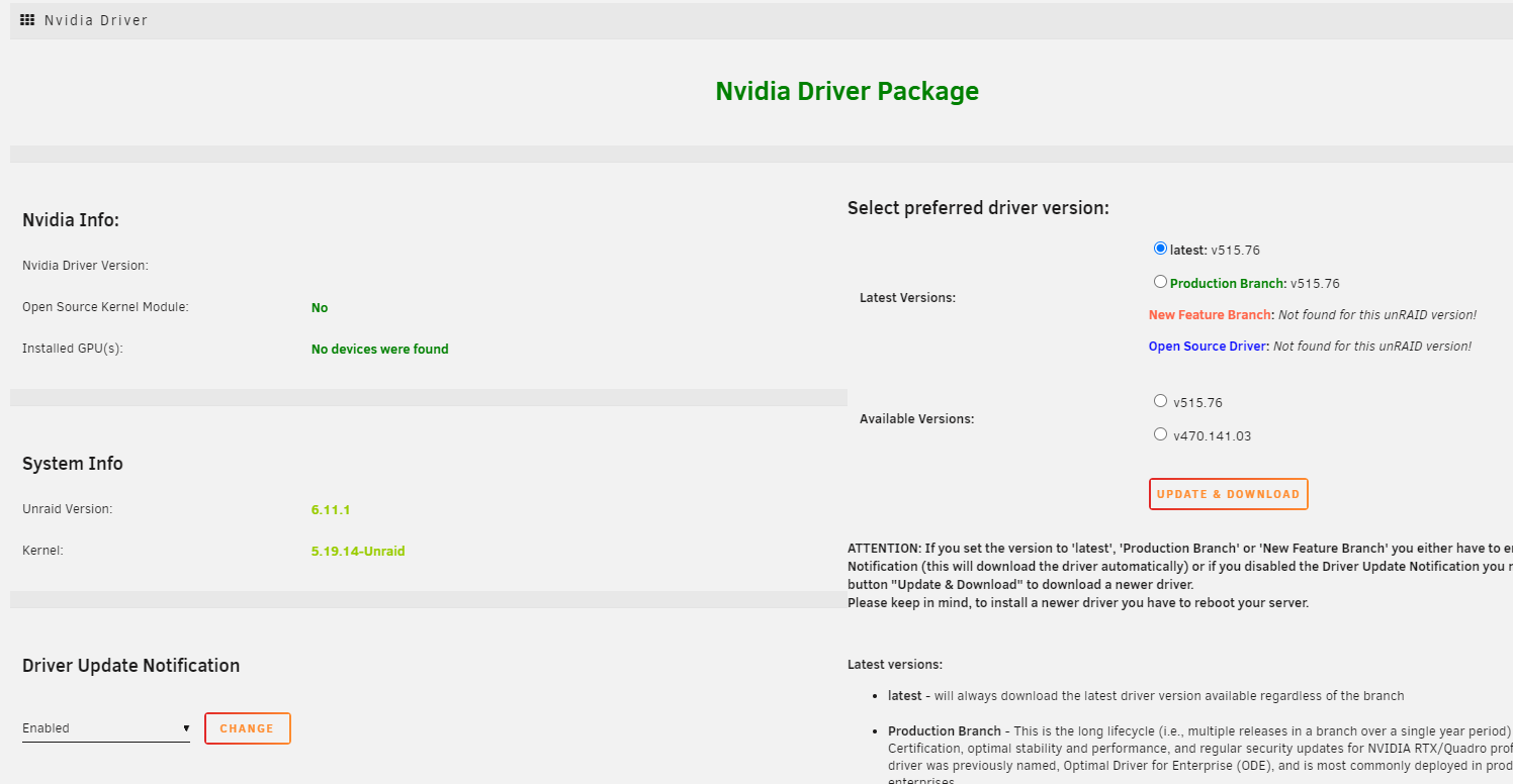

12 minutes ago, Be-Art said:
The system was shutdown, hardward changes done and booted up again, now cannot access UI.
I think this issue isn't related to the Nvidia Plugin but anyways, please move your USB boot device to your Windows PC and remove the file ../config/plugins/nvidia-driver.plg and reboot your server.
I can only tell you from the Diagnostics that your driver is not fully downloaded.

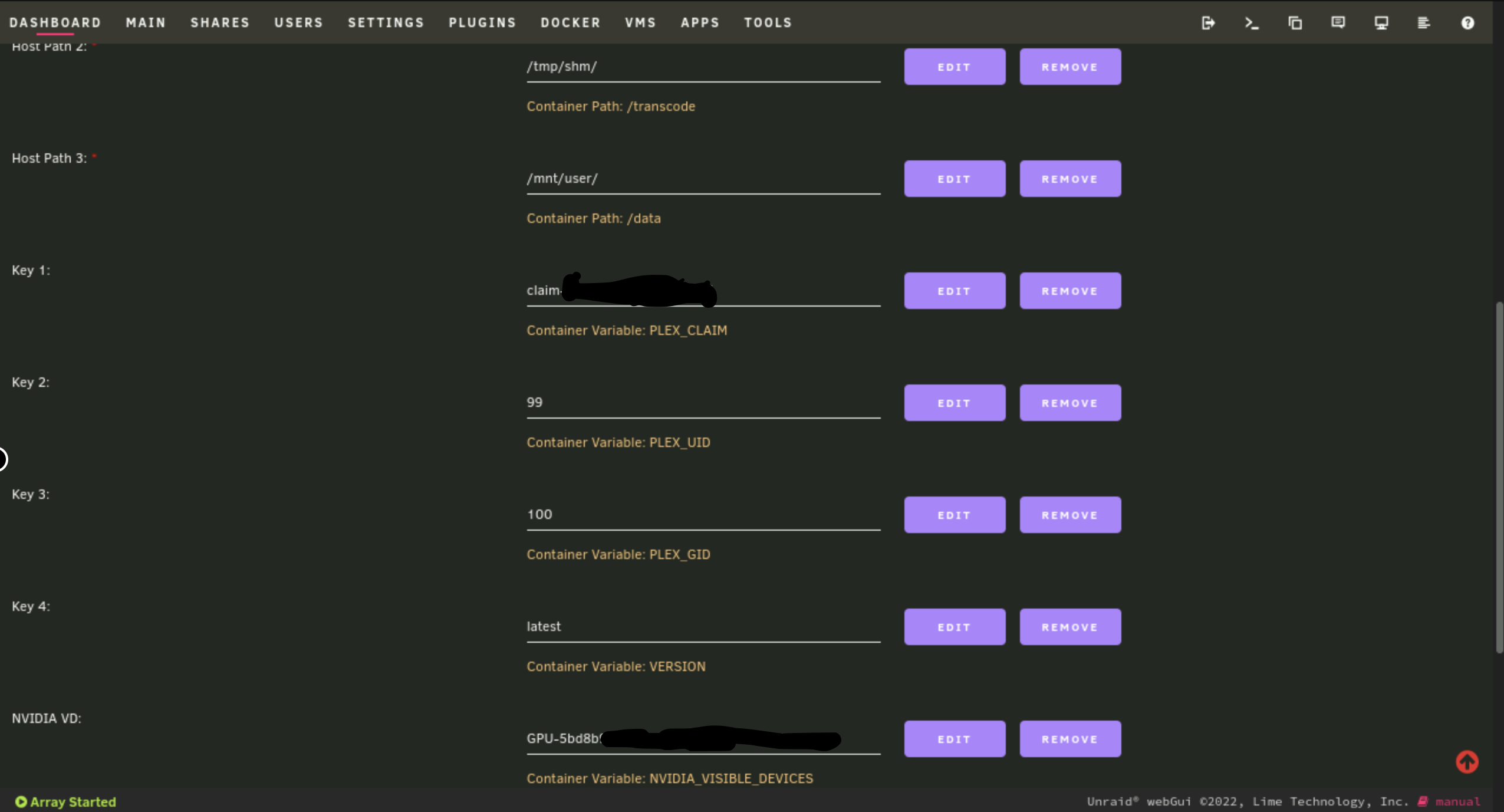

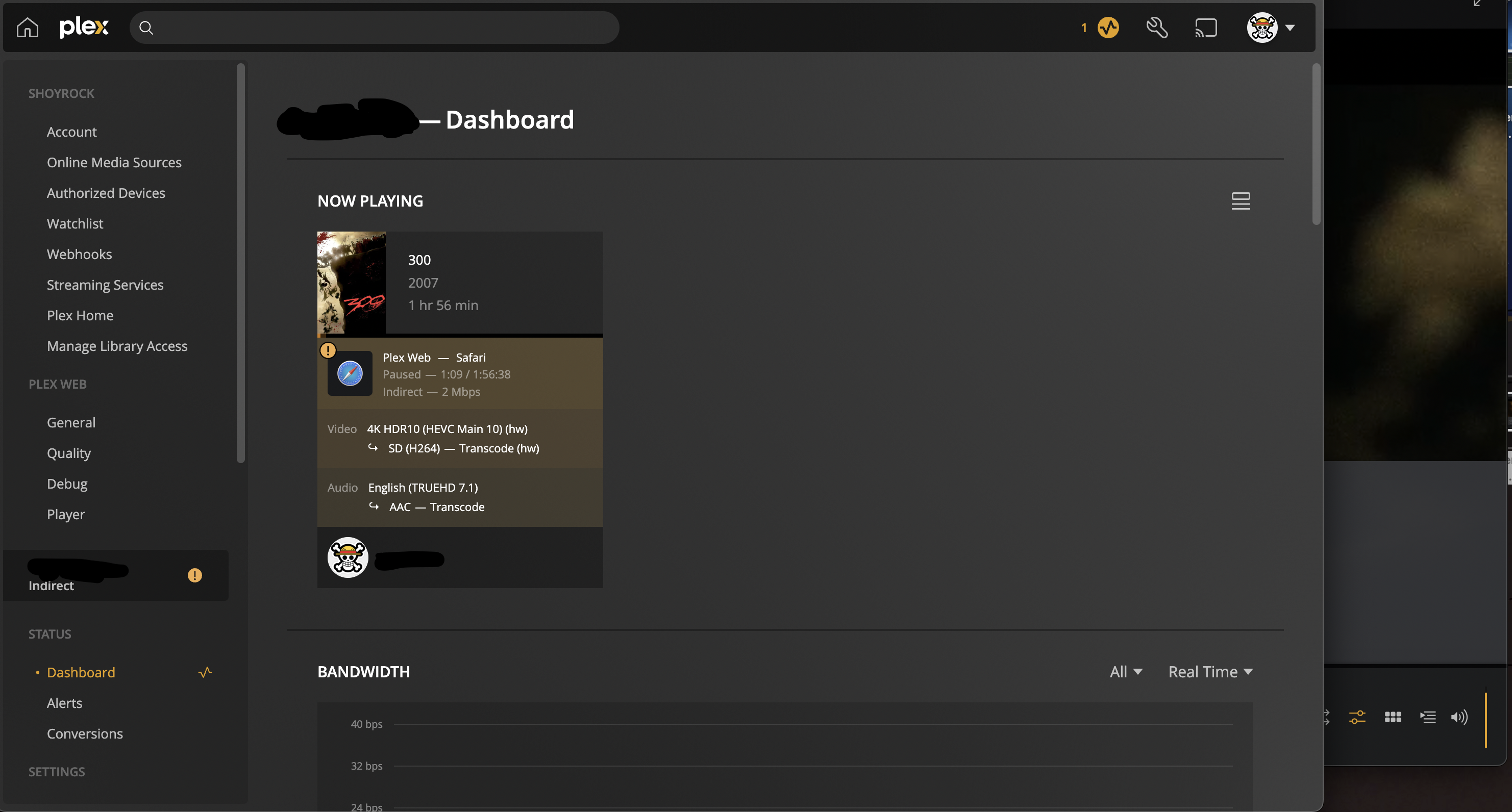

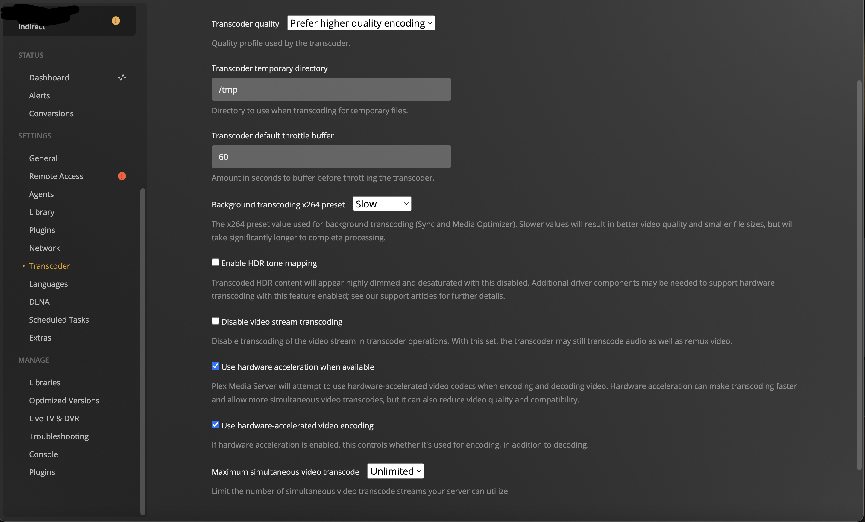

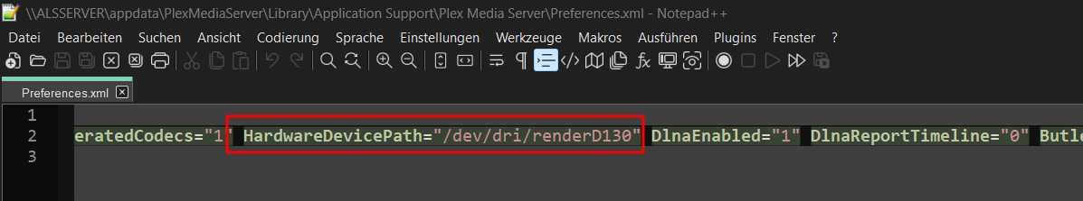

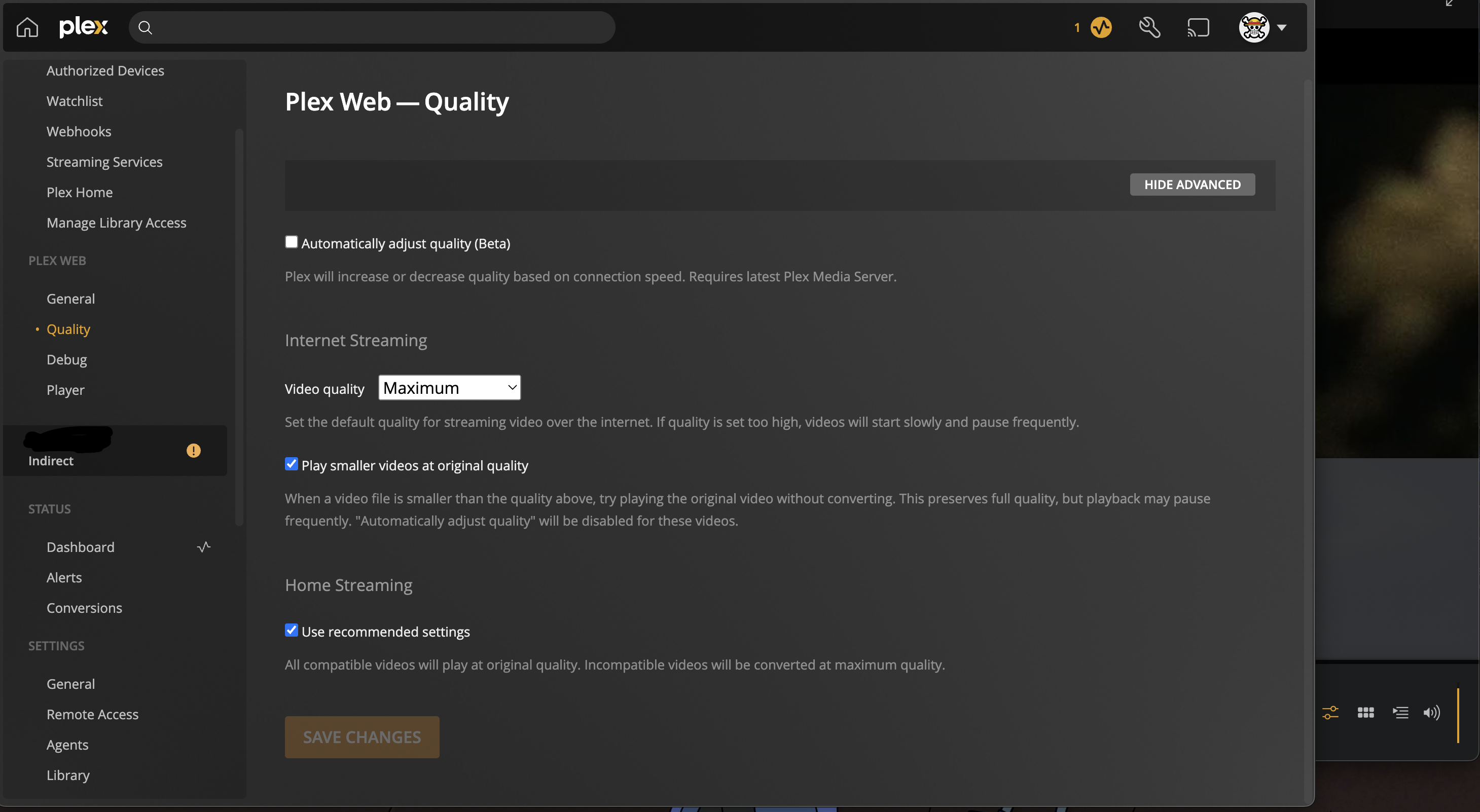

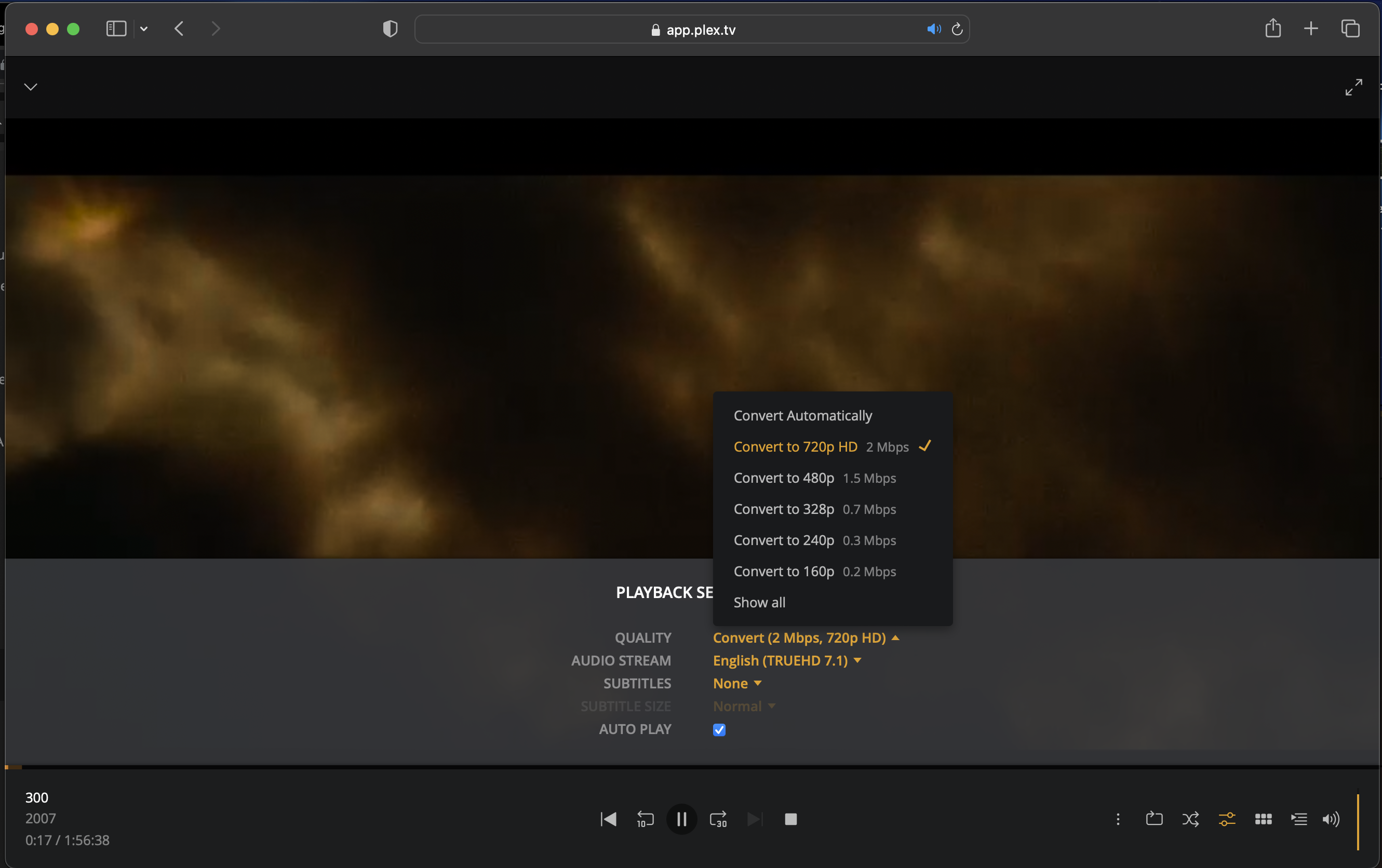

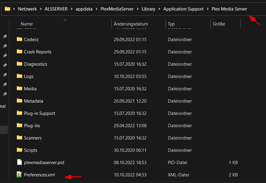

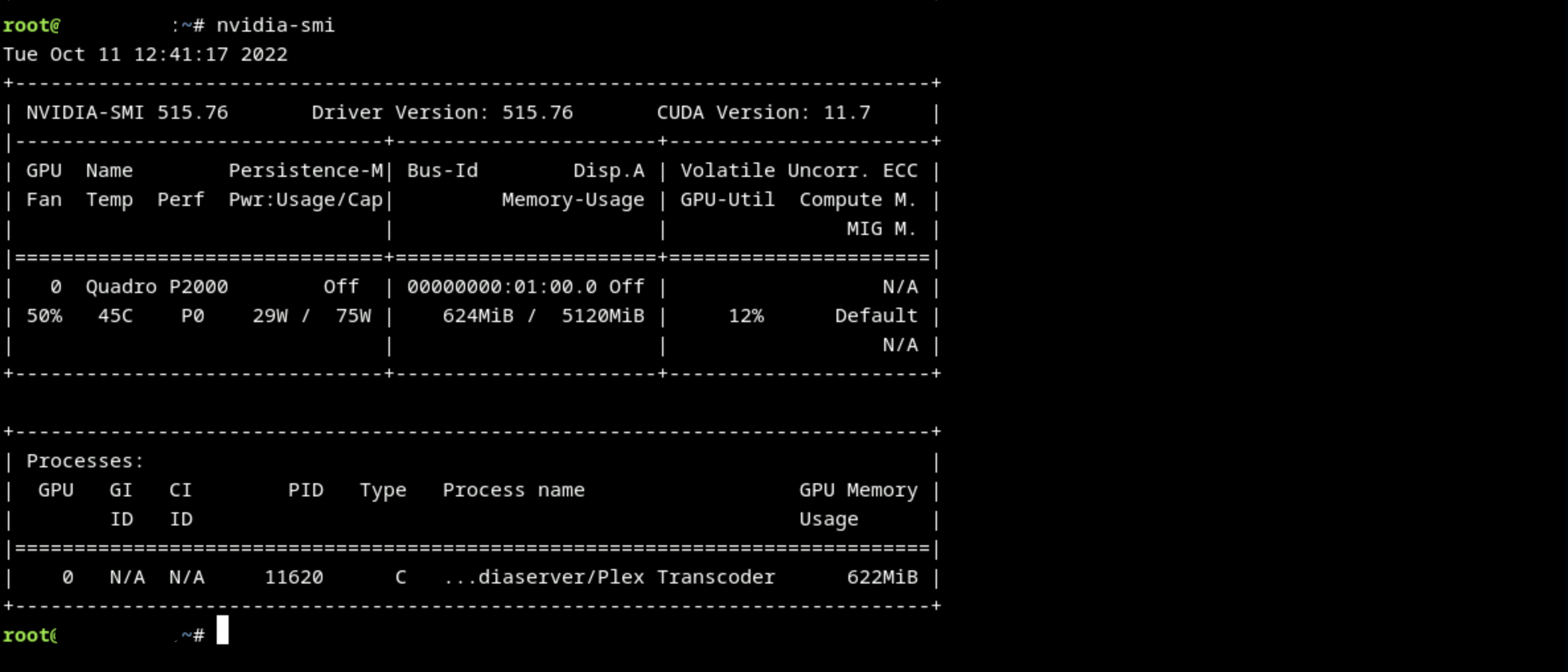

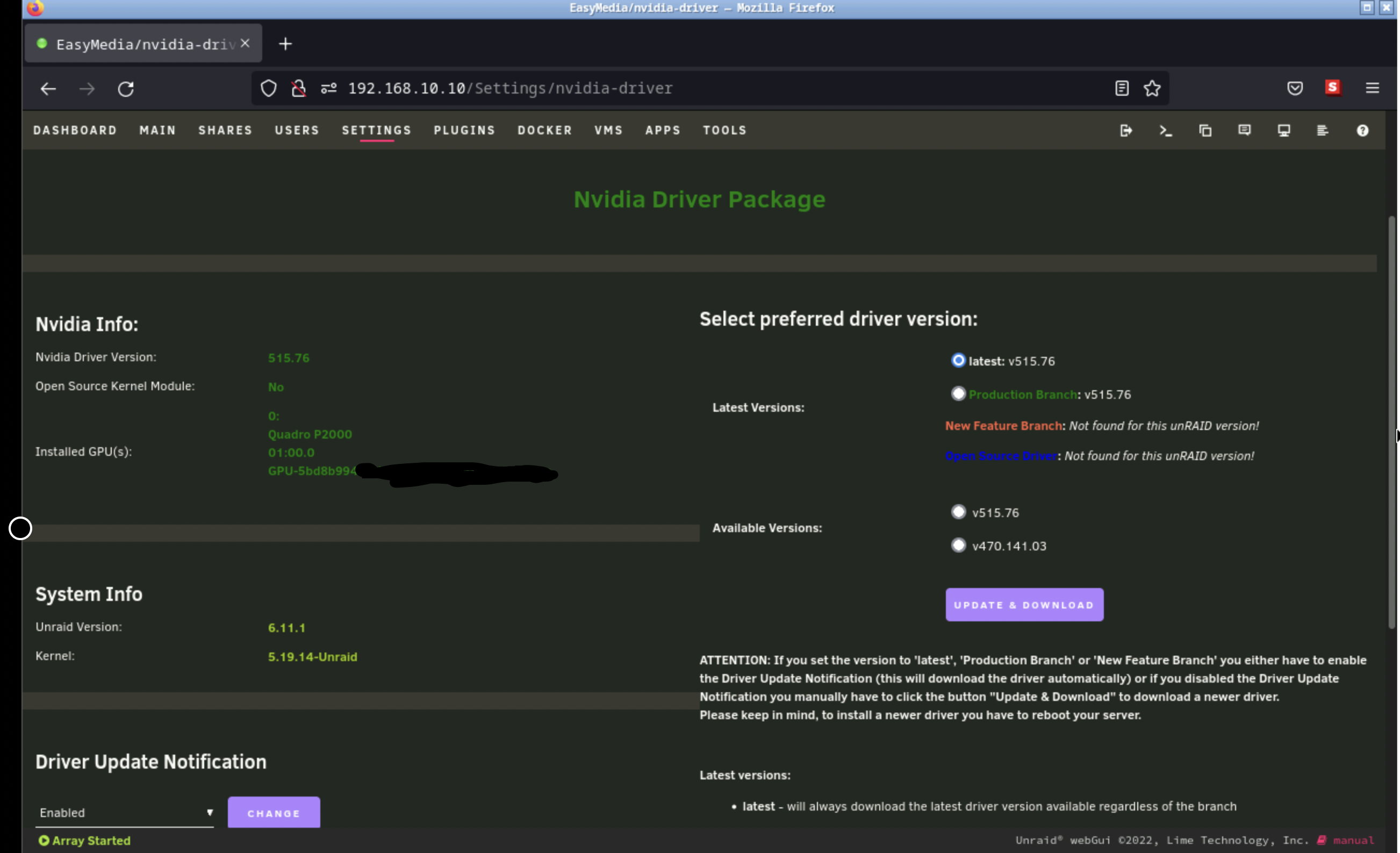

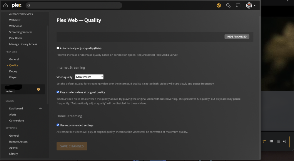

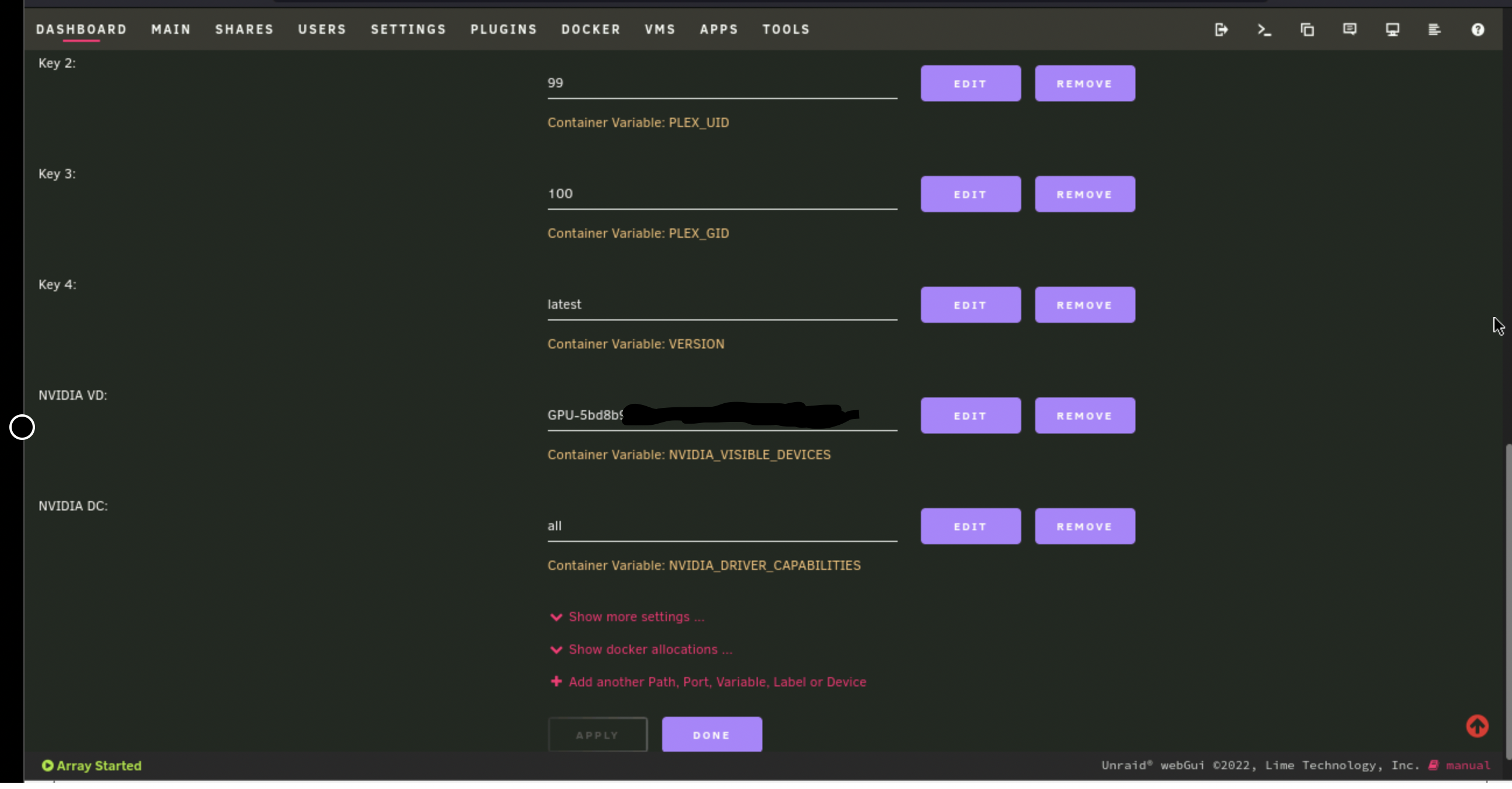

hey nood here, i don't know what i maybe doing wrong can someone please help me out, i needs to only be able to get 2mb 720 when i'm hw transcoding, but thats the same as when in software transcoding. i've been at this for months now trying to fix it but no luck, it was working fine when i was using the igpu when one day it just stopped working. so i switched to a p2000 think thats would fix the problem.
This seems like a Plex specific question since the Card is recognized in the plugin and seems to be working fine.
Please head over to the appropriate support thread for the container (Click the Icon on the Docker page and select Support.

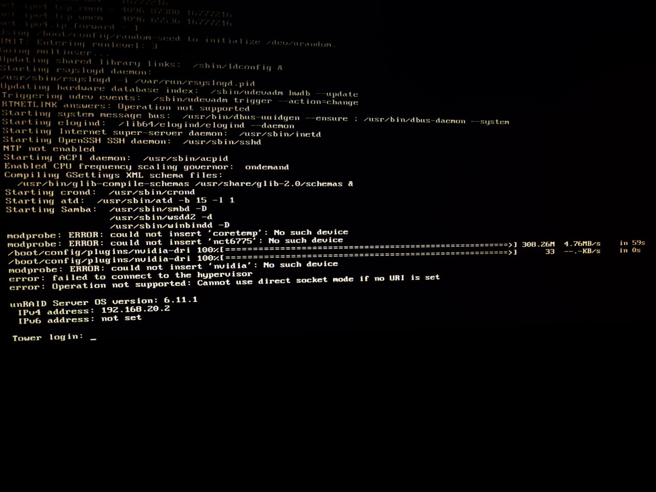

tried the above, now get this issue. Server still auto restarting after this tower login ad os version screen.

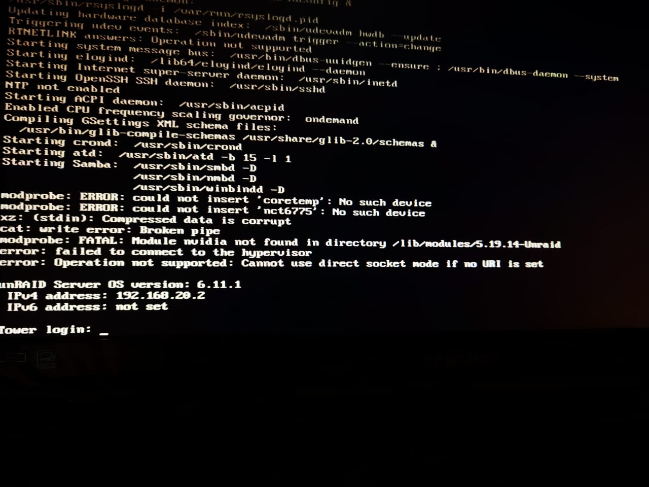

No, something wasn't removed right since now the plugin now has downloaded the driver successful, the wrong one but it successfully downloaded it.
You are using a card where you need to download the legacy driver 470 series.
Shut down your server, pull the USB Boot device, put it in your Windows PC and remove the folder .../config/plugins/nvidia-driver and the file .../config/plugins/nvidia-driver.plg again.
It wasn't removed properly before.
I would also recommend that you remove NerdPack and NerdPack.plg from your boot device which live in the same folder as the other two ".../config/plugins/".
As said above, the boot loop has nothing to do with the Nvidia Driver from my perspective.
thanks ill try to see is theres support an help but i don't think its going to, i tried all the plax docker containers, still had the same problem with all of them.

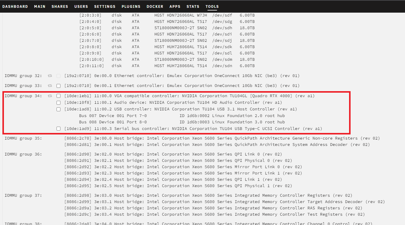

Just upgraded my server to 6.11 and I can't get my card to show up.  Followed the instructions provided to 'fix' the updated drivers, no change.  Removed and reinstalled the entire plugin, no change.  The card shows up in System Devices, but not in Nvidia-Driver.  Screenshots from Nvidia-Driver and System Devices, along with diagnostics attached here. Quadro RTX 4000 in an HP DL380 Gen7 with dual Xeon L5630, 144GB DDR3 ECC RAM, using an x16 riser for the card.
diagnostics-20221011-1500.zip
Edited by worldspawn
Was this card working before or have you installed it recently?
Please make sure that you've enabled Above 4G Decoding and if you have somewhere a option to enable Resizable BAR support.
Oct 11 15:00:17 Broomhilde kernel: NVRM: GPU 0000:11:00.0: RmInitAdapter failed! (0x23:0x65:1365)
Oct 11 15:00:17 Broomhilde kernel: NVRM: GPU 0000:11:00.0: rm_init_adapter failed, device minor number 0
Oct 11 15:00:21 Broomhilde kernel: NVRM: GPU 0000:11:00.0: RmInitAdapter failed! (0x23:0x65:1365)
Oct 11 15:00:21 Broomhilde kernel: NVRM: GPU 0000:11:00.0: rm_init_adapter failed, device minor number 0
Oct 11 15:00:25 Broomhilde kernel: NVRM: GPU 0000:11:00.0: RmInitAdapter failed! (0x23:0x65:1365)
Oct 11 15:00:25 Broomhilde kernel: NVRM: GPU 0000:11:00.0: rm_init_adapter failed, device minor number 0
Oct 11 15:00:29 Broomhilde kernel: NVRM: GPU 0000:11:00.0: RmInitAdapter failed! (0x23:0x65:1365)
Oct 11 15:00:29 Broomhilde kernel: NVRM: GPU 0000:11:00.0: rm_init_adapter failed, device minor number 0
I have also seen this message a few times with bad riser cables.
I think you have another issue here and this is not related to HW transcoding at all, is it possible that you've got baked in sub titles? If yes, from what I know this can cause really high CPU usage, but as said above, I would choose a Plex container that you want to use and go to the appropriate support thread and ask for help there.
Also HW transcoding is working from what I see from your screenshot.
The card is working NOW, as in, it is outputting video and displaying the console, just not being detected correctly in Nvidia-driver.
Regarding the Above 4G decoding and Resizable BAR support, I'm not sure where those are, but the previous card Quadro P4000 was operating without any issue before the update.
It's not a riser cable, Servers use risers for rotating the cards 90 deg so they fit into the case, it's an HP factory riser, and riser is known good, and was working before the server update.
In the BIOS, please make sure that you turn on Above 4G decoding and if you have an option for Resizable BAR support also turn it on.
You have to understand that RTX cards work a little different on the hardware side of things, it is maybe working in terms of display output, but it is NOW using a generic driver and not hardware accelerated in any way.
I trust you that it was working before but newer graphics cards are notorious to not work well with non shielded risers (regardless if they are cables or PCBs) but that doesn't mean that the riser is bad, this was just a suspicion from my side since this would not be the first time that a riser causes an issue.
