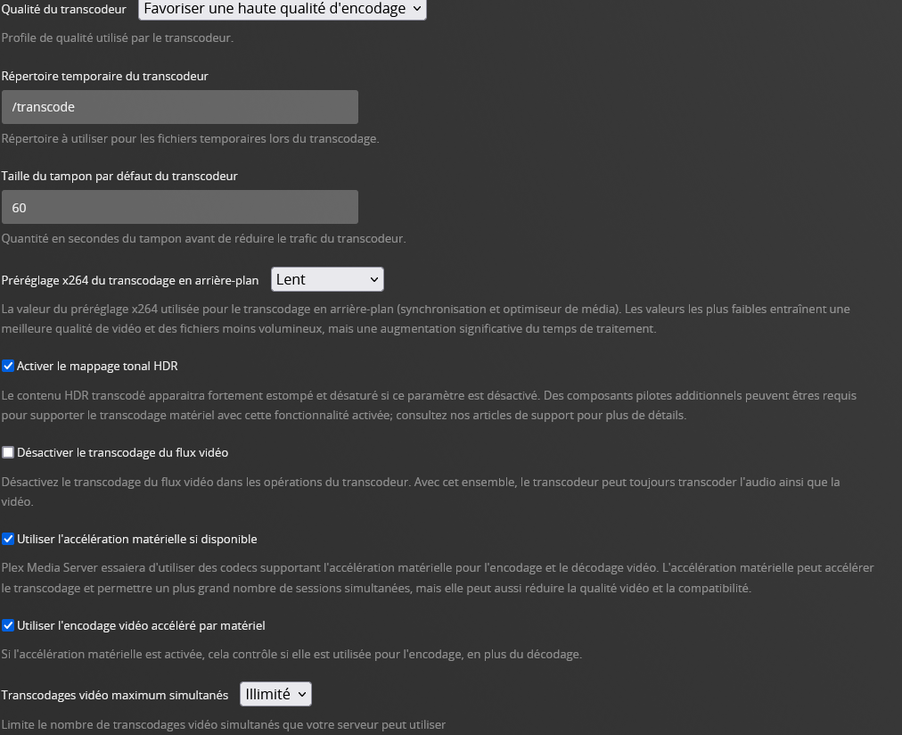

Hi!
I'm running NVIDIA Quadro p2000 since several days on my 6.10.3 unraid servor. Before my processors Bi-xeon converted movies, but I bought a graphic card and the plex pass. I wanted to turn on hw transcoding but, it doesnt work. In original quality it works, but when I choose "prefer hardware transcoding" the convertion isnt working and it still bufferize.
I used your drivers to get my gc recognized and it works. But even if I followed your setup instructions, it isnt working. Any idee ?
Thanks a lot.
PS : I can see "Critical: libusb_init failed" in log from plex. If it helps

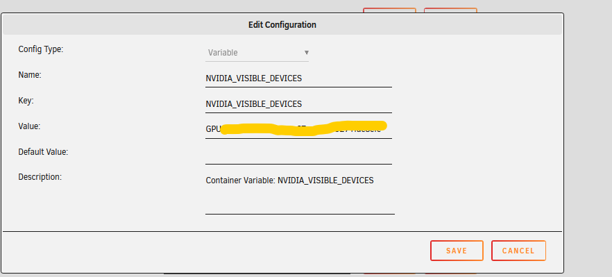

Why are the NVIDIA_VISIBLE_DEVICES and the NVIDIA_DRIVER_CAPABILITIES twice in there?

Here there is the way that I put entries :plex2.png.25a51571c4ce168c1b91b880b7325a6f.png
That why there is double Container Variable: NVIDIA_VISIBLE_DEVICES. I put it myself in description field.
Then there is my diagnostics, sorry for being late.tower-diagnostics-20220922-2146.zip
Thanks again sir

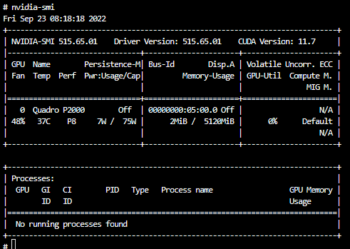

What happens when you issue:
nvidia-smi
from within the Console from the container?
Your card seems to work just fine and the drivers are loaded correctly from what I see from your Diagnostics.
nvidia-smi

21 minutes ago, canapelit said:
from the plex terminal? There is
If this is the Plex terminal everything seems fine.
Please try the following:
  1. Delete the Plex container
  2. Create a new claim
  3. Go to your Docker page and click on Add Container at the bottom
  4. From the drop down select your Plex template (with this you ensure that the paths and everything is like before)
  5. Paste the new claim in your Plex template
  6. Click Apply
  7. Try to force a transcode
BTW are you sure that you are forcing a transcode and this is not only the Audio (or the Subtitles) which get transcoded on the CPU?
If the above isn't working I would recommend that you go to the Plex support thread and post there since this seems like a Plex issue (also post the Plex transcoding log).

Lets go, I did this to-do list. AND IT WORKS.
Thanks a lot even if we didnt know where was the problem. Have a good day!

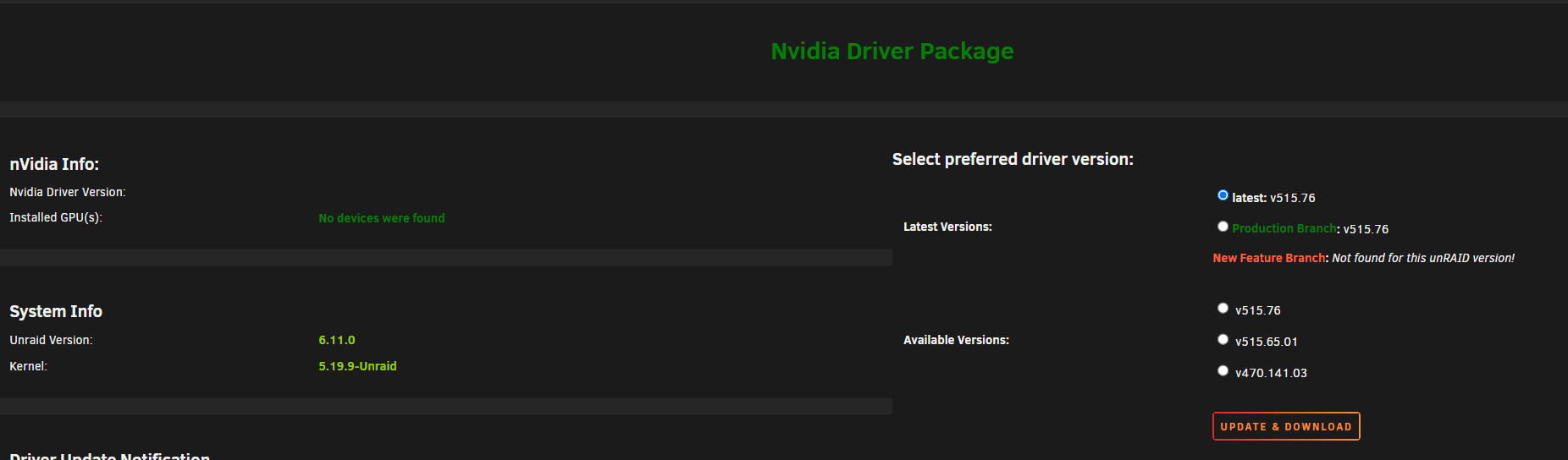

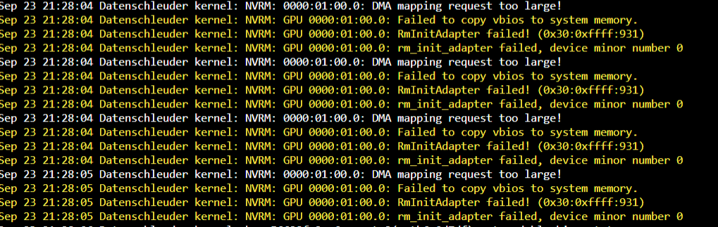

after the Update to 6.11, Unraid cant find my GPU:
Until the update was executed, the GPU was still working diligently in Tdarr. Does anyone have an idea what the problem could be or is the diagnostics still needed?

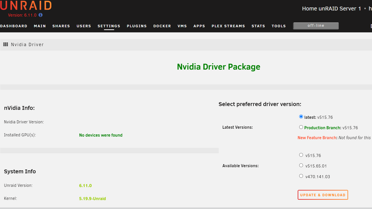

Same issue for me and a friend.  I upgraded from 6.11-rc5 to 6.11 final, and GPU can't be find now.
same problem after the Update to 6.11, Unraid cant find my GPU. Have uninstalled addon reboot, installed the app rebooted, installed v470.141.03 rebooted. And still no gpu found.
The Diagnostics are always needed because otherwise I can't tell anything what's going on.

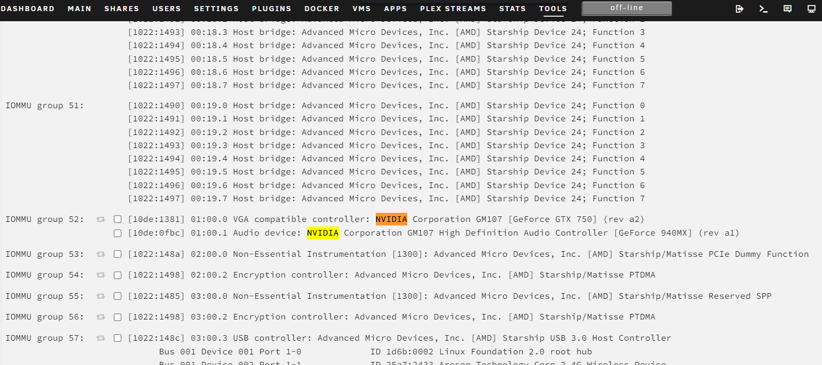

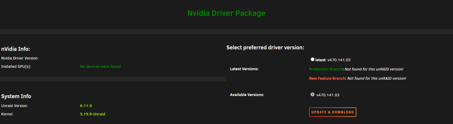

OK, so I've just started having a problem with unraid 6.10.0 and 6.11.0 with the nVidia driver.  After successfully configuring and using a GTX 750 for Plex transcoding and using it for many months, today for some reason, the Settings -> nVidia Driver shows "No devices Found"
Checking System Devices, I can see that the card is listed and NOT bound to VFIO.
I've tested the card in another system and it works fine.  I've tried using an nVidia Quadro M4000 to test, and that isn't seen via the driver either (it too, showed up fine in System Devices as unbound to VFIO).  I've uninstalled the nVidia driver, rebooted, reinstalled the nVidia driver, rebooted and checked with no success.  I've tried all available versions of the nVidia driver.
I've attached my diagnostics- any help appreciated!
Diagnostics?
You have to use driver version 470.x
