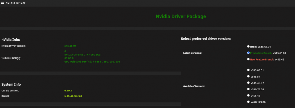

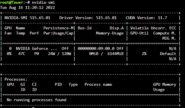

So I appear to be having this issue.
Fresh install though so never worked before.
Just uninstalled Nerd Pack and rebooted
Getting
docker: Error response from daemon: failed to create shim: OCI runtime create failed: container_linux.go:380: starting container process caused: process_linux.go:545: container init caused: Running hook #1:: error running hook: exit status 1, stdout: , stderr: Auto-detected mode as 'legacy'
nvidia-container-cli: device error: false: unknown device: unknown.
I'm Sure I'm missing something.
Done the usual reboot/reinstall etc etc. (initially I was having VIFO problems, system used to pass it through now it doesn't)
Driver gets the below and appears to be A ok

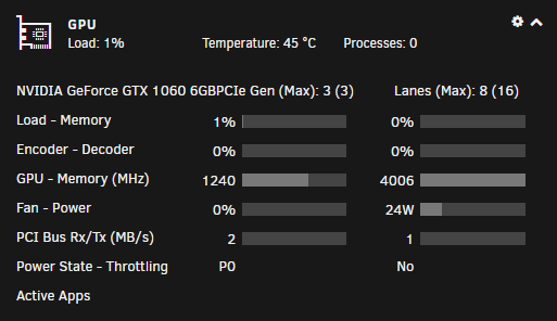

GPU stats is getting pulled correctly too
I'm like 99% sure I'm missing something dumb. what logs would you need?
Edit: Also confirmed these are ok too.
Edited by BomB191
more info
A user already had the same issue and I was able to reproduce this on my test server while up- and downgrading Unraid version.
I was able to solve it here:
Please also look at the following post since the user had many packages installed from the NerdPack and in his case it seems to be that this caused the issue.
...please report back if you got it working again.

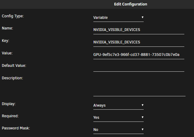

NVIDIA_VISIBLE_DEVICES I think is where my issue might be
I'm copying the information from
Confirmed no spaces, Tried re copy pasting
Correct "GPU-9ef5c7e3-966f-cd37-8881-73507c0b7e0a"

35 minutes ago, BomB191 said:
nvidia-persistenced in the cmd line is accepted but no change.
Do you have nvidia-persistenced enabled? If yes, please disable it with:
kill $(pidof nvidia-persistenced)
and try it again after you've disabled it.
Do you have all the variables in the Docker template as described in the second post of this thread?
After running 'kill $(pidof nvidia-persistenced)'
I get the same error
Can also confirm both required variables are in the docker
Key : NVIDIA_VISIBLE_DEVICES
Value : GPU-9ef5c7e3-966f-cd37-8881-73507c0b7e0a
Key NVIDIA_DRIVER_CAPABILITIES
Value : all
This is in the unmanic container. I assume I'm not at the point of the container itself having issues with it yet.
I am on Version: 6.10.3 should I hop onto the 6.11.0-rc3?
No, have you yet tried to change a value in the container and to basically recreate it on your server and see if this fixes your issue?
Can you maybe post your Diagnostics?
I require a dunce hat for tonight.
Went to make a new container and notice these 2 prams hiding under more settings.
Figures it would be something extremally stupid. I didn't even contemplate checking in there.
The disappointment in myself is unmeasurable.
TIL check 'Show more settings ...' :( Sorry for wasting your time. and thank you immensely for the assistance
No worries, so it is now working or am I wrong?
yes confirmed now working!
Thank you very much 💖
What did you do exactly?
Did you remove the entry with ‘all‘ or did you remove your UUID?

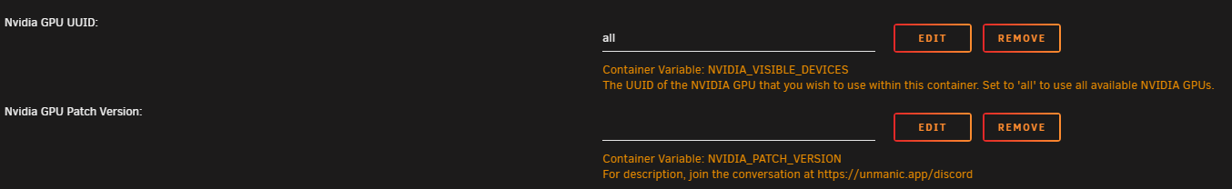

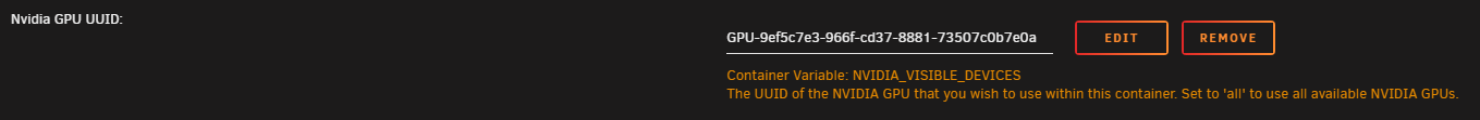

Yes when I went to create a fresh container i noticed it under 'show more settings'
so on my container i had 2x NVIDIA_VISIBLE_DEVICES one with my GPU and one with 'all' in the field.
I deleted the variable I created and used the one in the container already and renamed it to my gpu
So the container now has the below in the settings regarding the GPU
