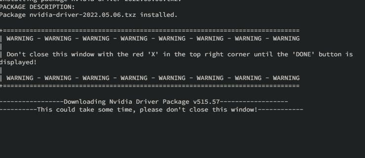

So,
I know not to click the red x however, I have left it for over 1 Hr and it was just sat on the same screen with no done button....
When the done button isn't displayed the driver download isn't finished and it can't work.
GitHub gave me some trouble recently with download speeds and a ~200MB driver a download speed of about 15KB/s can take a while.
Can you try to to download this file only to see which speeds do you get (you don't need this file, this is only how fast the download is for you)? Currently I'm getting about 18MB/s down from GitHub.
Please follow the procedure described above, remove the driver, reboot and try to install it again from the CA App, I hope that it doesn't take this long to download this time.

Hi Ich777,
So its been over an hour and still stuck on do not close this screen, I have performed some network tests and all is ok, I have no problem installing other apps and 'done' appearing. What I have noticed though is that when I start a clean install of the nvidia driver it starts downloading at 3MB/s for approx 5 seconds and then the download stops. I tried downloading that file you sent me and it downloads at a steady 2.3MB/s.
I just can't seem to pull the driver from github. I use pfsense but its pretty much a vanilla install and as said there is no problem installing other apps.
John
Then download the file that I've linked above on your computer and put it in the folder '/boot/config/plugins/nvidia-driver/packages/5.15.46/' on your server, after that reboot and the driver should be installed.
Have you maybe done anything custom to Unraid, custom DNS servers...? Any AdBlocking software on your network or something like that?
Where are you located in the world?
Maybe try it in a few hours, I really can't help since this is a download issue from GitHub. I've had such an issue with German users where it downloads the files with a few KB/s and the download took forever.
What kind of USB Boot device do you have? Do you have enough free space on there?
