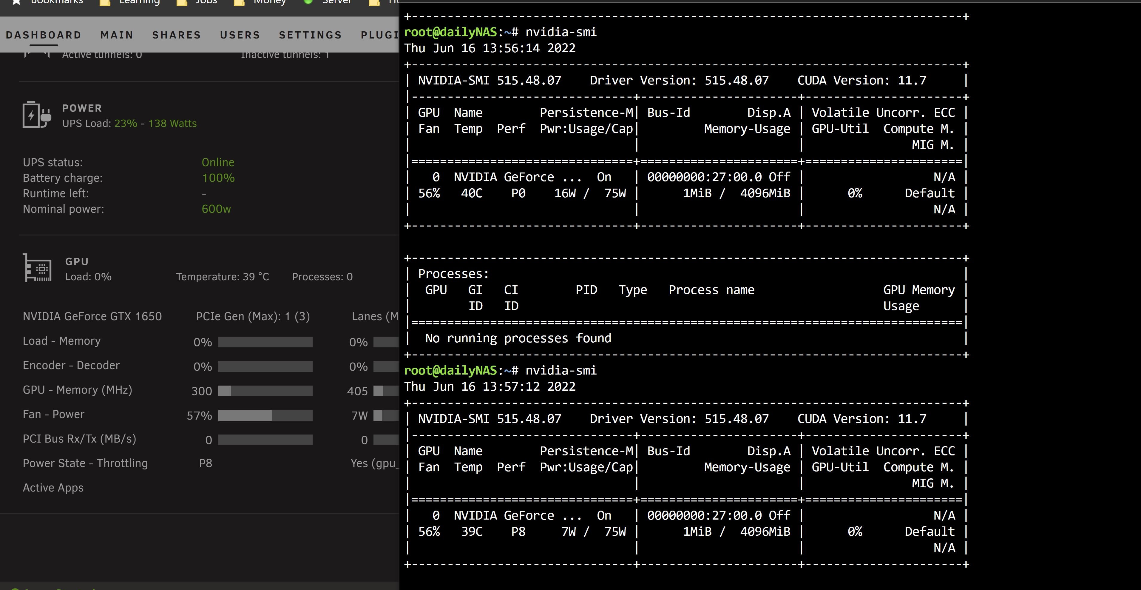

I think I spoke too soon....
I noticed today that the issue has come back. Again, plex was working fine and used the GPU for transcoding. I only noticed the issue because another docker container that was to use the GPU failed to compile / run.
In the attached setup, I have "nvidia-persistenced" in the go file and no custom scripts running.
Here is the diagnostics file.
dailynas-diagnostics-20220616-1206.zip
Edited by raf802
extra info.

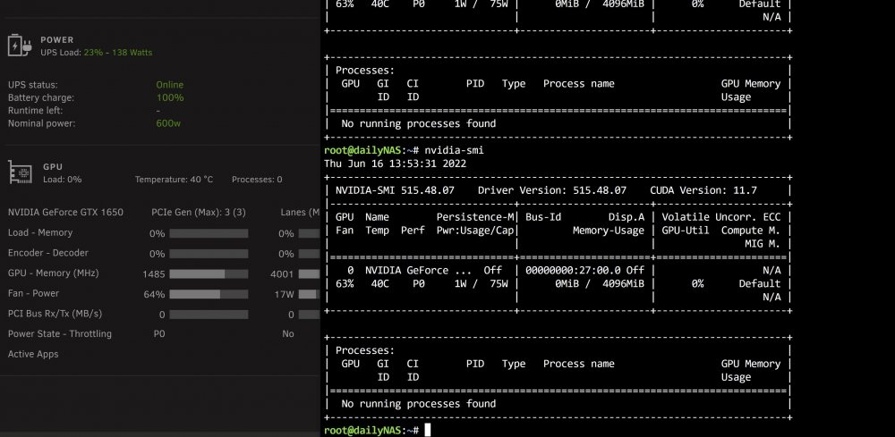

As a "start from scratch" approach. I removed the
nvidia-persistenced
command from the go file.
The docker containers all start up correctly with the GPU. Of course, they are in powestate P0, and I am trying to save power.
Do you mind elaborating on the following code?
nvidia-persistenced
sleep 5
kill $(pidof nvidia-persistenced)
Would this also put the container GPU into the P8 powerstate? Can it also go into P0 when needed and back to P8?
Some observations I have noticed with power save off (no commands run):
  • GPU is in P0 state. Both nvidia-smi & GPU statistics plugin state the same.
  • nvidia-smi states power usage of 1W, GPU statistics reports 17W.
Is this discrepancy normal? Could nvidia-smi be reporting the incorrect power usage for P0, and hence P8 is <1W and causes an error?
For reference, when in P8, the GPU uses 7W according to GPU statistics.
When I run the nvidia-persistenced command from the cli, the nvidia-smi power usage reports correctly for P0 and then reports the correct P8 state too.
Edited by raf802
This will ultimately start nvidia-persistenced, wait and then end nvidia-persistenced
You have to try this, the card should be go back to P8 again after a transcode is finished.
I would first of all recommend that you use the command:
watch nvidia-smi
this will keep nvidia-smi on top and update it every 2 seconds, you can stop it by pressing CTRL + C
I really can't tell what's going on on your system but this is completely out of my control since this is caused by nvidia-smi and how it outputs everything.

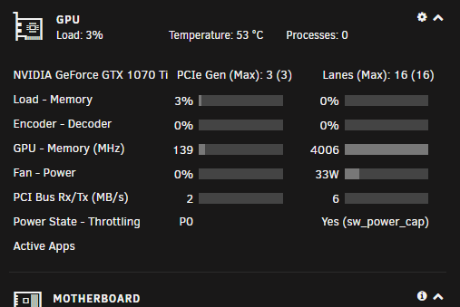

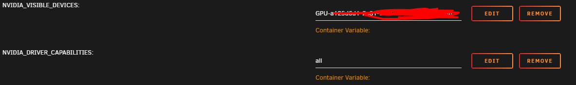

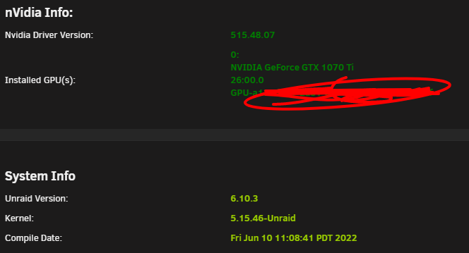

Hey hey! Been trying for hours (lol) to get my PLEX HW transcoding to run, can't find my error.
UnRaid 6.10.3
3600X
1070 Ti
Nvidia driver + GPU statistics installed
IOMMU group VGA hook is unchecked
Got Plex Pass
Tried different movies/codecs
--runtime=nvidia is in
GPUID has no spaces > i set it to _all_ now
Used HW encoding in Plex
linuxserver/plex:latest
no VMs installed
Please help and thanks to this awesome community!  :)
On the first two pages some users reported that deleting and reinstalling the container solved the issue.
Have you also added your Plex token to the container?
From my perspective it can only be a Plex issue and this question would be better suited in the Support Thread from the Docker container itself.
You can also try Jellyfin if you want to since it's free and you can try if transcoding is working there...
I reinstalled it yesterday many times before, but today is another day and it works now fine! unfortunately I do not know now what it failed, too bad! thank you!
UnRaid 6.10.3
3600X
1070 Ti
Got Plex Pass
no VMs installed
I am having the same issue as you, its driving me crazy!!
